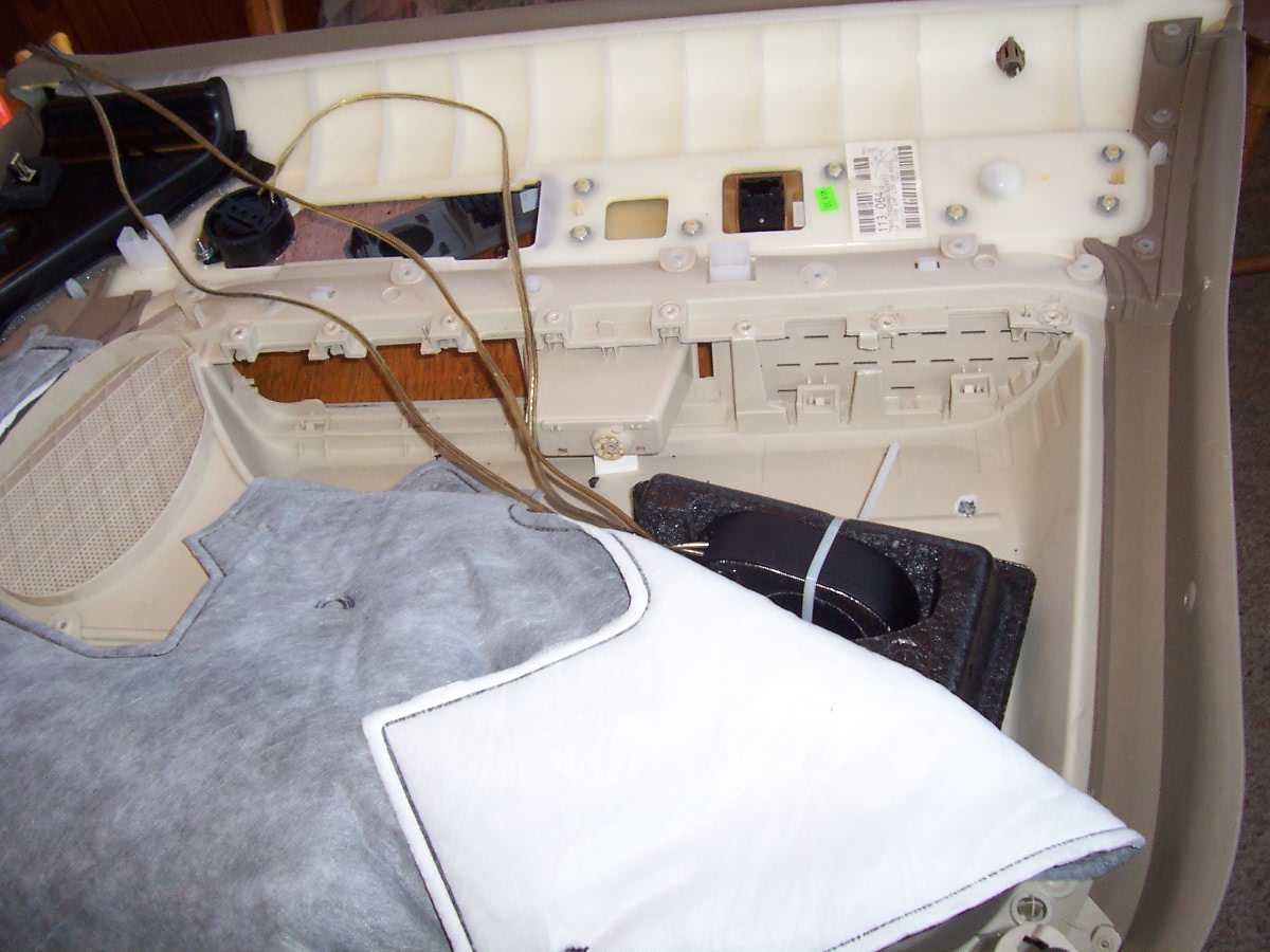

kempie Posted January 1, 2010 Report Share Posted January 1, 2010 Well I got the speakers changed today. There is a noticeable difference in the sound. I like it! The tweeters were a PIA to mount as there is not much room to fit them in. I had to clip off the mounting studs for the OEM speakers and drill a hole for a bolt and put a screw in the other bracket mounting hole. There is a great place for the crossover in the door. I cut out some of the stratiform so the fit was not too tight and there was room for the wires to exit. All in all, not too hard. Just wish it had been warmer that 30 deg. Quote Link to comment Share on other sites More sharing options...
klc317 Posted January 2, 2010 Author Report Share Posted January 2, 2010 (edited) Well I got the speakers changed today. There is a noticeable difference in the sound. I like it! The tweeters were a PIA to mount as there is not much room to fit them in. I had to clip off the mounting studs for the OEM speakers and drill a hole for a bolt and put a screw in the other bracket mounting hole. There is a great place for the crossover in the door. I cut out some of the stratiform so the fit was not too tight and there was room for the wires to exit. All in all, not too hard. Just wish it had been warmer that 30 deg. Great! I haven't got mine yet but I'm glad to see your install turned out well. They are supposed to be here early next week. If you have any more pics they would be appreciated but I think I see what I need to do based on the couple that you posted. Thanks! I'm not really concerned about clipping off the factory tweeter holders since I doubt if I would ever put them back in. Nice "DIY" job on the aftermarket tweeters! Did you happen to put in any Dynamat or anything? I am glad to hear that you are happy with the improvement in sound. Anything would be better than the puny factory 6x8s that look identical to the ones in all Ford vehicles I have owned since the '80s models. I've been busy with the PXAMG/Sirius/Ipod control through the factory radio thing today so I've had plenty to deal with as it is. Our MKX came with the regular radio (non-nav) and without Sirius so I had to solve that. Very happy with how it turned out. Its about 45-50 degrees in the garage, 15 or so outside so the hours I spent weren't too uncomfy...haha. Edited January 2, 2010 by klc317 Quote Link to comment Share on other sites More sharing options...
kempie Posted January 2, 2010 Report Share Posted January 2, 2010 (edited) Those were the only pics I took because the rest of the job is not hard at all. Just uncapping (behind the door pull and the handle) unscrewing (all around the door panel) and popping a couple of clips. Best to remove the silver covers and electrical plugs for the window & lock buttons before removing the door panels. Keep the tweeter/lock panel near because you will need it to place the new tweeter in a position that will clear the panel clip & lock button. There is not much room for error. Replace the door panel after tweeter & crossover mounting and then replace the covers for the tweeter & door switches. I used the male/female bullet type plugs for the connections (lubed w/dielectric grease) between the door panel(crossover & speaker) and the door connections. I dont know if this is the best way to do the install but it works for me. Let me know if you have any questions. Later, Bill Edit: No dynamat or foam speaker thingies....... Edited January 2, 2010 by kempie Quote Link to comment Share on other sites More sharing options...
