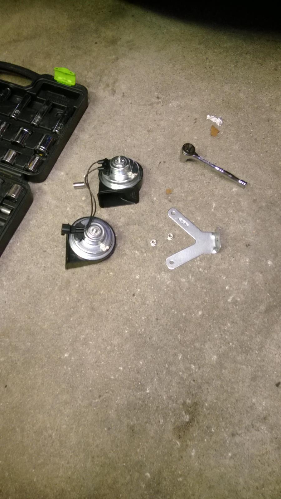

Edged Up Posted November 24, 2013 Report Share Posted November 24, 2013 Go to ebay and search "Cadillac 4 note horn". They are all over. That's the one you want as these horns came on a multitude of Caddys. Don't know any specific model or part #. They'll be on ebay though. Make sure the seller is including the plugs with wires to go with them. I also checked to see what they were rated at. Looked at the fuse box diagram for a Dorado online and found the fuse for the horns is 15 amps. Edge has a 20 amp horn fuse so its perfect! No relay needed. OEM wires should handle it. Mines been on for a few weeks and all good. 1 Quote Link to comment Share on other sites More sharing options...
Edged Up Posted November 24, 2013 Report Share Posted November 24, 2013 Also 2 wire. Make sure its 2 wire horns. One wire one are the same thing but a little easier to hook up electrically. Or same shit. FOR ME the 2 wire ones were easier. Quote Link to comment Share on other sites More sharing options...

Edged Up Posted November 25, 2013 Report Share Posted November 25, 2013 No. The stock bracket has two spots for horns. I picked up some steel with holes in it @ home depot. Then attached the horns to that strip of steel and attached the whole thing to the OEM bracket. Then put back in OEM location. Pretty cut and dry. Just be prepared to do a lot of trial and error getting the horns in the right positions so they don't interfere with the wiper fluid bottle. Didn't take too long. Like 20 mins of putting it in and taking it out and repositioning the horns. No biggie. I will be moving them to behind the grill tho in the future. Prolly sound better up front like that too. When it warms up outside cuz its friggin cold. I used a 9006 light bulb plug to mate them together. Cut the Ford horn connector and soldered in a female 9006 plug. Connected all the wires on the horn side and soldered in a male 9006 plug. Heatshrink tubed for looks. Quote Link to comment Share on other sites More sharing options...
