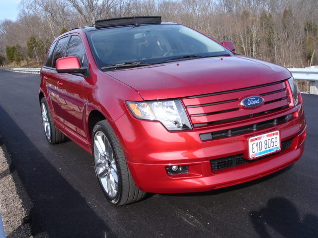

One of the things I wanted to change on my Edge Sport was the chrome grille, there is no other chrome on the vehicle so I was checking for any kind of grille option and found that Ford sells what they call "painted grille inserts" I was not sure what the "inserts" would be but I ordered it anyway. When the part arrived I was happy to see that this is a factory painted Ford grille. They sell them in the Sport model colors (black, silver, blue & red) and also unpainted "paint to match" The grille came with instructions but was not a simple job (anyone that has changed there Edge grille knows what I mean)

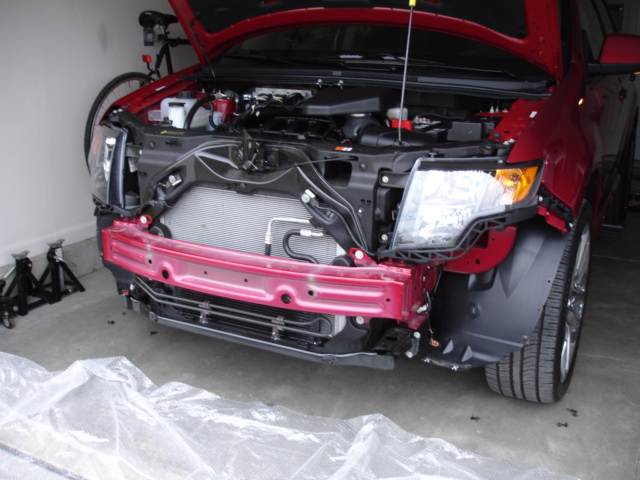

The front bumper cover has to be removed for access to the grille bolts and tabs that snap into the bumper cover and grille frame. The hardest part was getting the old grille off of the grille frame and the bumper cover. It ended up taking me a couple of hours but once I was done I was very happy.

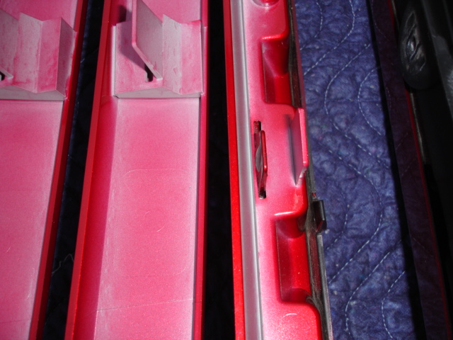

There was one problem I ran into with the new painted grille, it had long tabs on the back that had to be removed, I didn't find out until I had the new grille snaped into the bumper cover but I was able to remove them without removing the grille from the bumper cover.

that looks great! better than I had expected. I wonder what black would look like on my white Edge :)
