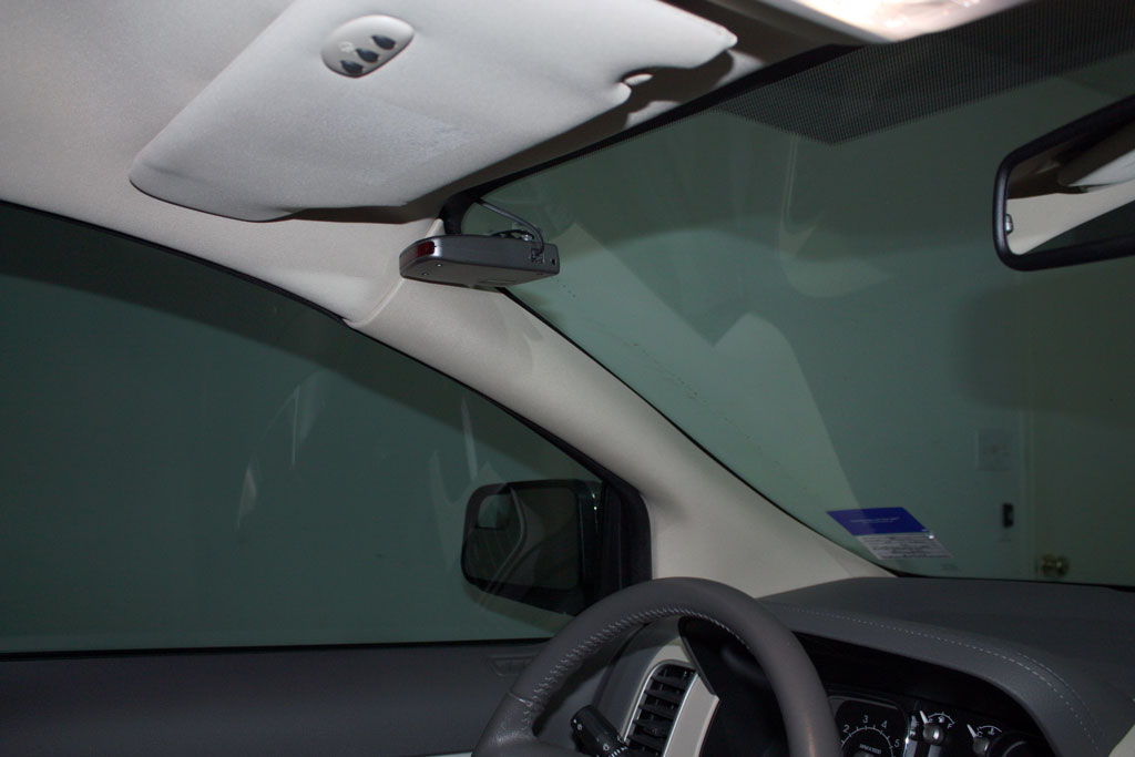

klc317 Posted November 26, 2009 Report Share Posted November 26, 2009 In my search to find a convenient and somewhat decent looking way to mount my Escort detector in our MKX I came up with this. Found some grey phone line laying around that matched the interior and is basicly the same as the power cord for an Escort detector, tested 12V routing in the phone line to find a combination of wires that would power the detector, added a mini-fuse "add-a-circuit" + a 1A fuse to an unused iginition switched 12V source in the fuse panel and tucked everything away. Just need to hide the wire a bit more but it does look fairly good and easy to remove when we don't need it in the car. Too bad the connection on the detector isn't on the other side. Thought this might be helpful to any of you who would like to try it this way. Quote Link to comment Share on other sites More sharing options...

klc317 Posted December 1, 2009 Author Report Share Posted December 1, 2009 Redid it. Ran the phone cable (hidden) up behind the A-pillar, front headliner and through the sun-visor opening where it screws into the roof. Picked up a visor clip for it today too. No wire at all can be seen now and is much easier to reach. Quote Link to comment Share on other sites More sharing options...
