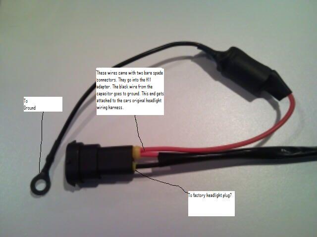

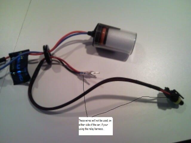

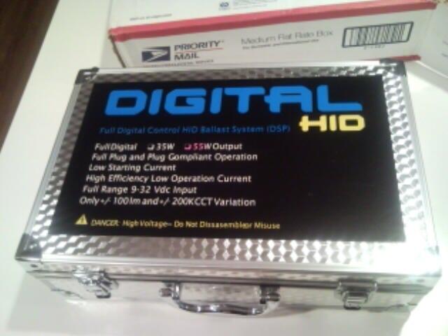

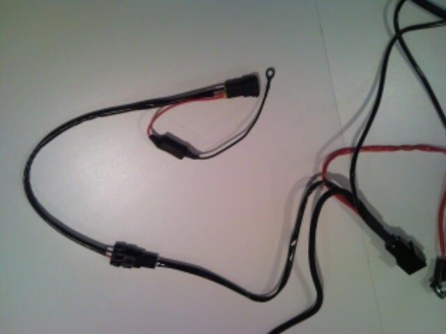

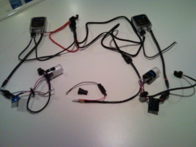

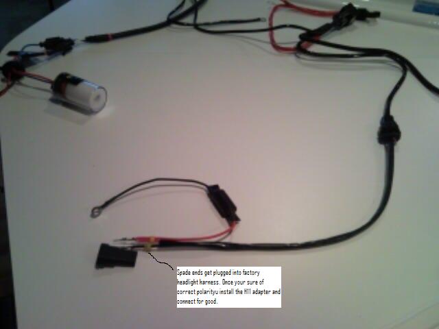

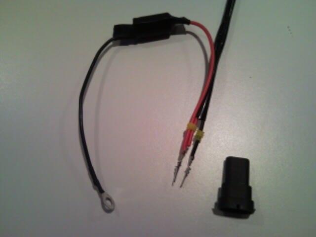

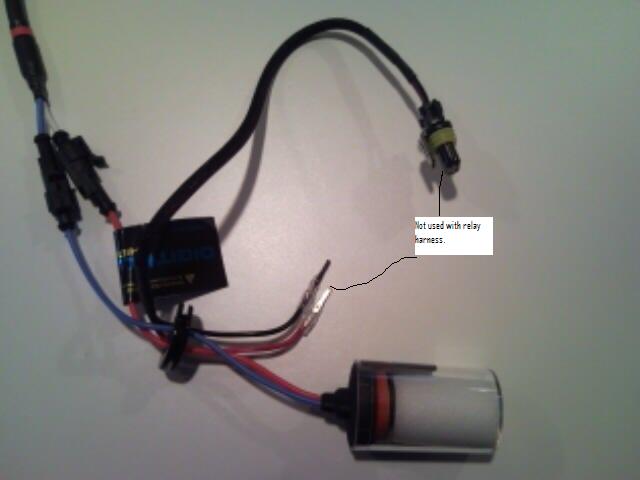

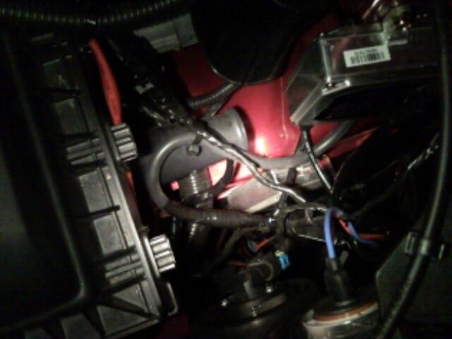

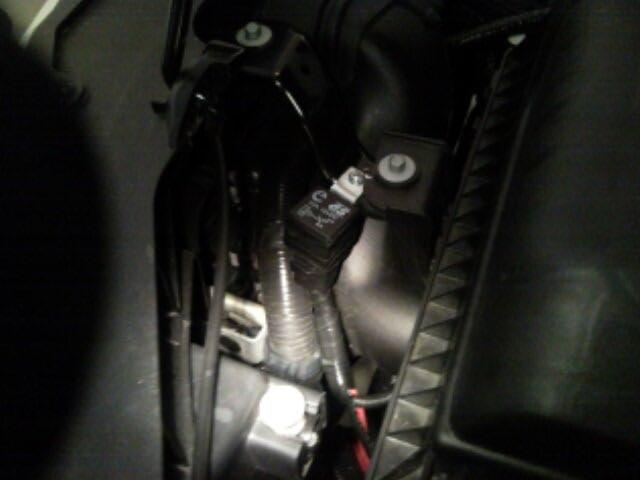

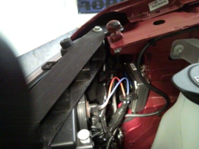

I received my kit from Retro-Solutions. It's a 55w, 8000K, H11 for my wife's 2009 Edge Limited. The kit came with the relay harness, which I am going to install. Here are a few pics of the kit/harness and an explanation of where they connect. The installation manual was not clear about the capacitor connections. I e-mailed Todd Strong, he got back to me in a couple of minutes and verified that I had everything correct. Great customer service.

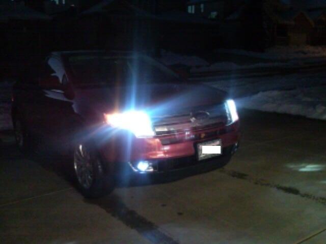

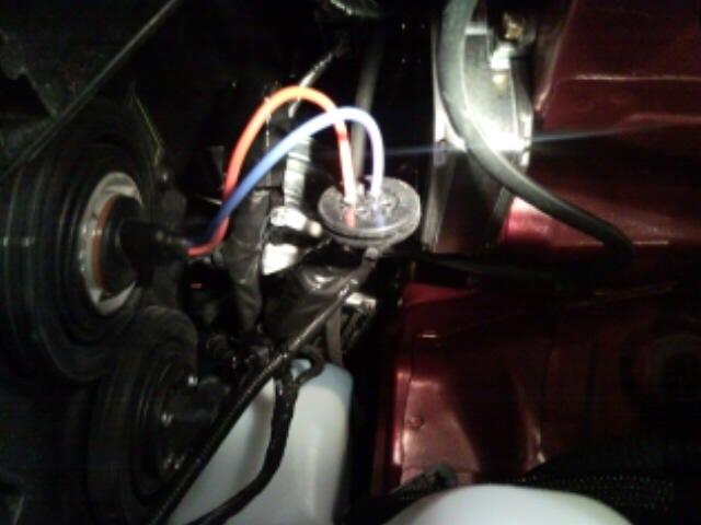

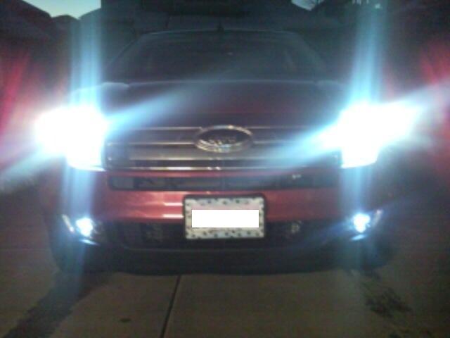

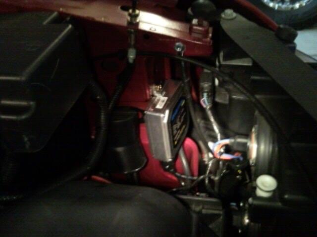

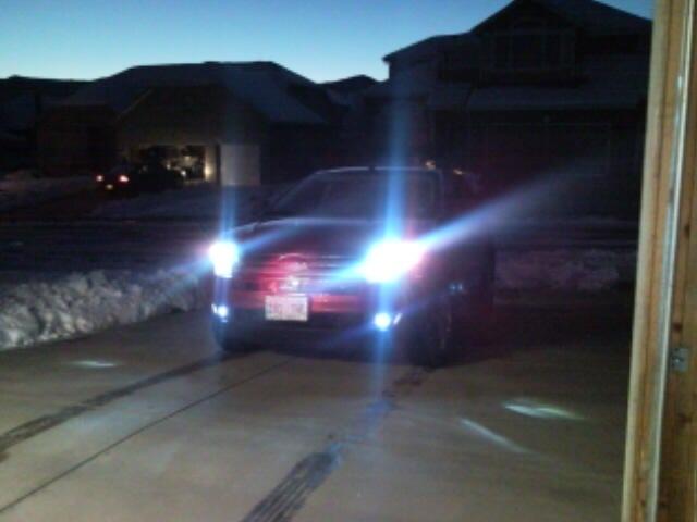

The install took me about two and a half hours. It took me so long because I had a set of 35w 8000 HIDS in the lows from Euro Effects. That set did not have a relay harness and sometimes the passenger light would not come on. I moved that set to the fogs since the fogs don't run on a pulsed system and I won't have the light out issue. I had to remove the lower valance and the inner wheel wells to access the fogs and place the ballasts. That was a PITA, lying on the floor and trying to screw in the ballasts. I felt like a contortionist. I did get them secured in a good location though. That set is closer to the ground so I took my time and taped all connections to help with making them water "resistant". I put the Retro Solutions with relay in the lows. I'm kind of anal so I took my time running the wires, making the connections and securing everything with zip ties and electrical tape. The install was smooth with no problems. The lights lit up like they were supposed to. My wife drives the Edge so I will take some pics of the engine bay and them some pics of the lows and fogs when she gets home from work and it gets dark. The Euro Effects seem a little bluer than the 8000 Retros. Night time will give me a little better view though. The Edge has all red LEDS in the interior lights and the puddles so I put two red LEDS in the glove box, since the Edge didn't come with any sort of glove box illumination. I used a pin switch from NAPA and spliced into the hot and ground from the auxillary plug in the dash. The rear of the glove box has little round textured circles from the injection molding so I used these to perfectly space the LEDS. I used quick disconnects in both the hot and ground so I can remove the glove box when I have to change the cabin air filter. I also put a 10amp fuse in the line, just in case. I will also include a pic of the glove box. Pics are coming soon...

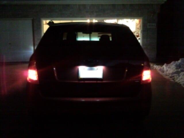

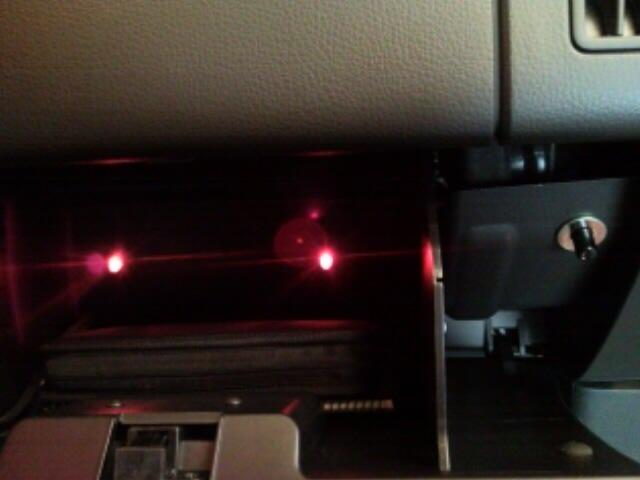

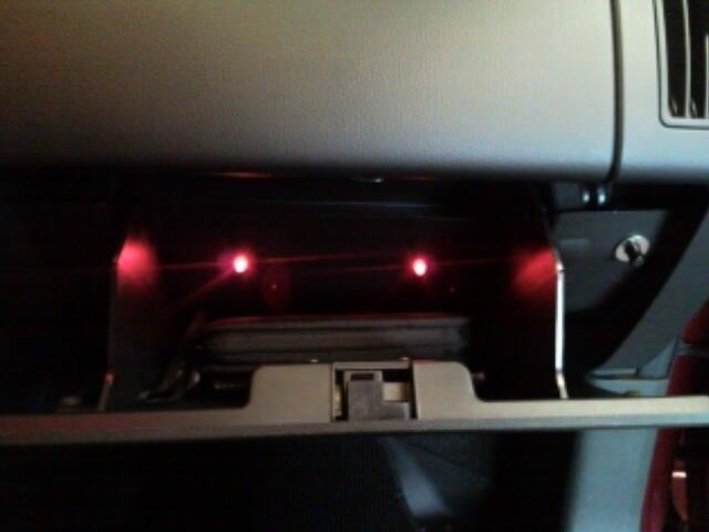

Here are the pics. Sorry about quality but all I had was my phone. I threw in a couple pics of my truck. A 2007 F150 with a 6" lift and 35X12.50 tires. Awesome in the snow/off-road. If you look close you can see two ballasts on each side, one for the fogs and one for the lows. Also in here are pics of the two LEDS in the glove box and the pin switch. You can also see how white the two LEDS are in the rear license plate light.
I have done similar. I also put pin switch system with LEDs in both the center console and the glove box - both with butt connectors for quick release if needed. nice added feature. and heck, what's to say about HID other than, there is no other way
