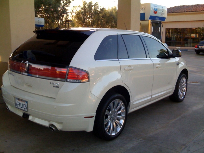

end Posted October 18, 2009 Report Share Posted October 18, 2009 Check it out... Factory Lincoln MKS 20" Polished Aluminum Rims. Word of warning, the bore size of the MKS is different than the MKX/Edge. I had to get some custom spacers fabricated just to put them on. However, the spacers I had made are hub-centric on the car-side and wheel-side so I'm really not worried much about vibrations. Quote Link to comment Share on other sites More sharing options...
MOFSTEEL Posted October 18, 2009 Report Share Posted October 18, 2009 They look great! Fit the body style perfectly. I'm guessing you got a deal on them. Quote Link to comment Share on other sites More sharing options...
end Posted October 18, 2009 Author Report Share Posted October 18, 2009 Hey thanks for the compliment. I didn't get that great of a deal, paid $950 for them for rims and tires. Then I had to get some $180 spacers made. Quote Link to comment Share on other sites More sharing options...
MOFSTEEL Posted October 18, 2009 Report Share Posted October 18, 2009 Sounds like a deal to me. The wheel and tire combos I've looked at are around 2k. Those wheels really give your car an OEM+ look. Quote Link to comment Share on other sites More sharing options...
