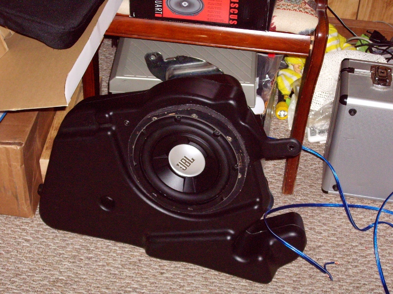

bmitchell4 Posted October 14, 2009 Author Report Share Posted October 14, 2009 (edited) The enclosure actually had a little bit of poly fill in there, but I think it was mostly to keep the wires from rattling. I checked out that JBL sub and the mount depth is a hair taller than the Kicker. The depth shouldn't be a problem, but the Kicker magnet was too wide. A piece of the enclosure pushed the sub off center of the mounting holes. I had to make a custom bezel to raise and center the sub. Plus the mounting holes weren't the same as the stock sub. I may be in trouble there too.. the kicker looks to have a smaller basket, you probably could have just took off that rubber boot from the magnet and stuck it in.. I'll see what I can do there when I get my box in.. the thread here said the stock woofer was 5 inches deep so I based it off that. I can make a bezel if needed as long as it doesn't cause the woofer to contact the trim. or worst case take a hammer to the basket or cut and patch the plastic if it's not bumped there for a reason. I'm fairly determined to make it work. as an afterthought I probably should have gone with the polk it looks smaller. I'm hopeful it will just drop in, each manufacturer seems to have a different definition of a inch. once I took out an infinity sub and tried to put in a pioneer sub of the same size and had to widen the cutout. another tip is instead of poly fill use fiberglass insulation it usually does a better job, but is messy. my woofer comes in tomorrow, maybe the basket won't be as big in real life as it is in the picture. The box is on a slow boat somewhere. Edited October 14, 2009 by bmitchell4 Quote Link to comment Share on other sites More sharing options...

bmitchell4 Posted October 15, 2009 Author Report Share Posted October 15, 2009 (edited) got my box and sub in today... yup the thing hits the bump on the side.. I just spent 3 or 4 hours making the donut counting the hour I looked for a compass to draw a circle.. I hope the woofer doesn't hit the interior trim when I put it in . I used some shelving that I had laying around and cut it with a jigsaw.. its fits great now.. looks about 5/8 inch thick.. end how thick was your donut/bezel? my advice to people looking for an easy replacement is to check the magnet structure before purchase. the holes probably won't line up, but they are sealed anyway from the back. just throw some screws in the box and go with it. also the stock wire is thin put in some thicker wire. I have so much crap to hook up.. wiring, amp, camera, maybe another amp. It's always worth it though. baum I can't imagine having 12's in there.. I was debating on moving the spare to one side and dropping in some shallow mount 10's, but I'll give the 8 a go for now with 400 rms to the small speaker. baum, want to sell those storage compartments??? i have Styrofoam there Edited October 15, 2009 by bmitchell4 Quote Link to comment Share on other sites More sharing options...

bmitchell4 Posted October 17, 2009 Author Report Share Posted October 17, 2009 pic of my box / bezel hopefully installed tomorrow.. don't blame you man, I'd hang onto the storage compartments too as they are impossible to find for a decent price. although now that I think about it I've let stereo equipment go with all my cars.. I always think I can take it out when I'm putting it in, but when it comes to it I usually let half of it go with the vehicle. Mostly because I wanted new stuff. Quote Link to comment Share on other sites More sharing options...
