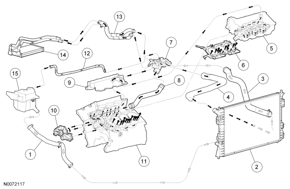

Platinum White Posted September 14, 2009 Report Share Posted September 14, 2009 What is the coolant flow path on a Ford 3.5L V6 DOHC. I have been looking at the thermostat and the hoses and am confused. Snapshot_2009_09_13_14_49_35.tiff Quote Link to comment Share on other sites More sharing options...
BlazedUp Posted September 15, 2009 Report Share Posted September 15, 2009 Water flows in the upper from the block , through the radiator and out the lower back into the block. Quote Link to comment Share on other sites More sharing options...
druck52 Posted September 15, 2009 Report Share Posted September 15, 2009 (edited) Here is a diagram of the flow path Edited September 15, 2009 by druck52 Quote Link to comment Share on other sites More sharing options...
