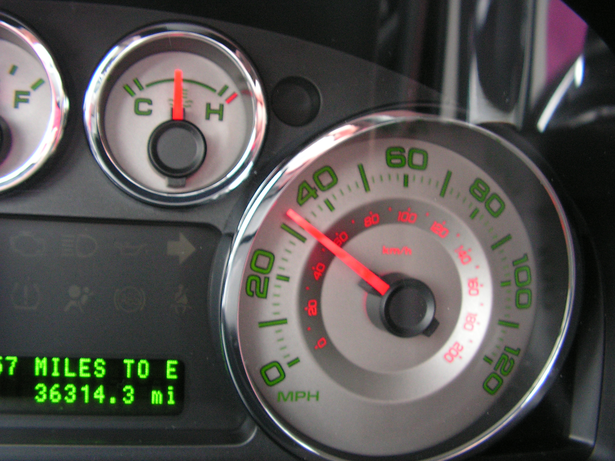

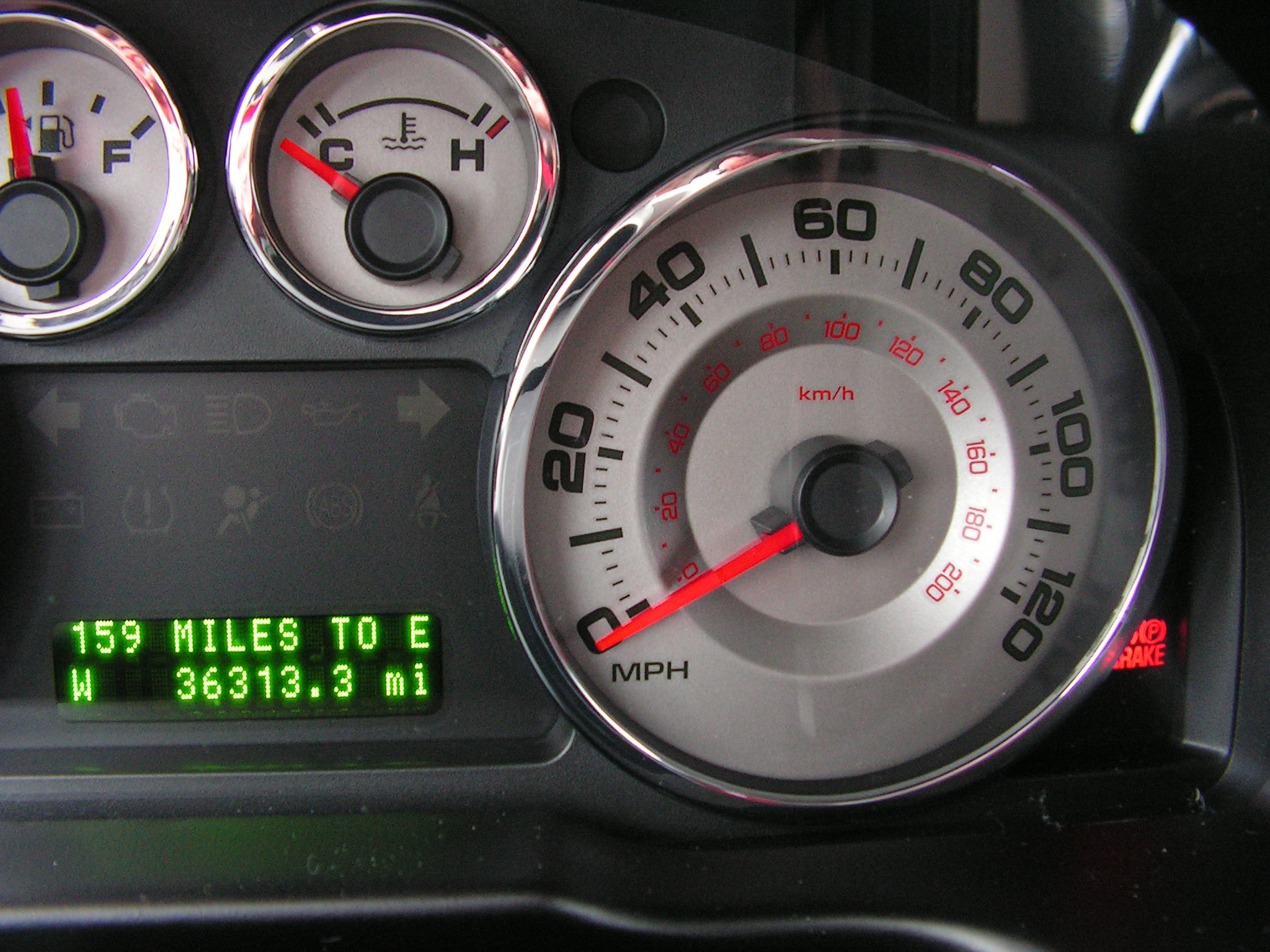

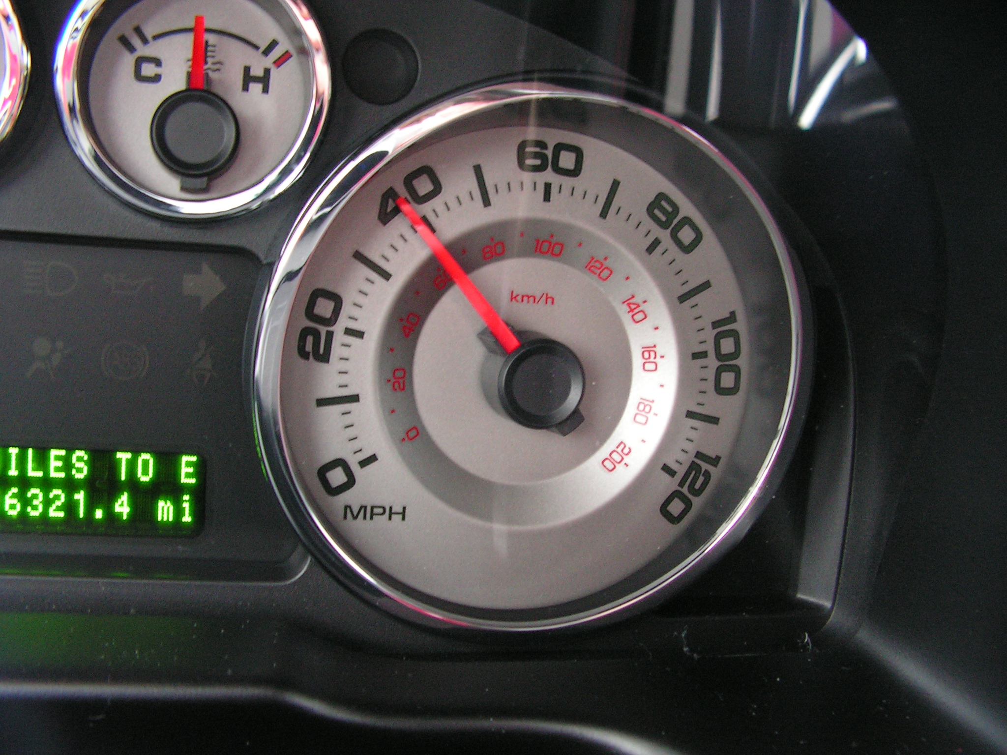

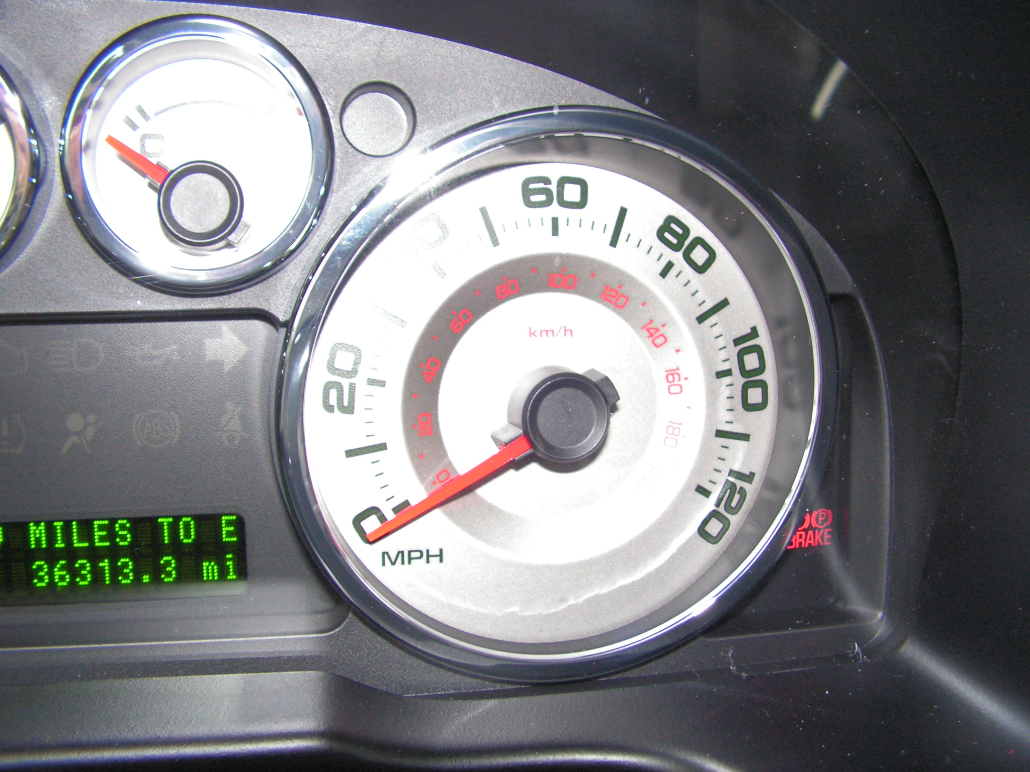

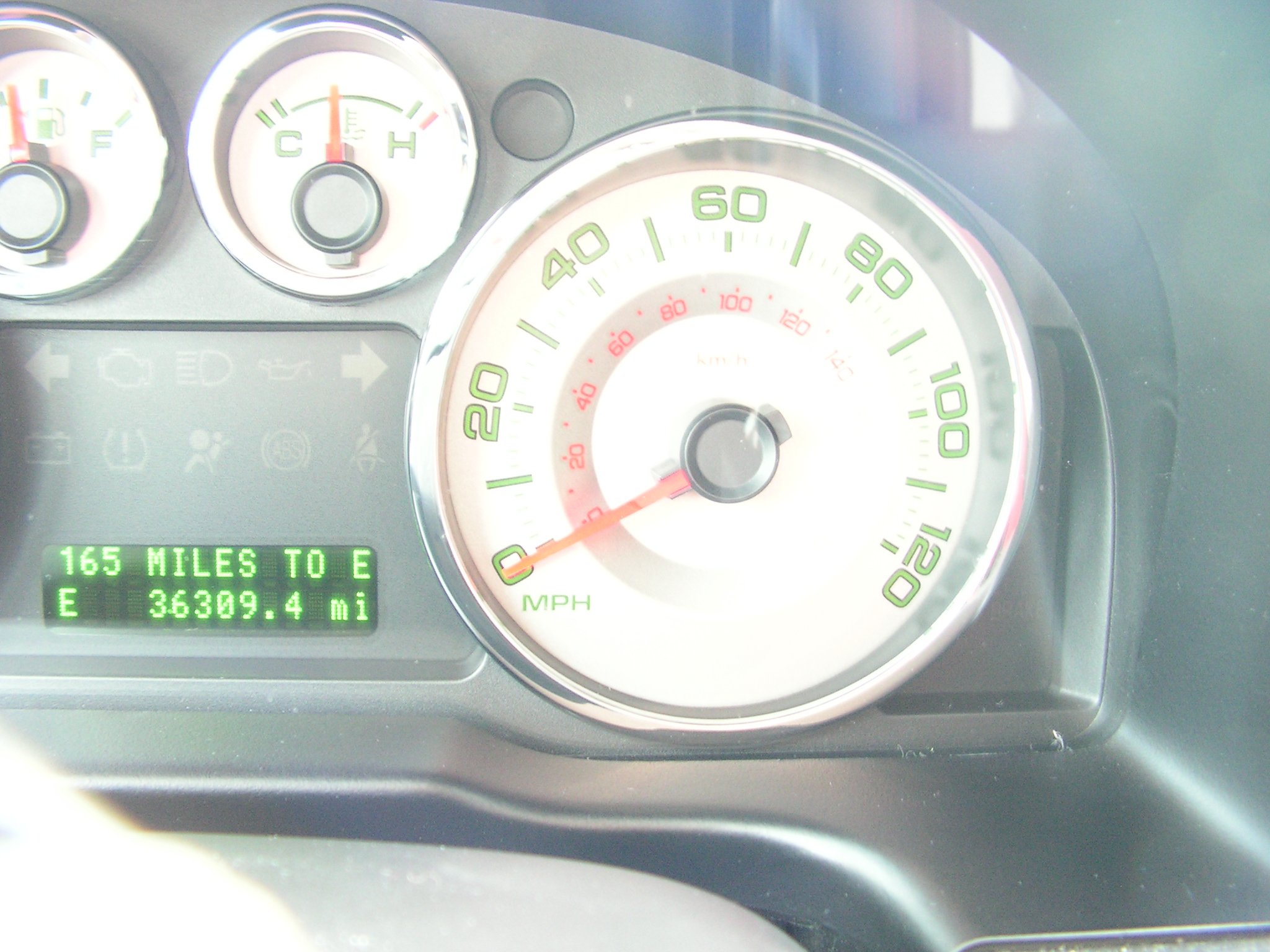

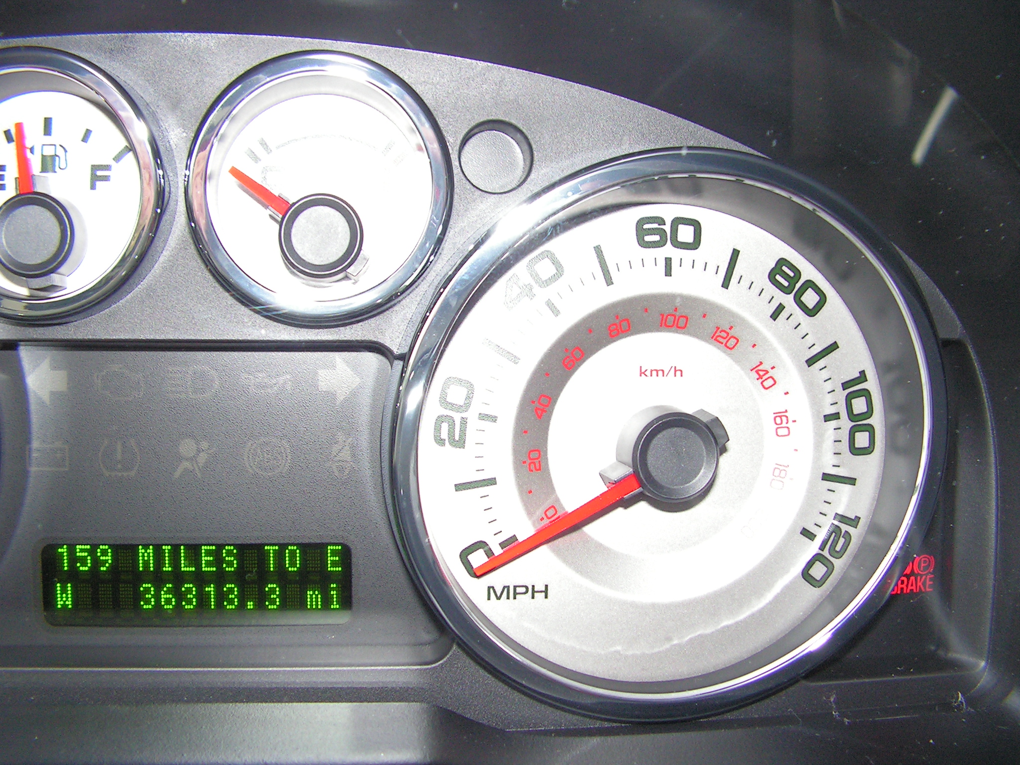

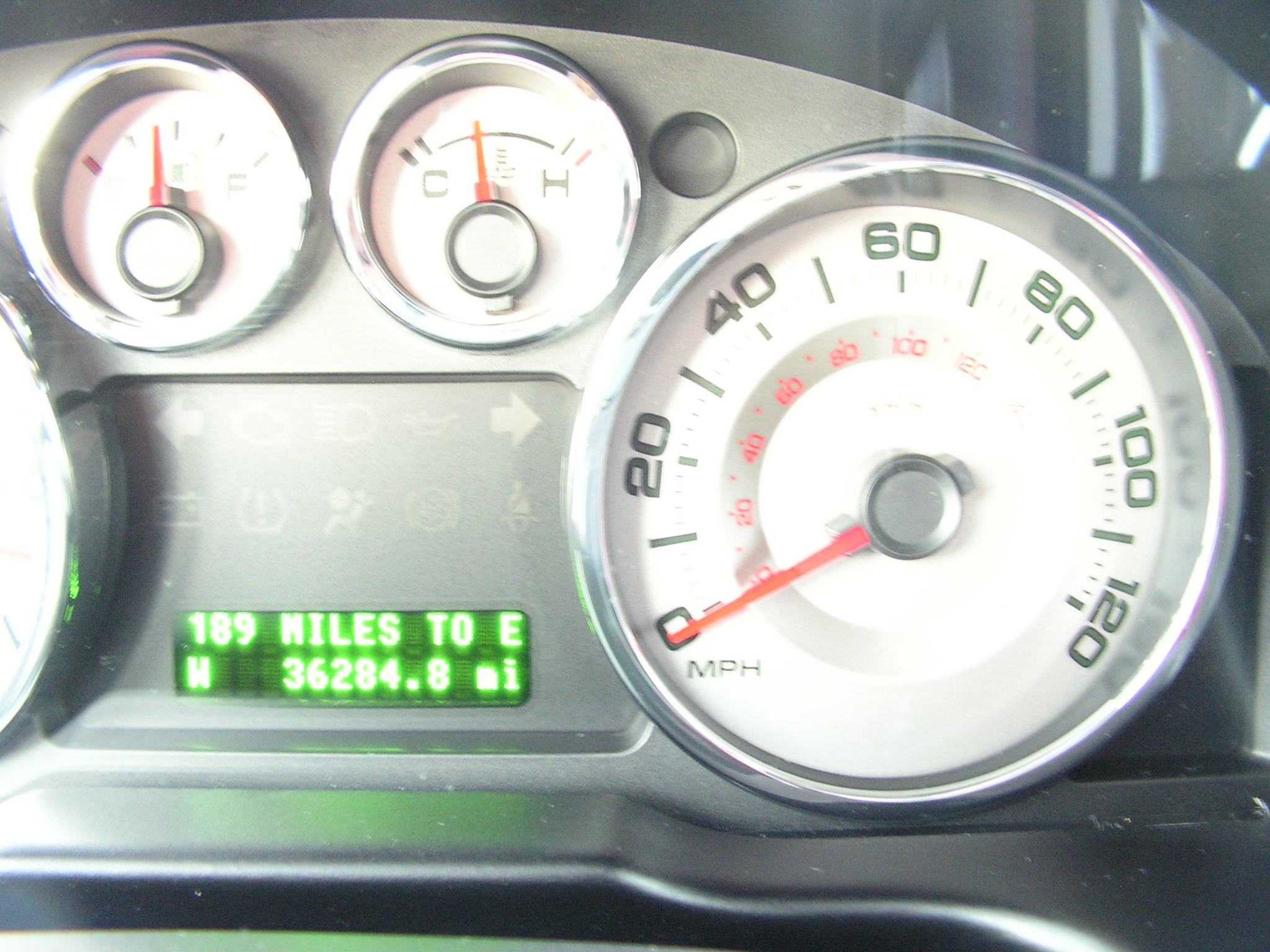

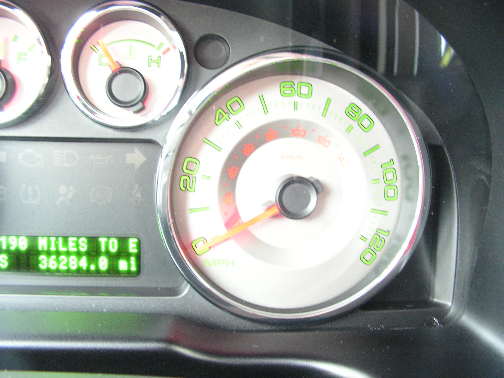

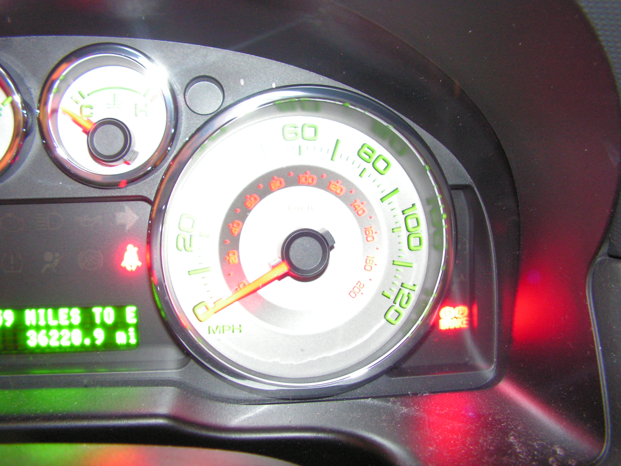

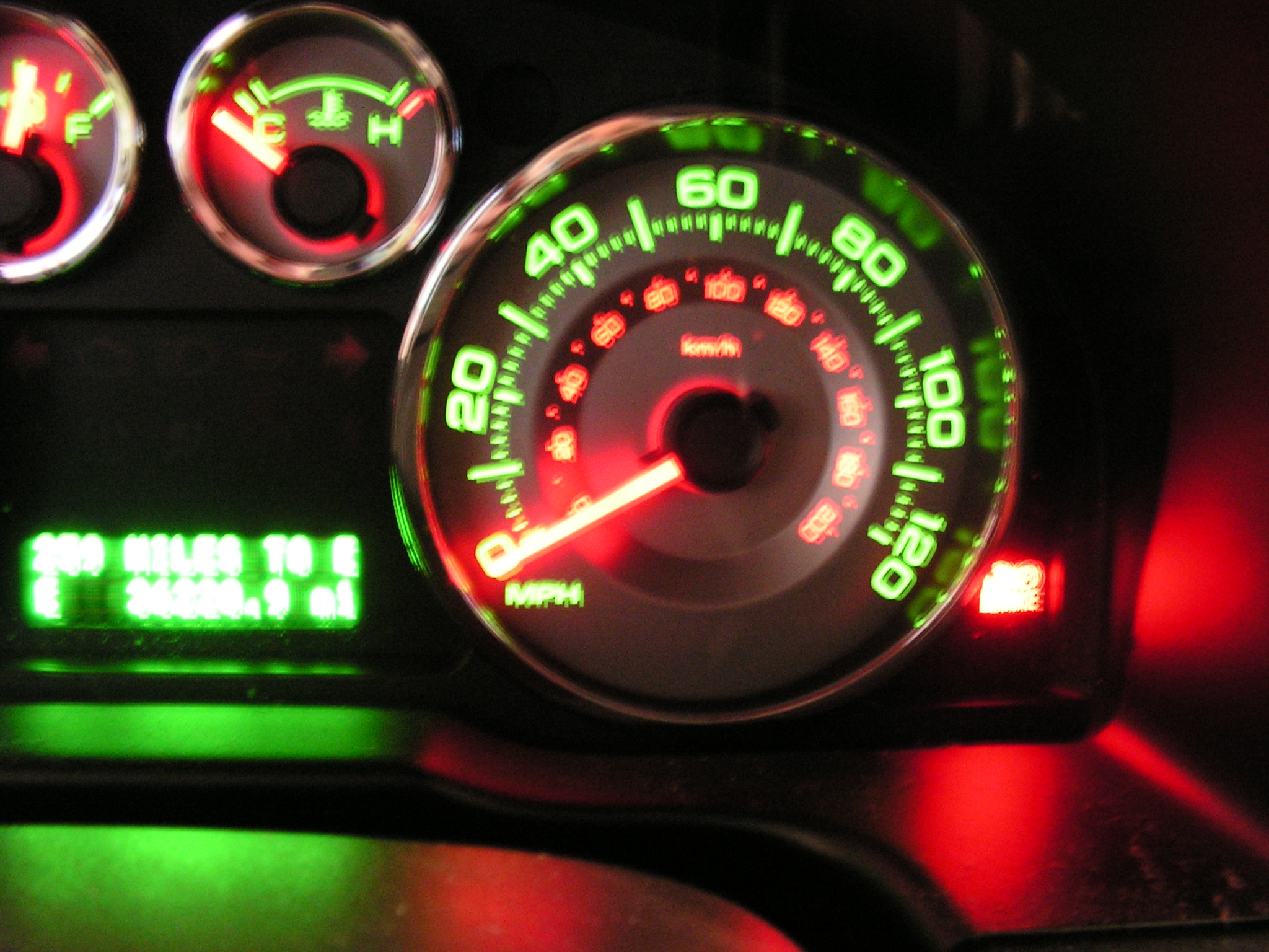

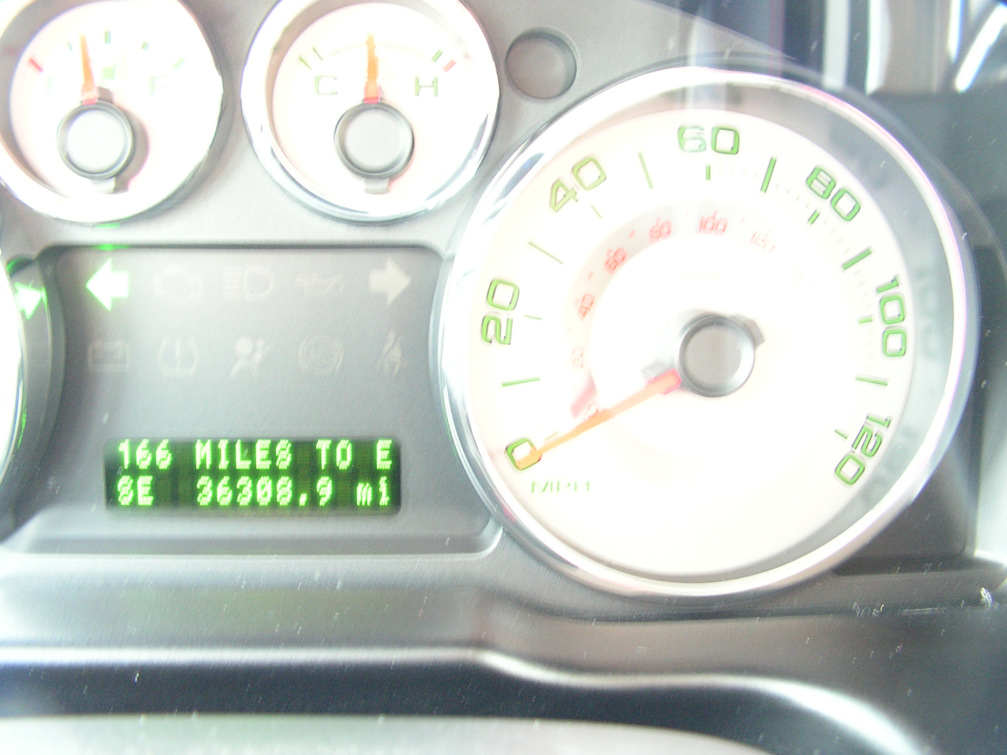

PJFW8 Posted October 2, 2009 Report Share Posted October 2, 2009 My son is a gunsmith... precisely! Pictures! Note how when there is glare at twilight that wipes out the guages. These particular photos show the transition from daylight to full darkness. Note the fuel and temperature guages. At other times and angles the speedometer is wiped out, but you get the idea. Thoughts? Quote Link to comment Share on other sites More sharing options...
Lex Talionis Posted October 2, 2009 Report Share Posted October 2, 2009 (edited) the first picture tells me all I needed to know to know... your lights are fine. They are not flawed as they are just like mine in brightness - so to me, that rules out a mechanical issue. I took some similar photos, exactly the same results. Thus, it tells me it is a personal preference thing and not an issue with the lighting/dimmer feature. Now, last night at twilight/dusk - when driving back from a stellar sunset and beach swim - I kind of see what you mean about them kind of washing out and hard to read. But, in my case, I was able to adjust that dimmer to the brightest setting to overcome the outside lighting conditions. However, I never have my dash lights on full blast. They are also set kind of dim as I hate it bright in my car. But, it was at that time that I kind of got a feel for your compliant as the dim setting I like at that time of the day made the gauges hard to read. but like I said, cranked up the dash lights and viola - I could see it all fine. So, like I said, seeing your first photo shows me you get the same full on brightness I get, so it seems to me to be a personal preference issue and not an actual flaw in the system. BTW.. did you tint your front windows? Mine are, and maybe that also adds some protection from your issue you might consider... yeah yeah it can be illegal in some states, I know I know, but I do not care as it's benefits out weigh the fix-it-ticket Edited October 2, 2009 by Lex Talionis Quote Link to comment Share on other sites More sharing options...
PJFW8 Posted October 2, 2009 Report Share Posted October 2, 2009 the first picture tells me all I needed to know to know... your lights are fine. They are not flawed as they are just like mine in brightness - so to me, that rules out a mechanical issue. I took some similar photos, exactly the same results. Thus, it tells me it is a personal preference thing and not an issue with the lighting/dimmer feature. Now, last night at twilight/dusk - when driving back from a stellar sunset and beach swim - I kind of see what you mean about them kind of washing out and hard to read. But, in my case, I was able to adjust that dimmer to the brightest setting to overcome the outside lighting conditions. However, I never have my dash lights on full blast. They are also set kind of dim as I hate it bright in my car. But, it was at that time that I kind of got a feel for your compliant as the dim setting I like at that time of the day made the gauges hard to read. but like I said, cranked up the dash lights and viola - I could see it all fine. So, like I said, seeing your first photo shows me you get the same full on brightness I get, so it seems to me to be a personal preference issue and not an actual flaw in the system. BTW.. did you tint your front windows? Mine are, and maybe that also adds some protection from your issue you might consider... yeah yeah it can be illegal in some states, I know I know, but I do not care as it's benefits out weigh the fix-it-ticket Thanks for looking, Lex. I have less trouble than my wife. She has the lights on max! The guage cluster design does promote glare. Can't tint a windshield in my state (and the state patrol likes to use it as a pretext to stop and search). I'll try a florescent line on the crome ring. A little extra contrast should help. Quote Link to comment Share on other sites More sharing options...
bbf2530 Posted October 2, 2009 Report Share Posted October 2, 2009 (edited) Thanks for looking, Lex. I have less trouble than my wife. She has the lights on max! The guage cluster design does promote glare. Can't tint a windshield in my state (and the state patrol likes to use it as a pretext to stop and search). I'll try a florescent line on the crome ring. A little extra contrast should help. Hi PJFW8. :D After looking at the pictures, I agree. It seems to be more of a glare issue than a "lighting" problem. In addition to the window tinting, I have another suggestion. The gauge cover/lens seems to be a bit dirty/dusty. Have you cleaned the gauge cover/lens lately? Over time, it will get that same film, dust etc which dirties the inside of the windows. You will be surprised how much that will add to the glare problem. Use a small, very soft, 100% cotton or automotive microfiber towel (I use 100% cotton) and spray the automotive glass cleaner (no ammonia!) directly on the small towel. You spray the cleaner on the towel instead of the lens to avoid having the cleaner run down into the cluster. Then wipe very gently (pressing or rubbing hard will cause scratches) and then dry with a second towel of the same type (again, very gently). Hope this helps. Good luck. :beerchug: Edited October 2, 2009 by bbf2530 Quote Link to comment Share on other sites More sharing options...
PJFW8 Posted October 2, 2009 Report Share Posted October 2, 2009 Hi PJFW8. :D After looking at the pictures, I agree. It seems to be more of a glare issue than a "lighting" problem. In addition to the window tinting, I have another suggestion. The gauge cover/lens seems to be a bit dirty/dusty. Have you cleaned the gauge cover/lens lately? Over time, it will get that same film, dust etc which dirties the inside of the windows. You will be surprised how much that will add to the glare problem. Use a small, very soft, 100% cotton or automotive microfiber towel (I use 100% cotton) and spray the automotive glass cleaner (no ammonia!) directly on the small towel. You spray the cleaner on the towel instead of the lens to avoid having the cleaner run down into the cluster. Then wipe very gently (pressing or rubbing hard will cause scratches) and then dry with a second towel of the same type (again, very gently). Hope this helps. Good luck. :beerchug: Thanks! I'll give it a try! Quote Link to comment Share on other sites More sharing options...
bbf2530 Posted October 2, 2009 Report Share Posted October 2, 2009 Thanks! I'll give it a try! Hi PJFW8. :D You are welcome. While it certainly won't completely eliminate the glare issue, it may help a little. Good luck. :beerchug: Quote Link to comment Share on other sites More sharing options...
