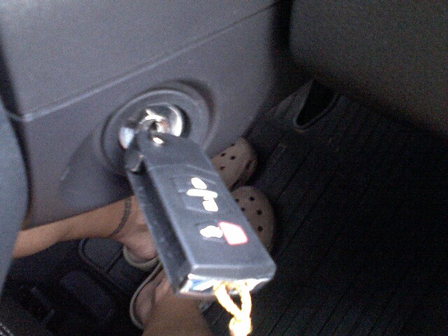

securinu Posted September 4, 2009 Report Share Posted September 4, 2009 From Above the steering wheel Quote Link to comment Share on other sites More sharing options...
securinu Posted September 4, 2009 Report Share Posted September 4, 2009 was able to prog it to set memory as well. Quote Link to comment Share on other sites More sharing options...
