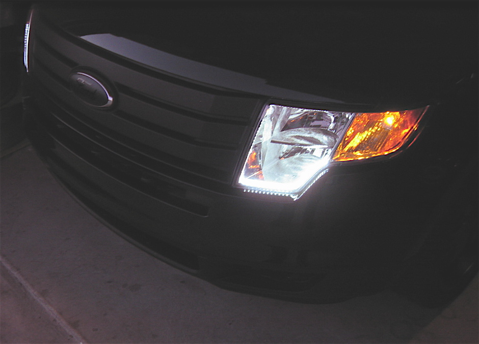

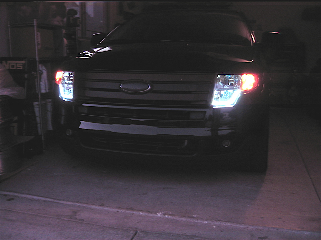

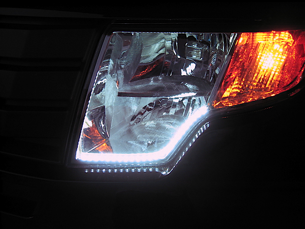

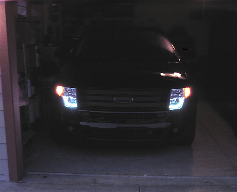

Loosecannon Posted July 8, 2009 Report Share Posted July 8, 2009 So, bought some flexible, sealed, waterproof LED lights, and installed them inside of my Edge headlights to give it that Audi look that we all love so much (well atleast i love...). The pictures really do not do them justice. I think they look really trick. When the headlights are on, they are still plenty visible, since the low beams sit on top, and the LED's are at the bottom. Anyways,.. hope you all like. -Cannon P.s. The install was a NIGHTMARE, and i would not recommend anyone try this. Had i know what a PITA this would have been, i wouldn't have started it. The glue that Ford uses to seal the headlights , must be the same glue that holds the Empire State Building together. Quote Link to comment Share on other sites More sharing options...
Lex Talionis Posted July 8, 2009 Report Share Posted July 8, 2009 very cool! 1-of-a-kind there. I dig them, and yes, I love the Audi lights as well. So, how did you get into the actual body of the lights? what did you use to adhere the LED string to the lights? how are you powering the LED lights, what did you tie into? did you cut to fit the string, it happened to be the right size, or you have extra lights sticking into your engine bay? Quote Link to comment Share on other sites More sharing options...
PSUFetch Posted July 8, 2009 Report Share Posted July 8, 2009 Nicely done. They look great. Did you bake the lights to help open them up? That seemed to help alot with Mazda6 headlights. Thanks for the pics. I agree with you, the LED's are hard to get a good picture of. You can't see the individual lights in the pictures, but knowing what they look like on Audi's, I'm sure they look great in person. Quote Link to comment Share on other sites More sharing options...
Loosecannon Posted July 8, 2009 Author Report Share Posted July 8, 2009 very cool! 1-of-a-kind there. I dig them, and yes, I love the Audi lights as well. So, how did you get into the actual body of the lights? what did you use to adhere the LED string to the lights? how are you powering the LED lights, what did you tie into? did you cut to fit the string, it happened to be the right size, or you have extra lights sticking into your engine bay? You always crack me up Lex. Your a car nut like me, and always have a million questions, LOL. I baked the headlights... normal headlights (chevy, mazda, etc..) when ya bake them, the glue that seals the headlight softens up, and you pry the headlight open. Ford uses some stupid ass glue that is impossible to break apart. I baked them over and over and at higher temps, and it was still a nightmare. The black plastic housing is all messed up where it meets the front headlight cover, but i was able to get them all sealed up again and back together. From the outside, they look good, but if you pull the headlight, it looks like a blind monkey did the install. I resealed them with clear RTV sealant. I used good old crazy glue to glue the LED to the front chrome housing. I then drilled a tiny hole in the chrome divider bar and ran the wiring thru that, and out one of the rubber boots that for the headlight bulbs. I then just spliced them into the parking lights (they do not blink when my turn signals are on either.). And thats it. Like i said,.. it was a major pain in my butt, and if i would have known how hard it would have been to get the Ford glue to soften, i wouldn't have done it. But it was sorta like vomiting,... once i started i couldn't stop. -Cannon Quote Link to comment Share on other sites More sharing options...
Lex Talionis Posted July 8, 2009 Report Share Posted July 8, 2009 But it was sorta like vomiting,... once i started i couldn't stop. bwa ha ha I call that having O.C.D. - I know how that goes very cool project. I wish there was an easier way. Not that I couldn't do it, but it does sound like a bit much. I hope you bought a quality LED string of lights as I would hate to have to swap it out if one goes bad as Lord knows, I have already changed a few bad LED bulbs. BTW, where did you get the string of LEDs? Quote Link to comment Share on other sites More sharing options...
Loosecannon Posted July 8, 2009 Author Report Share Posted July 8, 2009 bwa ha ha I call that having O.C.D. - I know how that goes very cool project. I wish there was an easier way. Not that I couldn't do it, but it does sound like a bit much. I hope you bought a quality LED string of lights as I would hate to have to swap it out if one goes bad as Lord knows, I have already changed a few bad LED bulbs. BTW, where did you get the string of LEDs? Ya i hope they don't go bad either. I don't think they will tho. I bought them thru www.BL-LED.com.au Great company to deal with. Quote Link to comment Share on other sites More sharing options...
