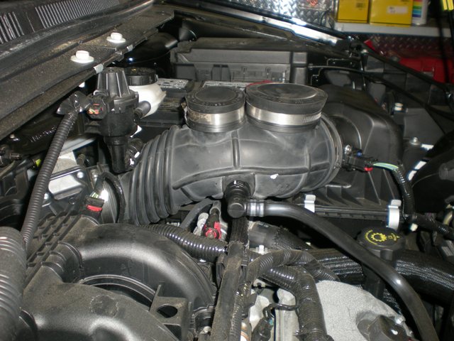

bobert727 Posted June 14, 2009 Report Share Posted June 14, 2009 What is that boxy-shaped thing on top of the air intake and what is it for? Can it be removed? Thanks in Advance 2007 Ford Edge Limited Quote Link to comment Share on other sites More sharing options...
Edge184 Posted June 14, 2009 Report Share Posted June 14, 2009 It is a resonater, it cuts down on some of the sound coming out of the exhaust. It is just s plastic box with a couple of chambers. It can be removed by removing the clamps and purchasing some rubber caps. I removed mine and put rubber caps on them. Really doesn't make that much of a difference with it off but it gets rid of that big plastic box. Quote Link to comment Share on other sites More sharing options...
bobert727 Posted June 14, 2009 Author Report Share Posted June 14, 2009 It is a resonater, it cuts down on some of the sound coming out of the exhaust. It is just s plastic box with a couple of chambers. It can be removed by removing the clamps and purchasing some rubber caps. I removed mine and put rubber caps on them. Really doesn't make that much of a difference with it off but it gets rid of that big plastic box. Thanks for the response and the picture! Quote Link to comment Share on other sites More sharing options...
BlazedUp Posted June 14, 2009 Report Share Posted June 14, 2009 It cuts down on the noise of the intake air being sucked into the motor, not the exhaust. Quote Link to comment Share on other sites More sharing options...

BlazedUp Posted August 15, 2009 Report Share Posted August 15, 2009 It reduces turbulence of the incoming air and makes intake more efficient. I would advise against removing it. Quote Link to comment Share on other sites More sharing options...
anpbabaki Posted August 17, 2009 Report Share Posted August 17, 2009 hmm.. maybe i'll take mine off too... i hate that thing.. so ugly... lol please dont take it off because its "ugly" its under the hood!! no one is going to see it, i assure you ford engineers put it there for a reason. Quote Link to comment Share on other sites More sharing options...
Waldo Posted August 17, 2009 Report Share Posted August 17, 2009 It reduces turbulence of the incoming air and makes intake more efficient. I would advise against removing it. No, it certainly does not do this. It's purely for noise reduction and will not affect the performance of the engine in any way. Quote Link to comment Share on other sites More sharing options...
its4myhonee Posted August 17, 2009 Report Share Posted August 17, 2009 turbulence? thats what the air filter does.... lol.. if anything it creates humps in the flow.. Quote Link to comment Share on other sites More sharing options...
