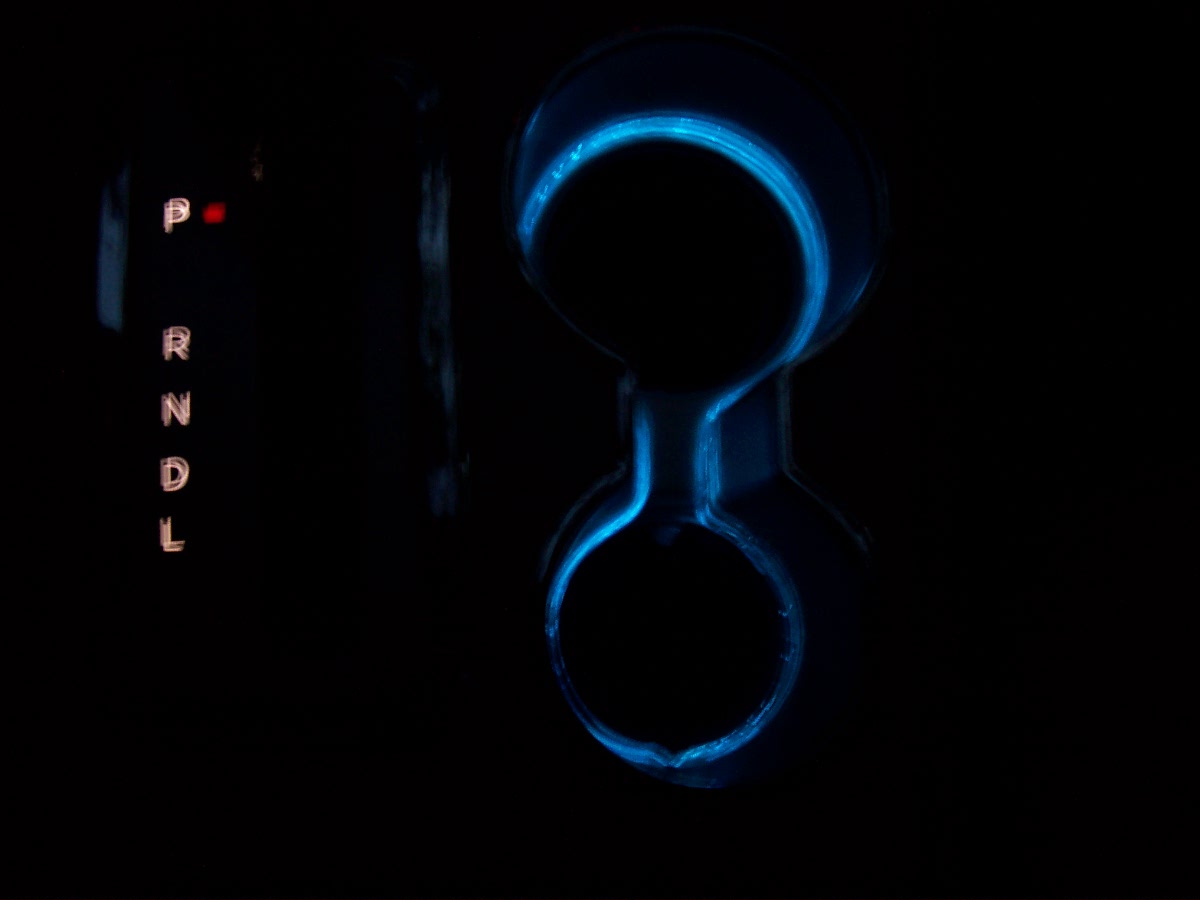

kempie Posted June 10, 2009 Author Report Share Posted June 10, 2009 Thanks Lex. I was adding a lighted cig. lighter and some EL wire in the cup holders. $200+ is a little--lot much for me for some lighting. $20. covered this mod. Plus about another $50 worth of humiliation and frustration for not realizing the dimmer wheel was in the dimmed position. Quote Link to comment Share on other sites More sharing options...

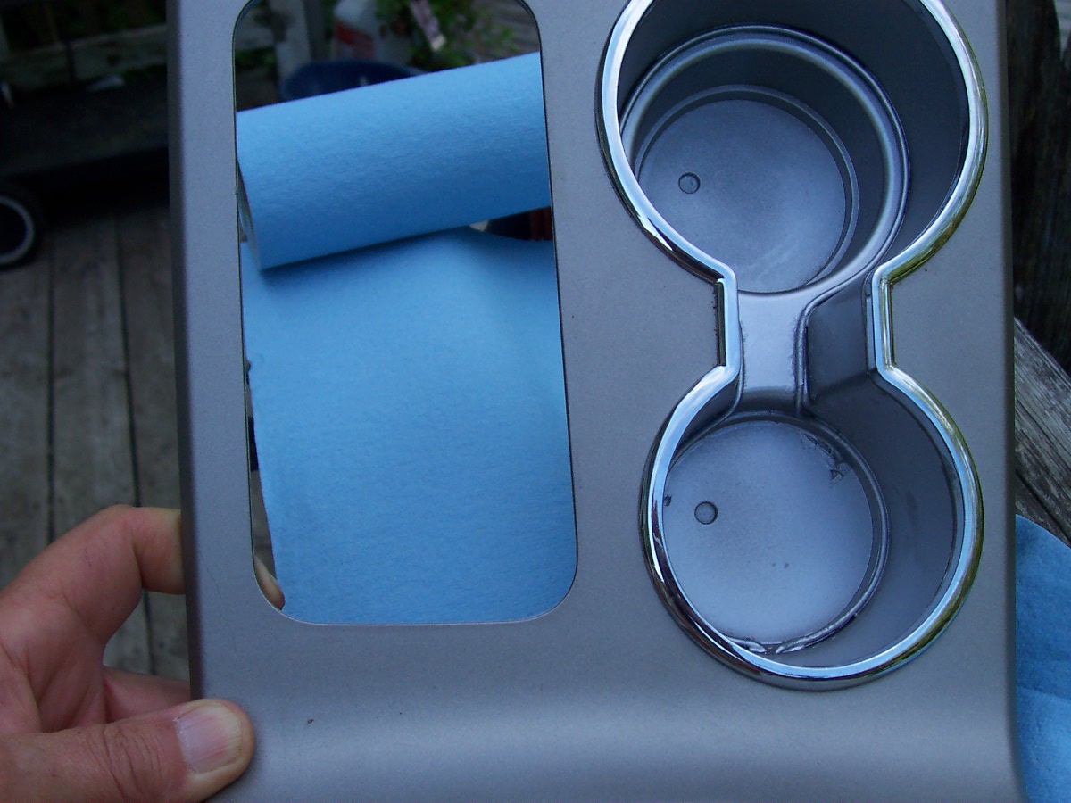

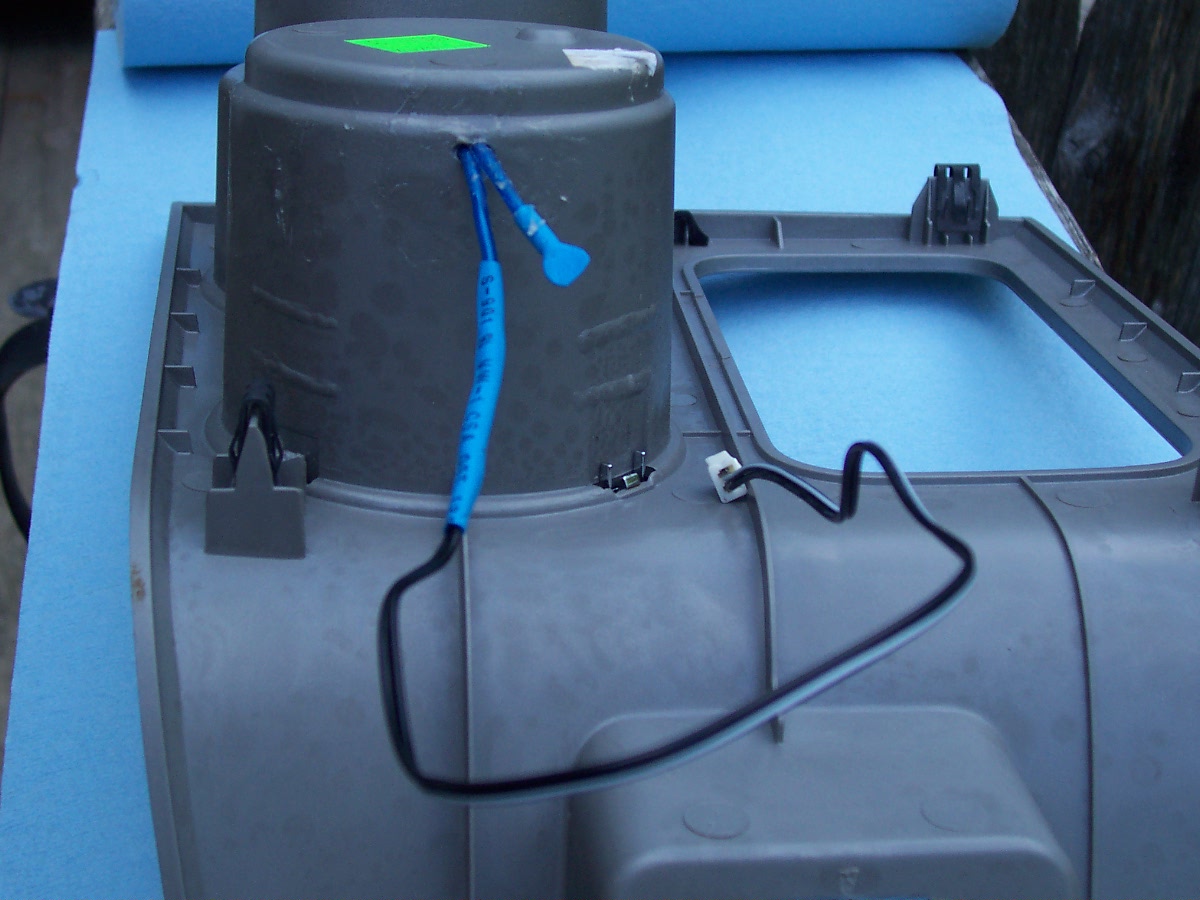

kempie Posted June 11, 2009 Author Report Share Posted June 11, 2009 (edited) I replaced the power point in the dash with a lighted lighter. Used the power point wires for the lighter and wired the light to the Blue wire in the console. Then got a $10 EL type wire kit and super glued it in the cupholder. Used silicone to fill the hole where the wire exits the cupholder & cut the wire to size. Then misted the wire & cupholder with duplicolor spray paint (silver) so the blue wire wouldnt be so visible in the daylight. Connected the EL wire controller to the Blue light power wire and to the Black ground wire for the lighter. Edited June 11, 2009 by kempie Quote Link to comment Share on other sites More sharing options...

kempie Posted June 11, 2009 Author Report Share Posted June 11, 2009 Yes, you can still use the rubber plates. The wire is on the higher lip on the front holder and there is a lip on the smaller holder, that is above the area the rubber sits, that holds the wire. Fully functional. Quote Link to comment Share on other sites More sharing options...
