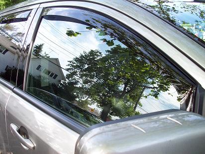

igcitng Posted June 15, 2009 Report Share Posted June 15, 2009 Here are some pics. They look nice, went in pretty well. Took a lot of bending for the front ones. Have to make sure that the edge of the visor on the mirror end of the window is sitting on top of the window weather strip or it won't fit tight. The back ones are easy, there is adhesive on the ends to secure them inside. And I had no problems with the windows closing or the auto close on the driver window. Hey guys. Could those of you who installed these post some pics? Some from afar, some up close and some actually showing the window down a bit from inside the cab. Thanks! Quote Link to comment Share on other sites More sharing options...

livinontheEdge Posted July 15, 2009 Report Share Posted July 15, 2009 Here are some pics. They look nice, went in pretty well. Took a lot of bending for the front ones. Have to make sure that the edge of the visor on the mirror end of the window is sitting on top of the window weather strip or it won't fit tight. The back ones are easy, there is adhesive on the ends to secure them inside. And I had no problems with the windows closing or the auto close on the driver window. Thx also. Was looking at tape mounted visors. Your pics sold me on in channel visors. Saved me the hassle of ordering wrong ones. Again, thx 4 pics. Quote Link to comment Share on other sites More sharing options...
igcitng Posted July 15, 2009 Report Share Posted July 15, 2009 One issue that has come up is that on the front ones, where it sits on the window ledge, have a protective piece of rubbery tape right there that wraps to both sides. It has wrinkled and come off. I emailed them to ask if I can get spares and in the mail I get a big roll of sticky tape. Otherwise I like them. Front driver door one a little loose. Quote Link to comment Share on other sites More sharing options...
TexasEdge Posted July 15, 2009 Report Share Posted July 15, 2009 Thanks for posting the pictures. They really look good. The ones I have seen must have been the ones that stick on outside and thought they took away from the appearance of the car. Now I'm interested in getting some for my Edge. The temperatures for several days the last two weeks driving home from work have been 100 to 103 degrees. It's too dang hot in Texas... They would be perfect to vent the heat out of the car while it sets in the parking lot all day and when the rare shower that does pop up the inside will still stays dry. I do have a question though. Do you notice any wind noise with the window up and at speed? Thanks again for all your info. Quote Link to comment Share on other sites More sharing options...
igcitng Posted July 15, 2009 Report Share Posted July 15, 2009 If you mean with the window all of the way up, no. It is snug. When you put them in, be careful of that protective tape on the front ones, try not to wrinkle it. I think these are easier for guys to install, anyone a little taller and a little stronger. They bend a lot but they fight back. Quote Link to comment Share on other sites More sharing options...
bgattis Posted December 15, 2009 Report Share Posted December 15, 2009 Here are some pics. They look nice, went in pretty well. Took a lot of bending for the front ones. Have to make sure that the edge of the visor on the mirror end of the window is sitting on top of the window weather strip or it won't fit tight. The back ones are easy, there is adhesive on the ends to secure them inside. And I had no problems with the windows closing or the auto close on the driver window. Thanks. Looks like I will need to order these today. They look nice! Thanks for posting pics. Quote Link to comment Share on other sites More sharing options...
flyerjmr33 Posted December 15, 2009 Report Share Posted December 15, 2009 Thanks. Looks like I will need to order these today. They look nice! Thanks for posting pics. I've used these on 4 different vehicles. They are the best and will not fall off like the tape on version. The Edge installation was the tightest of all, but still worked OK.! Quote Link to comment Share on other sites More sharing options...
