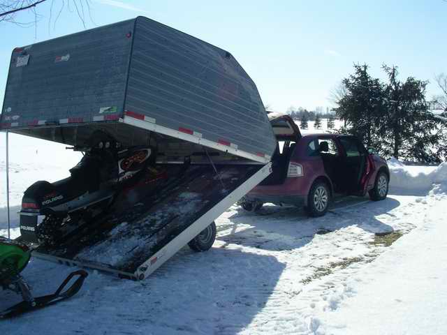

Scott S Posted June 29, 2009 Report Share Posted June 29, 2009 I haul a two place aluminum 08 Sno Pro clamshell with my edge and it works great. No shortage of power. Tows better than my old Explorer Ltd did. The AWD has not let me down and we've ran some pretty nasty weather with it. 1 Quote Link to comment Share on other sites More sharing options...
