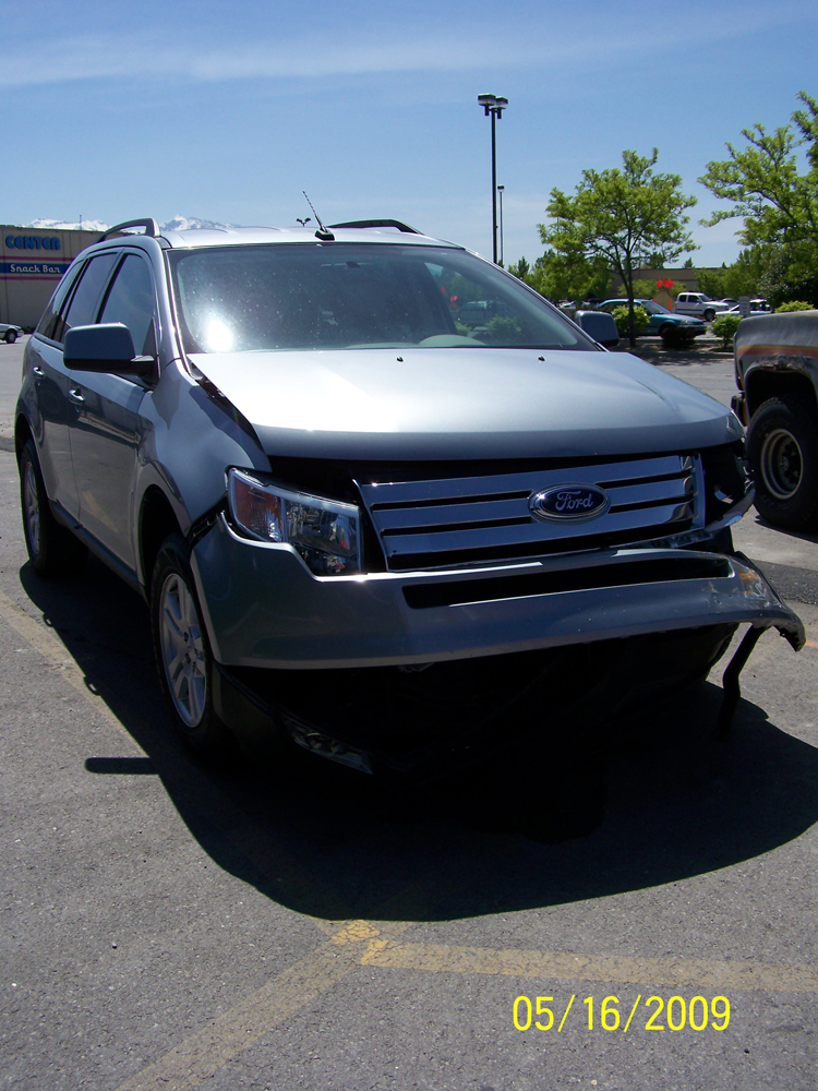

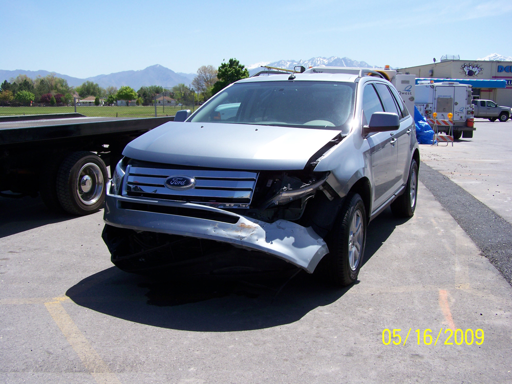

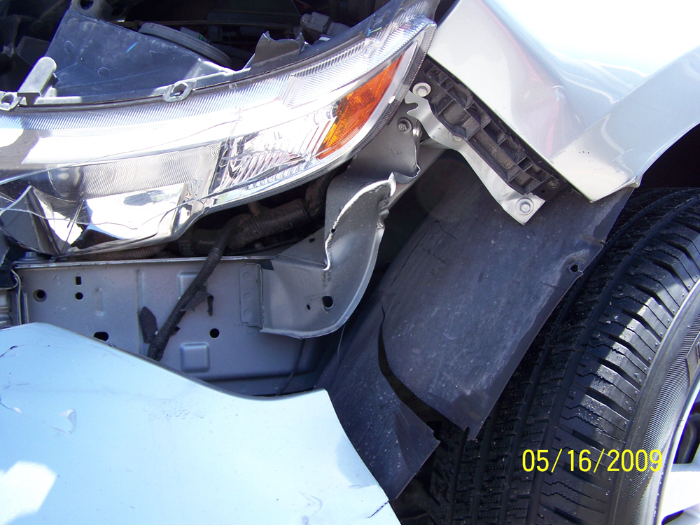

Theo Posted May 19, 2009 Report Share Posted May 19, 2009 Well i will start with the good pictures of my 07 Edge... the wash and detail I did on Wednesday of last week, Wednesday May 13th and now I will show the Accident pictures on Friday... two days after she looked beautiful Friday May 15th My question is if anyone can tell me with the metal that is bent, if that is the frame... and if it is what is the possibilty of it being fixed... I am actually upside down on the Edge so if its totaled then its a good thing, but the thing that stinks is i loved the car. it was a fun cute care. I was hit my a teenager that ran a red light because he was in trouble with his parents for being late. He said this was his second accident this week and second vehicle that was towed Quote Link to comment Share on other sites More sharing options...
akirby Posted May 19, 2009 Report Share Posted May 19, 2009 You don't really have a frame but there's no way to tell if the unibody is bent until they put it on a jig and measure it. If the fenders aren't deformed then you might be ok. Looks like the grill absorbed most of the impact. The one thing I always told my son was don't hurry to get home. Call and tell us you're on the way and drive safely. Quote Link to comment Share on other sites More sharing options...
500 h.o. Posted May 19, 2009 Report Share Posted May 19, 2009 (edited) Nope, thats not a totaled car. The insurance company will weigh how much it will cost to fix it against how much it will cost them to total it. They will do whatever costs them the least and they will probably wind up fixing that car. There is just not enough damage there. Edited May 19, 2009 by 500 h.o. Quote Link to comment Share on other sites More sharing options...
CorporateEdge Posted May 19, 2009 Report Share Posted May 19, 2009 They will likely fix it. I could not see from the pictures if the air bags went off. Figure several thousand for the new air bags, sensors, interior trim panels to cover them. Also in one shot there appears to be deformation of the passenger front door. That would indicate that the unibody is bent, likely downward given the type if impact. They can likely straighten the body out. The one thing you should check on is if your policy (or state law) allows you to insist on OEM new replacement parts. Know exactly what your policy says and what your rights are before agreeing to anything with the insurance company and/or body shop. Put it in writing also (i got salvaged parts in one of my claims and it caused all kinds of problems). The key thing is you were not hurt. drag about the car ! Quote Link to comment Share on other sites More sharing options...
igcitng Posted May 19, 2009 Report Share Posted May 19, 2009 They will fix it. Cars now do not have the famous frames that when bent were considered a total. The front took the impact and crumpled like it is supposed to to protect the insides. The 'frame' is deep in the center. Please post how the paint turns out, I have the same color. And hopefully everyone is ok. I was hit last year by a 16 yo with a month old license. Knocked the body of my truck off of the frame and gave me a concussion. After almost a year of post accident treatment the worst of it has been his insurance company, so be ready. Document everything and I hope the person that hit you was issued a ticket. It helps a lot. Now I know why my parents always worried so much when I was that age! Quote Link to comment Share on other sites More sharing options...
zhotster Posted May 20, 2009 Report Share Posted May 20, 2009 (edited) Sorry about your accident! I'm also fairly certain that this car is not totalled. The unibody is in clear view on the bottom 2 photos. The inner fender pan is crumpled, but the unibody (many people refer to this as the frame) appears that it didn't take a bad hit. If anything, it may have gotten pushed upward based on the photos of the front. The fender to door fit on the passenger side looks fairly normal. Regardless, if the unibody is pushed up or over a little it won't take much to pull it back. The OEM parts for the Edge aren't really that expensive, compared to other models. This car appears to need a radiator support (bolt-in), both headlights, grille, inner fender sheetmetal, air cleaner, hood (it may be repairable), left fender, front bumper cover, possibly radiator/AC condensor/fans. I also can't see if the airbags are blown. That would drive the estimate up big time. Good luck. This car can be fixed nicely by an experienced auto body shop. It will look as good as new! Edited May 20, 2009 by zhotster Quote Link to comment Share on other sites More sharing options...
DJ Nap Posted May 20, 2009 Report Share Posted May 20, 2009 It stood up well!! Hood moved up, grille is in one piece (it appears). Glad you are ok! Quote Link to comment Share on other sites More sharing options...
Theo Posted June 8, 2009 Author Report Share Posted June 8, 2009 Well the Edge is totalled. Has a total of about $17K in total damage, plus the car rental will put it as a total loss... The crappy thing is the stupid retard that hit me has Progressive and he only had $15k in collision insurance so I had to put the claim thru my insurance... I do have GAP insurance and American Family has been great... I have my eyes on a nice 2005 VW Jetta thats white and with beige leather... total price of about $11k with TTL... The Edge was great.. and a very safe vehicle... Just wanted to update you guys... if anyone was wondering.... Quote Link to comment Share on other sites More sharing options...
