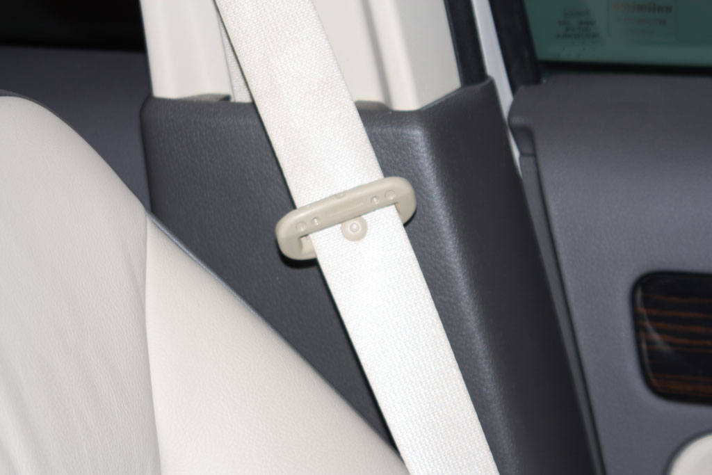

bluetexan Posted April 25, 2009 Report Share Posted April 25, 2009 Hey all, My wife the other night came to me and said that she was having some issues with the driver side seatbelt getting tangled when she put it on. Thinking that this was a really quick, easy fix I went out into the garage, hopped into the seat, and fumbled for a second or two....I instantly saw what she meant. On every other seatbelt (except the driver side), the latch is facing into the car (ala into the seat when not used and retracted). The driver side seatbelt is facing OUTWARD when the seatbelt is not in use. Was this an oops from the factory or is it supposed to be like that, and how in the hell do I turn the latch around without destructing the clasp? Quote Link to comment Share on other sites More sharing options...
ablb Posted April 25, 2009 Report Share Posted April 25, 2009 Hey all, My wife the other night came to me and said that she was having some issues with the driver side seatbelt getting tangled when she put it on. Thinking that this was a really quick, easy fix I went out into the garage, hopped into the seat, and fumbled for a second or two....I instantly saw what she meant. On every other seatbelt (except the driver side), the latch is facing into the car (ala into the seat when not used and retracted). The driver side seatbelt is facing OUTWARD when the seatbelt is not in use. Was this an oops from the factory or is it supposed to be like that, and how in the hell do I turn the latch around without destructing the clasp? Are you talking about 1, 2 (are stock) or 3 reversed by me? ab Quote Link to comment Share on other sites More sharing options...
bluetexan Posted April 25, 2009 Author Report Share Posted April 25, 2009 Yeah, ours is number 3, but I want it to be number 1. How did you reverse it?? Quote Link to comment Share on other sites More sharing options...
ablb Posted April 25, 2009 Report Share Posted April 25, 2009 (edited) Yeah, ours is number 3, but I want it to be number 1. How did you reverse it?? Start a flap (it'll be tight) and slide it up. Here's a pic of the start. By the time it gets to the top it will have done a 180. ab Edited April 25, 2009 by ablb Quote Link to comment Share on other sites More sharing options...
blockisle9 Posted April 26, 2009 Report Share Posted April 26, 2009 Start a flap (it'll be tight) and slide it up.Here's a pic of the start. By the time it gets to the top it will have done a 180. ab Yep thats How I fliped mine... Quote Link to comment Share on other sites More sharing options...
