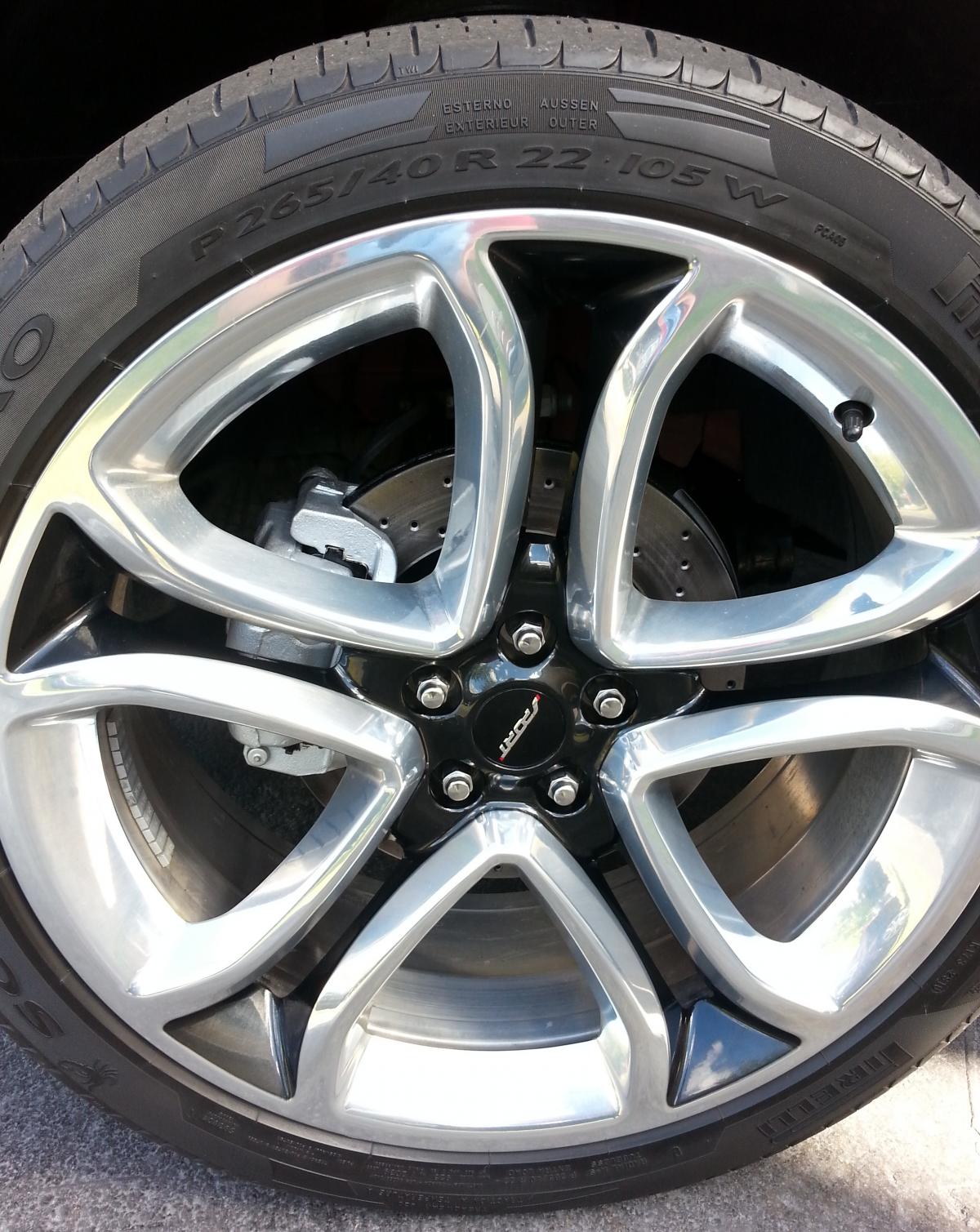

Swood73 Posted September 23, 2014 Report Share Posted September 23, 2014 Wife purchased a used 2011 Sport In April. 34k when we purchased to. at 39K is when I could feel a slight vibration under breaking. Still had about 1/2 pad life left. Rear pads were more worn than front but still not down to indicators. These softer metals wear allot faster. I would say stopping 75lb wheels to boot adds some heat. Replaced front and rear rotors and pads this past Sunday with a set of R1 Concepts Premier Series Cross Drilled Rotors and pads. These also are E coated since we are in Ohio and they pound the roads with salt in the winter months. Thought I would share some photos as well. Whole kit was $500. Kit R1 Concepts CPX11124 2 Quote Link to comment Share on other sites More sharing options...
