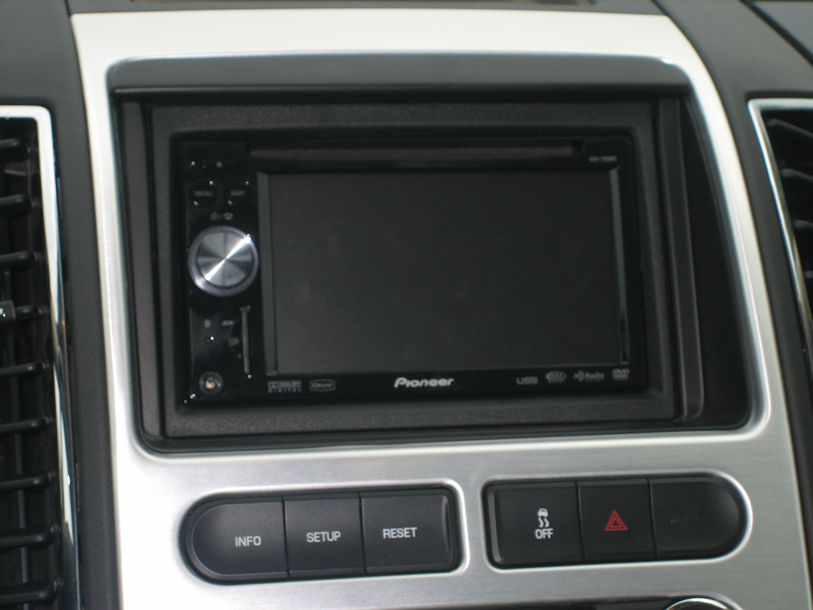

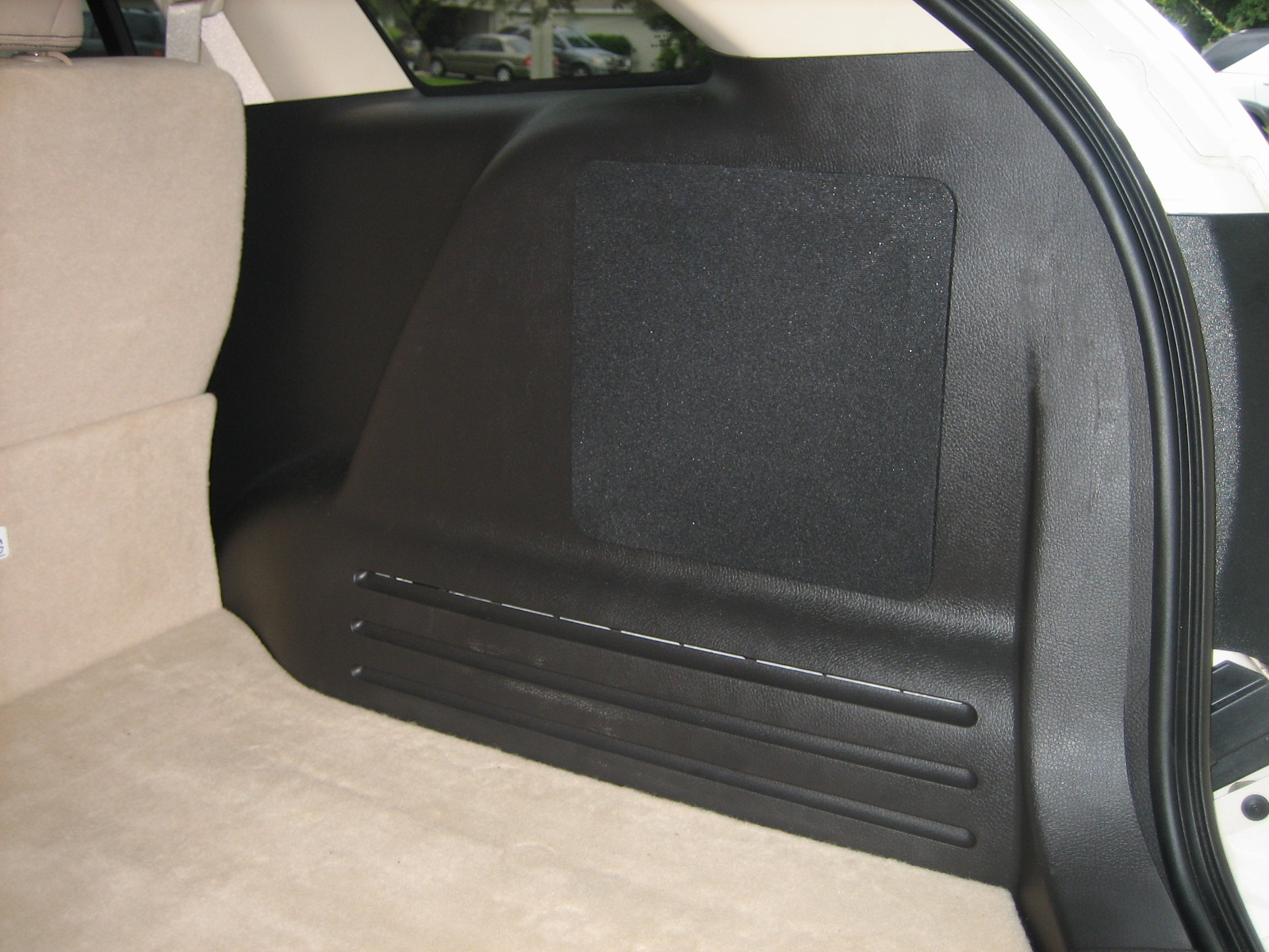

So..... I tore it all out and put in an AVIC-F900BT, 682.9cf's in the doors and a JL Audio Stealthbox with a Pioneer 300watt AMP.
All I have to say is... WOW! I had the Kappa's hooked up to the stock ford navi unit and the difference is night and day, and thats without the sub!!
Throw the stealthbox into the mix and WOW!!! That thing is perfect! great low end, for all music not just bass heavy songs.
Also not so much bass that I sound like a teenager BOOMING through the streets, you can barely here it out side of the vehicle, even when turned up pretty good.

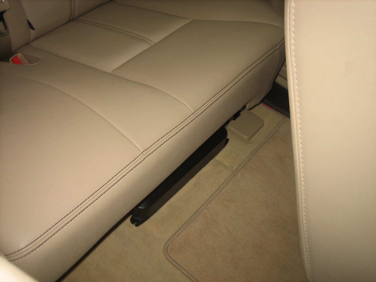

Not to mention you can't even see the sub, same location as the stock 8". the amp is under the driverside back seat.

hmmm..... I figured they put the lift gate motor and other stuff in there. I will move it if there is enough room. Thanks for the heads up!!!
will there be enough room even with the power liftgate option? Would like to know before unhooking everything. Thanks!!
Just pulled the driverside not nearly enough room for the amp I have, oh well.
The back seat goes down just fine, the amp just had to mounted a bit forward so the
bar misses it; when it moves forward and down.
Thanks for the thought though.
