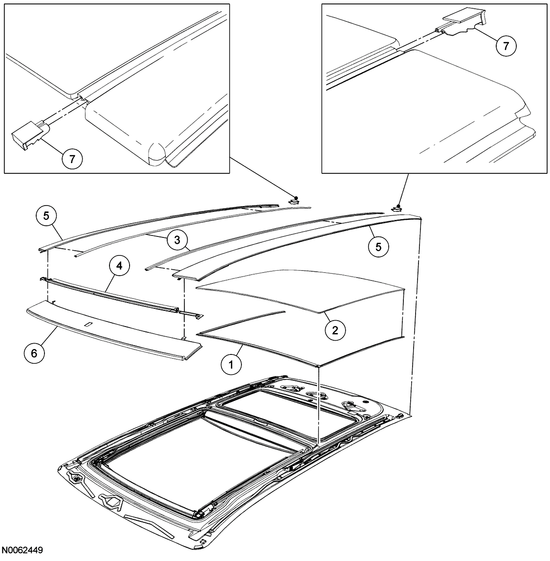

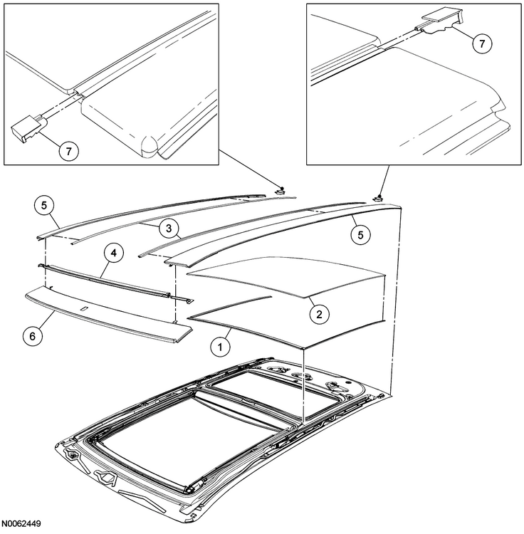

edgemaster Posted March 28 Author Report Share Posted March 28 Perhaps some people have been thrown off by my erroneously calling the sunroof the wrong name (skylights), my bad, sorry. I found a diagram of all the pieces that go into the sunroof but there are so many that I am sort of confused which ones I need to order. I'll attach that image, maybe someone can point me into the right direction? Thanks a lot. Ed Quote Link to comment Share on other sites More sharing options...
enigma-2 Posted March 30 Report Share Posted March 30 (edited) My guess is you're talking about #16 (upper seal, 7T4Z-7851707-A, $127.86) #17 (front seal, 7T4Z-7851884-A, $228.63) & #18 (rear seal, 7T4Z-7850036-A, $244.66). As for method of repair, you are going to need to buy a body manual to do the job properly. You can buy a set of bofmdy manuals on Ebay for $30. Item number 394401556064 (last one, don't dilly dally). https://www.ebay.com/itm/394401556064?mkcid=16&mkevt=1&mkrid=711-127632-2357-0&ssspo=2_naznvlqda&sssrc=4429486&ssuid=Snv36mbbRk2&var=&widget_ver=artemis&media=COPY Edited March 30 by enigma-2 Quote Link to comment Share on other sites More sharing options...
enigma-2 Posted March 30 Report Share Posted March 30 Link to working diagram, part numbers, prices and where to buy parts. https://parts.levittownfordparts.com/v-2009-lincoln-mkx--base--3-5l-v6-gas/body--sunroof Quote Link to comment Share on other sites More sharing options...

edgemaster Posted March 30 Author Report Share Posted March 30 enigma-2 Thanks for the detailed info. Actually, I'm talking about the rubber seal between the front and the rear glass. I'm not sure which it is on that diagram. And no, that rejuvenator likely won't work, there are large pieces of rubber that can be pulled off. Quote Link to comment Share on other sites More sharing options...

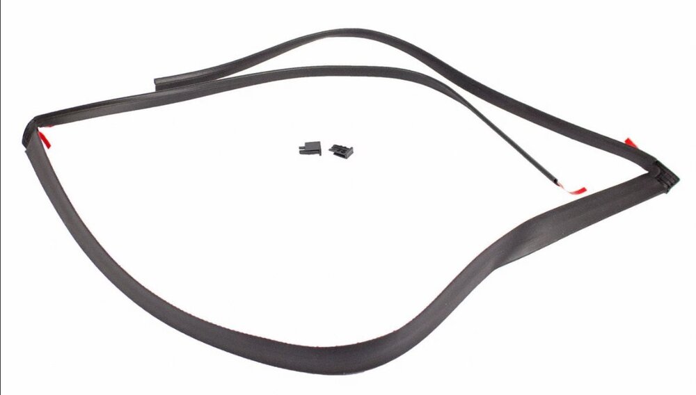

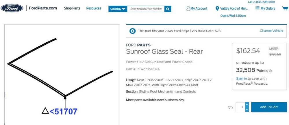

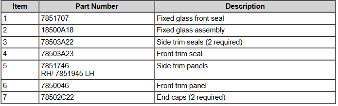

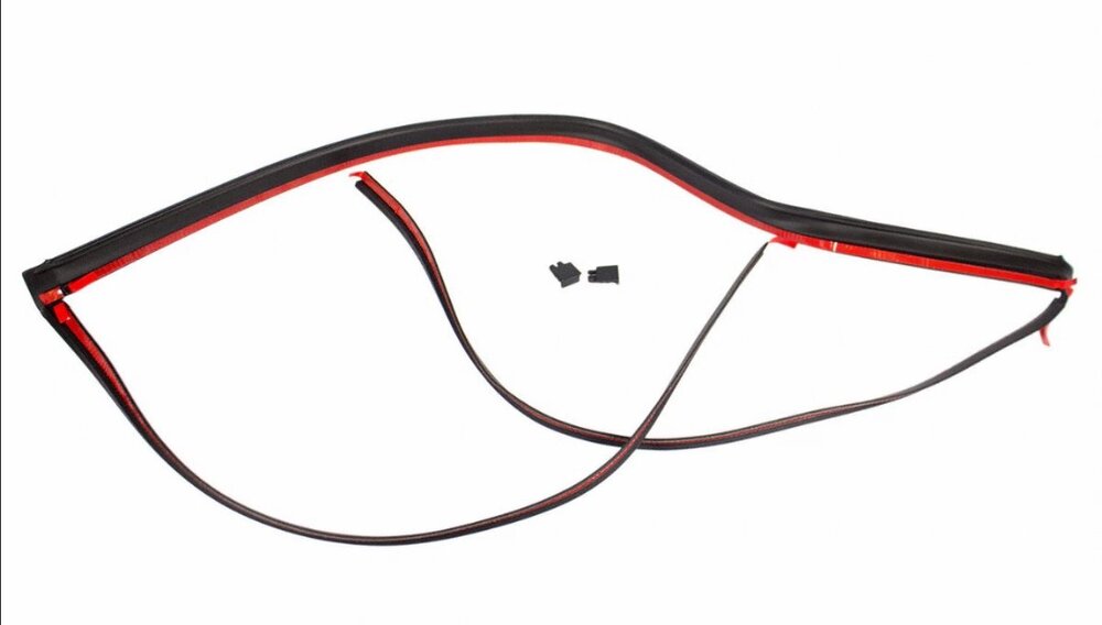

Haz Posted April 2 Report Share Posted April 2 @edgemaster: The 2009 Edge Workshop Manual provides the following illustration showing the Fixed Glass panel of your Edge's Panoramic Roof. You are describing the U-shaped Fixed Glass Front Seal (item 1), which along with the two Side Trim Seals (item 3) fill the gaps at the front and on the left & right sides of the Fixed Glass panel, where channels exist to drain water to the rear of the roof, where it flows out through the left & right side End Caps (item 7)... As you may already know, the waterproof sealing of the Fixed Glass panel is provided by a continual bead of urethane adhesive applied to the metal roof structure in the shape of Path 1 or Path 2, depending upon the model year of the Edge/MKX... Ford's parts-selling website offers photos of the Front seal which may be helpful, and which appears to show the red pull-off strip for double-sided tape used to affix the Front seal to the roof, underneath the outer edges of the Fixed Glass panel... Link to this FordParts webpage The Workshop Manual does not provide any procedure relating to removal and installation of the Front seal. If it did, I expect because of the minimal clearance between the Front seal's left-hand & right-hand side legs and the seals on the Side Trim pieces, the procedure might involve removal of the Fixed Glass panel by cutting the bead of urethane sealant, cleaning residue from the glass panel and the metal roof, then installing of the Front seal on the roof, apply the continuous bead of urethane sealant, and install the Fixed Glass panel, all of which would very likely involve a professional glass installer. Working clearances between the rear of the Moving Glass panel and the front of the Fixed Glass panel are greater, however, so if the Front seal is only deteriorated on the front, then it might be possible to cut the existing Front seal away from its side legs, and similarly cut the replacement Front seal after clearing away all remaining rubber from underneath the front edge of the Fixed Glass panel. I would say, before attempting any of this, it would be prudent to use a feeler gage to assess how much clearance or compression-on-the-seal exists between the bottom of the glass panel and the metal rooftop. If the double-sided-taped seal cannot be freely inserted and affixed underneath the front edge of the Fixed Glass panel, then I expect, services of a professional glass installer may be needed - at a much higher cost. Good luck! Roof Opening Panel Glass — Rear Fixed - Removal and Installation - 2009 Edge Workshop Manual.pdf Roof Opening Panel — Exploded View Illustrations - 2009 Edge Workshop Manual.pdf 2 Quote Link to comment Share on other sites More sharing options...
edgemaster Posted April 3 Author Report Share Posted April 3 Haz, thanks for the detailed response. I had ordered the manuals, they are on the way. It appears that the seal is only deteriorating at the front, so just replacing the front part might be possible. Hope that will work. 1 Quote Link to comment Share on other sites More sharing options...
