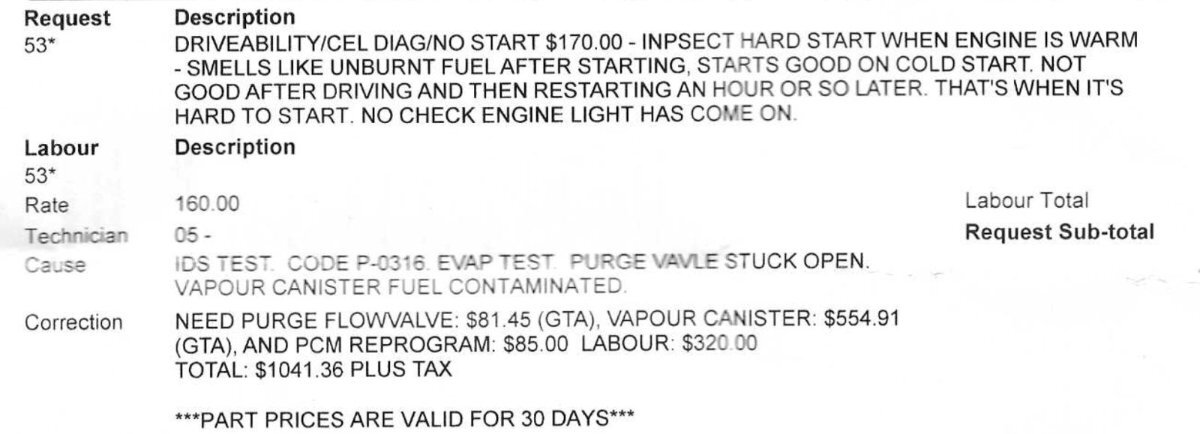

nomi Posted Tuesday at 11:00 AM Author Report Share Posted Tuesday at 11:00 AM (edited) I visited ford dealer few days ago for diagnonsis and this is the response I got. (But No Check Light) IDS TEST. CODE P-0316. EVAP TEST. PURGE VAVLE STUCK OPEN. VAPOUR CANISTER FUEL CONTAMINATED. PURGE VAVLE is replaced now but the issue is persistent. VAPOUR CANISTER FUEL CONTAMINATED is expensive so I am not doing it at this stage because I doubt it is the reason. (It has no corelation with Refueling) Why I said Engine coolant temperature sensor because it always start perfectly fine in the morning and also when I start immediately ( or ~5 min) after parking. When it is parked for around ~45 min and more then it takes time to start. Edited Tuesday at 11:03 AM by nomi Quote Link to comment Share on other sites More sharing options...
1004ron Posted Tuesday at 12:33 PM Report Share Posted Tuesday at 12:33 PM None of those codes or the engine temperature sensor would prevent the engine start. Puzzled why the Ford Dealership couldn't diagnose the issue. What did they report following their diagnosis? - did they confirm that the codes were unrelated to the no-start issue? If the no-start is repeatable with regards the 45 minute wait then you need to make them aware of that and they can diagnose accordingly - could be fuel rail pressure bleeding off. Another thing, is there any other info you haven't disclosed, such as the Ford Dealership doing diagnostics? Quote Link to comment Share on other sites More sharing options...
nomi Posted Tuesday at 07:41 PM Author Report Share Posted Tuesday at 07:41 PM (edited) Thank you very much @1004ron for your reply. This is the screenshot of the Ford Dealership diagnostics. please review Edited Tuesday at 07:42 PM by nomi Quote Link to comment Share on other sites More sharing options...
