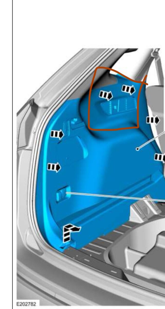

lasseventies Posted February 16 Report Share Posted February 16 (edited) Hi folks! I have a 2024 Edge with shy of 6k miles on it and I have being dealing with a rattling noise coming from the rear right cargo side panel. It starts at any highway after 50MPH. I tried (while some else driving) to press firmly and find something loose on the panel but no luck. Anyone with a similar rattle issue? Here is a link of the noise: https://drive.google.com/file/d/1HaITQXoBgTHu7FPjOpRTE688jWJ7naMY/view?usp=drivesdk Thank you very much in advance! Edited February 16 by 1004ron 1 1 Quote Link to comment Share on other sites More sharing options...

Haz Posted February 18 Report Share Posted February 18 Welcome to the Forum @lasseventies! As your highlighted illustration and your comment indicates, the rear seatbelt retractor lies beneath the trim panel, and it contains a pyrotechnic (mildly explosive) device to pretension the belt in event of a crash. Because your Edge is under warranty and within its Low Time In Service (LTIS) period, during which repairs are extensively documented and reported back to Ford, you really should contact your dealer to have a professional technician diagnose and correct the noise's root cause, which may be directly related to the seatbelt retractor assembly. Good luck! 2 Quote Link to comment Share on other sites More sharing options...

lasseventies Posted February 18 Author Report Share Posted February 18 9 hours ago, Haz said: Welcome to the Forum @lasseventies! As your highlighted illustration and your comment indicates, the rear seatbelt retractor lies beneath the trim panel, and it contains a pyrotechnic (mildly explosive) device to pretension the belt in event of a crash. Because your Edge is under warranty and within its Low Time In Service (LTIS) period, during which repairs are extensively documented and reported back to Ford, you really should contact your dealer to have a professional technician diagnose and correct the noise's root cause, which may be directly related to the seatbelt retractor assembly. Good luck! Yeah… you are right. I did make an appointment to take it to the dealership, but I am not quite sure if they’re gonna be helpful at all. 1 Quote Link to comment Share on other sites More sharing options...
