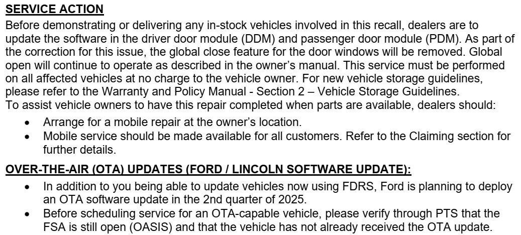

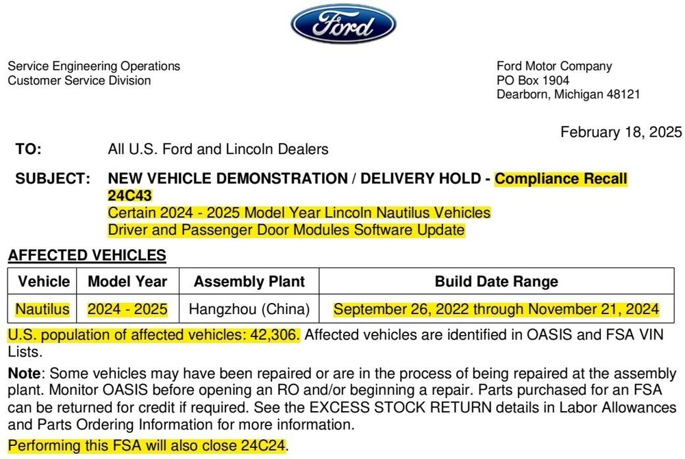

Compliance Recall 24C43 - Certain 2024-2025 Nautilus - Driver and Passenger Door Modules Software Update - USA & Canada
** The complete U.S. Dealer Bulletin has been released. The Canadian version will be posted when it is also released **

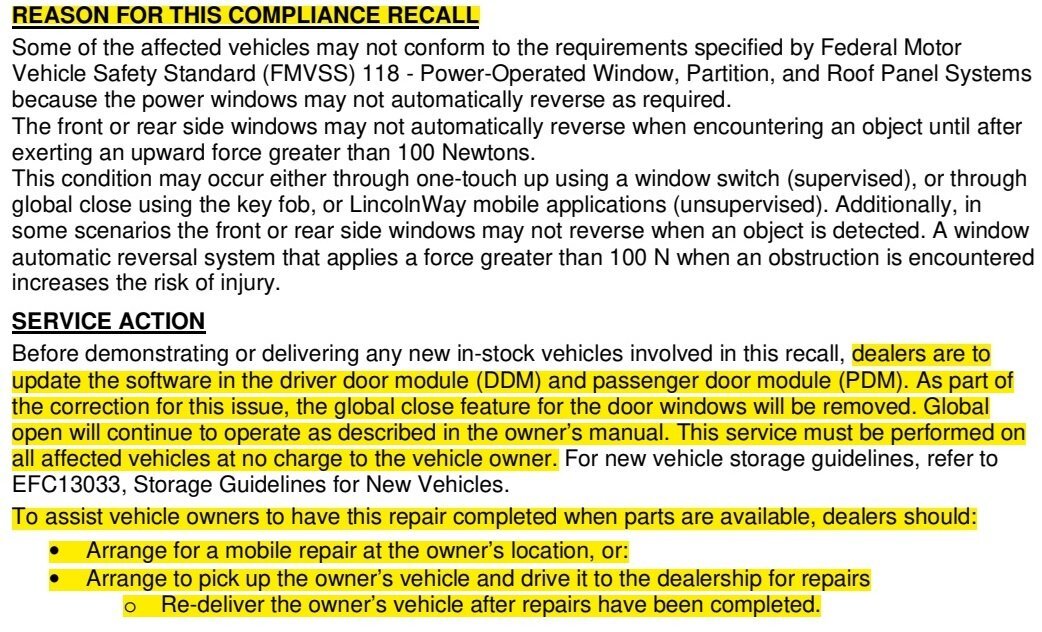

ComplianceRecall24C43-FULLDealerBulletin1A.thumb.jpg.b0305aa8ae01b0a83b6089cfb66b4139.jpgComplianceRecall24C43-FULLDealerBulletin1B.thumb.jpg.fef1c8520f8c34624457dc6bbbb47605.jpg
ComplianceRecall24C43-FULLDealerBulletin2.thumb.jpg.3f3db5f2666f7380862490772fbc41ee.jpg
ComplianceRecall24C43-FULLDealerBulletin3.thumb.jpg.de1c606742bb0707302b17150367cbdb.jpg
ComplianceRecall24C43-OwnerReimbursement.thumb.jpg.eb7c885932e1542e10718fab8f172720.jpg
Compliance Recall 24C43's service procedure is described in the Technical Instructions attached below as a PDF document...

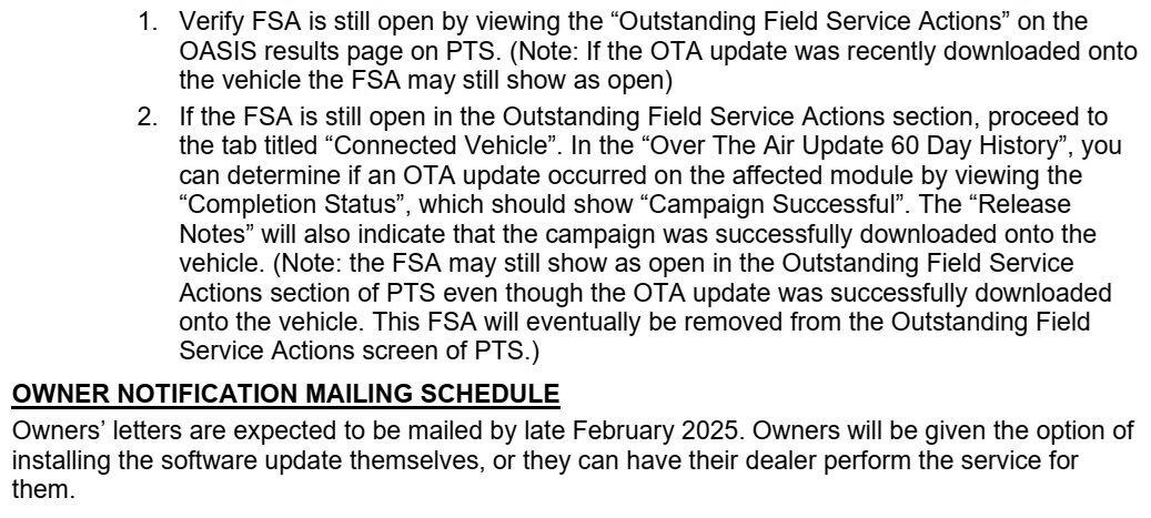

Not sure if you read the post above yours?
It's still the 1st quarter of 2025.

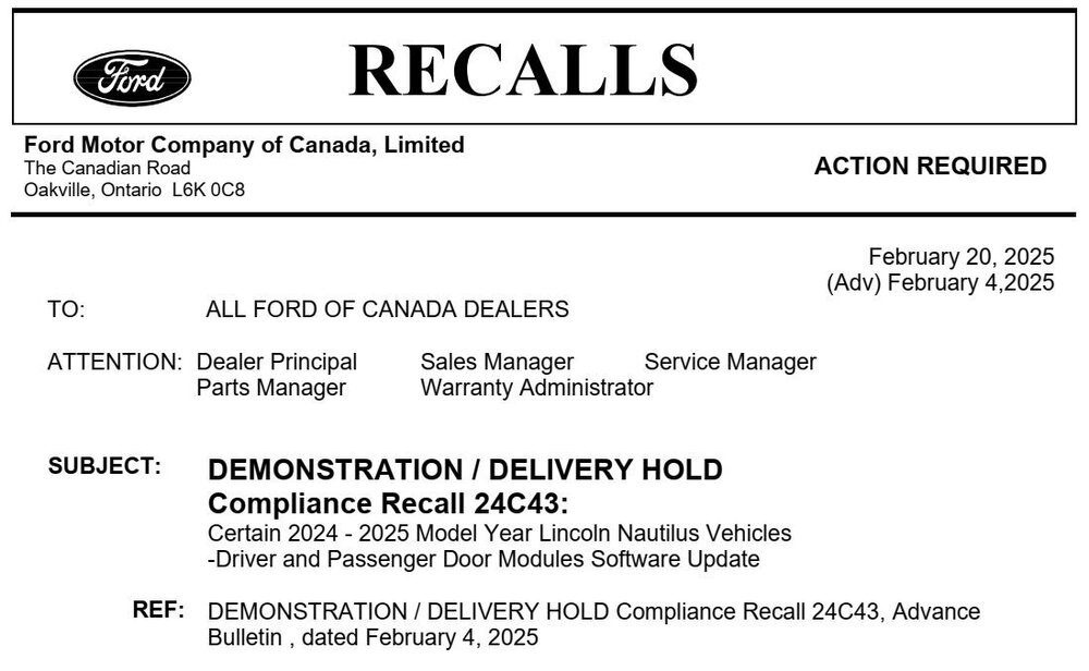

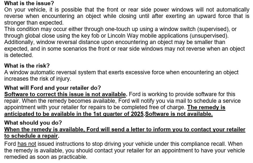

** The complete Canadian Dealer Bulletin and tentative Letter to Owners have been released. Technical Instructions are identical **
ComplianceRecall24C43-FordofCanada-FullDealerBulletin1A.thumb.jpg.77a499083daded4e63dd643dc86b4e7c.jpgComplianceRecall24C43-FordofCanada-FullDealerBulletin1B.thumb.jpg.0599abacca504dc945e46c3f13f4c95b.jpgComplianceRecall24C43-FordofCanada-FullDealerBulletin2A.thumb.jpg.0170ba4fa95ec077dcf76a935ac75a04.jpgComplianceRecall24C43-FordofCanada-FullDealerBulletin2B.thumb.jpg.56fb6f7251e331e795762aa35a24ea09.jpgComplianceRecall24C43-FordofCanada-FullDealerBulletin3.thumb.jpg.e960946510439bcb6107c7e6e67a9d8f.jpgComplianceRecall24C43-FordofCanada-FullDealerBulletin4.thumb.jpg.48848a3a634680c88519e77c24055a44.jpgComplianceRecall24C43-FordofCanada-FullDealerBulletin5.thumb.jpg.1b13f7c4838a4cb2df26ffa19827b489.jpg
Tentative Letter To Owners
ComplianceRecall24C43-FordofCanada-OwnerLetterNoSoftwareAvailable1A.thumb.jpg.328ca76eb57801b78908abd07796f4cd.jpgComplianceRecall24C43-FordofCanada-OwnerLetterNoSoftwareAvailable1B.thumb.jpg.de9b8a7708534a7f6322e449d5c885ae.jpgComplianceRecall24C43-FordofCanada-OwnerLetterNoSoftwareAvailable2.thumb.jpg.953db3402d2bc7eeea937bc0c2e5b44d.jpg
