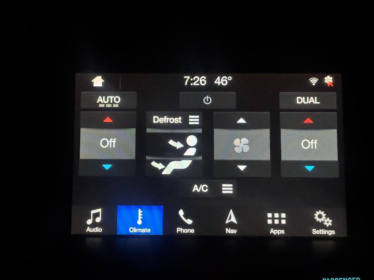

Mustang 11111 Posted Tuesday at 03:41 PM Report Share Posted Tuesday at 03:41 PM I have a 2013 ford edge sel with dual climate I have upgraded it from the sync 1 to sync 3 with all the parts from eBay and bought a harness from intelligentonetech and the buttons on the screen work with the climate but it just doesn’t display the current settings like the temperature it’s set at or the fan speed. Thank you very much! I am attaching a picture of the climate screen. 1 Quote Link to comment Share on other sites More sharing options...
Mustang 11111 Posted yesterday at 04:43 AM Author Report Share Posted yesterday at 04:43 AM Does any one have any ideas 1 Quote Link to comment Share on other sites More sharing options...

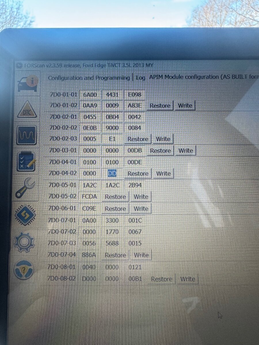

Mustang 11111 Posted 18 hours ago Author Report Share Posted 18 hours ago I bought the sync 3 apim from eBay so I had to program it myself. I just got to figure out what codes are wrong . 1 Quote Link to comment Share on other sites More sharing options...
Wubster100 Posted 16 hours ago Report Share Posted 16 hours ago (edited) Can you post your AsBuilt data? Please upload it as a .ab file. Edited 16 hours ago by Wubster100 Quote Link to comment Share on other sites More sharing options...
Mustang 11111 Posted 2 hours ago Author Report Share Posted 2 hours ago I have it on my phone I don’t got access to it right now to plug in but i took a picture of it. Quote Link to comment Share on other sites More sharing options...
