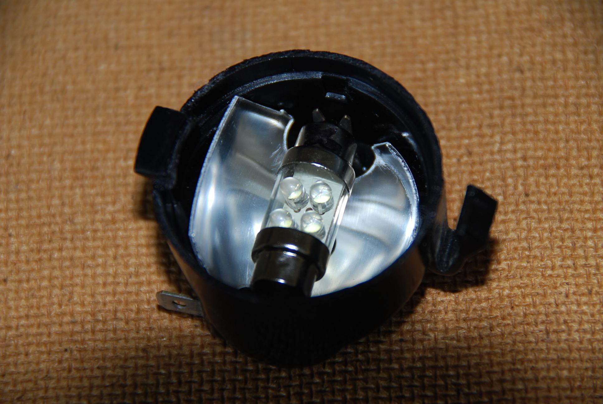

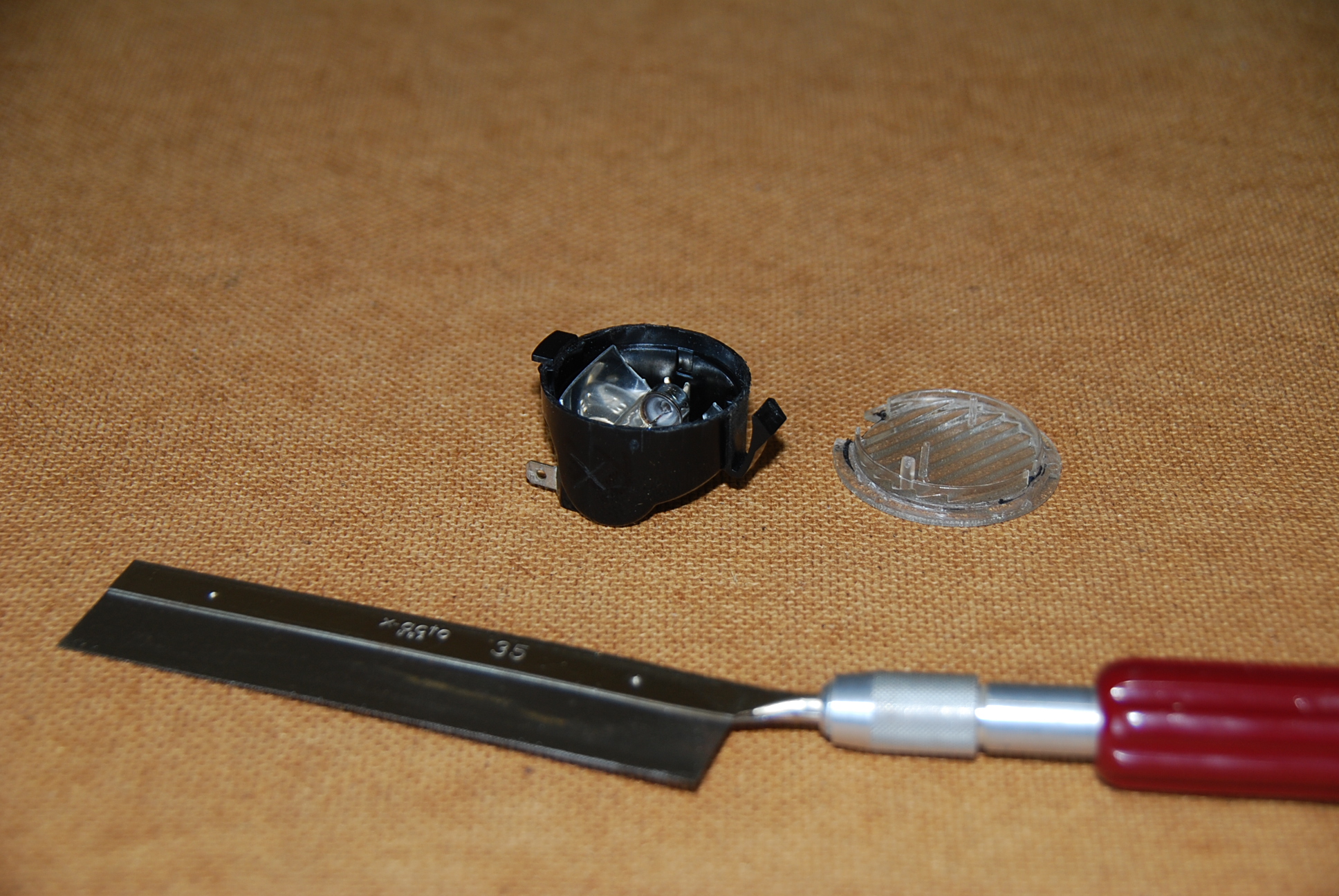

dadrett Posted March 24, 2009 Report Share Posted March 24, 2009 (edited) Bits of this are scattered about elsewhere, but here’s some new too. For those wanting to install LEDs in U’r puddle lamps, but are reluctant to try :unsure: because of cost to replace damaged original, here's good news. Least expensive I’ve found is from Tasca Ford in Cranston, RI. (http://www.tascafordparts.com//index.do) Got dealer’s name & part number (3F1Z-13B375-AA) on an F-150 forum. Apparently this is an F-150 number, but I called Tasca & part is same for Edge. Cost $26.13 + $10.00 S&H. Now U can cut one apart :yup: knowing it can be replaced somewhat reasonably. The F-150 poster talked about using razor saw to separate lens from body. I think U have better control than with a rotary tool. I used an Exacto razor saw with .008 in. blade. Put lamp in vise with lens against one jaw. Cushion jaws with tape, close on lamp gingerly & rotate unit as U cut. Sawing with U’r hand on back of blade with saw turned backward & pulling toward U gives better control. (Japanese saws have teeth pointing backwards & cut on the backstroke. If U’ve never used such a saw, try it if U have a chance). Be patient. The cut will be about 1/16” deep & when U think cut is complete, gently worry the two pieces apart by prying with small screwdriver. While prying, if U come to a spot where U don’t see any movement U probably need to cut some more in that area. U won’t be able to cut at big black tab, but if U’r gentle, lens will crack :blink: (yes, I said crack) away from body. A word of caution. The second one goes so much faster (10 mins) than first (50 mins) that U need to check frequently to see if U’r cut is deep enough without going so deep that U cut into lip on clear lens. Reflector removal depends on U’r LED bulb. Bulb (from eBay seller EnKMall) is 8.15 mm x 31 mm. Cost $7.98/pr., free S&H. Even though only 4 LEDs, it's quite good, but hard to tell by pic. I'm guessing quality & intensity of color a little strange due to ambient light. Maybe should try in a very dark parking lot. Edited May 1, 2009 by dadrett Quote Link to comment Share on other sites More sharing options...

dadrett Posted January 5, 2012 Author Report Share Posted January 5, 2012 Does the LED bulb you used have another set of 4 LEDs on the back side? I can't tell by the photo of the bulb installed in the assembly. No, the bulb has only the four LEDs U see. Surprisingly, the light output is quite good. It seems that enkmall (eBay) still sells these @ $6.38/pr. free S&H. Quote Link to comment Share on other sites More sharing options...
dadrett Posted January 5, 2012 Author Report Share Posted January 5, 2012 Question: are there ribs protruding from the underside of the lens or is the underside lens surface flat?I want to make sure I don't cut in too deeply and damage these ribs (if they are protruding). Look @ first pic in Post #1 Quote Link to comment Share on other sites More sharing options...
