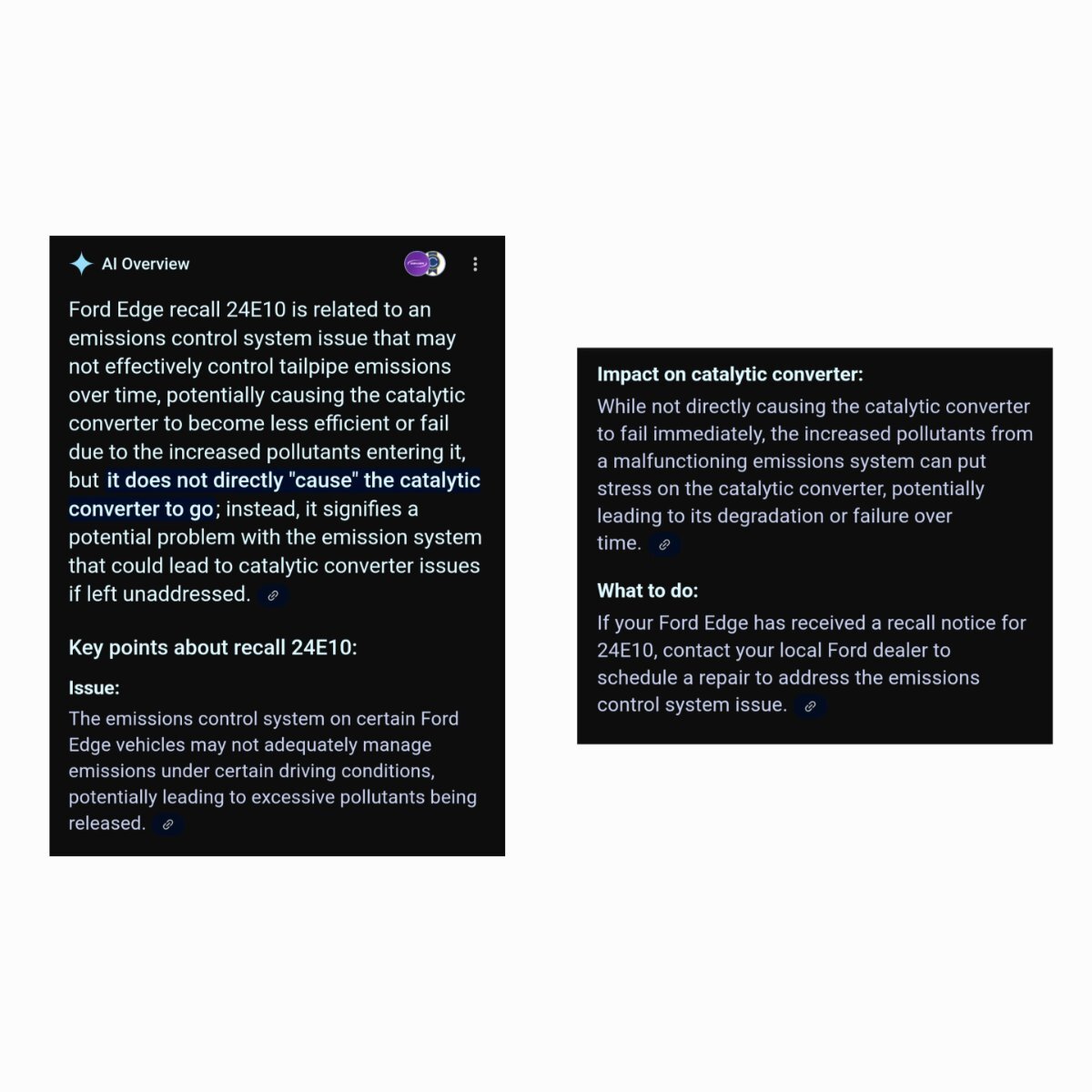

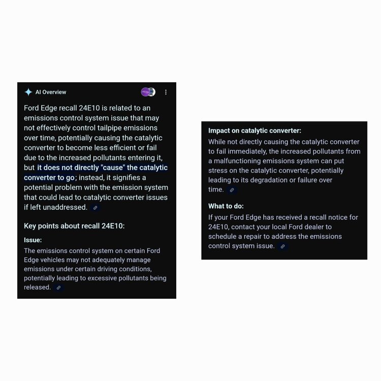

Cobra4fun Posted December 2, 2024 Report Share Posted December 2, 2024 On 11/27/2024 at 8:59 AM, Jaime MUN said: 2015 Ford Edge here. Same recall notice received! I could not pass emissions and I had no choice but to replace both cats and sensors, in order to pass. Exactly one week after passing emissions, I received a recall notice in the mail. I was wondering if it was only me but now I'm seeing there are many other owners with the same issue. I paid $2,500 to have the issue repaired, because I had not choice as I couldn't renew my plate sticker without first passing emission. I call Ford's customer care department and the customer service rep informs me there is no reimbursement for this repair!!! She goes on to tell me that Ford will usually allow reimbursement in these cases but for some reason not on this particular recall- she tells me she's surprised! So I asked to escalate my call and submit it as a complaint. I'm now waiting to hear back from someone else. I'm ready to bring in the media, especially after learning Ford just got hit with the second most disgust penalty last week, for their terrible recall practices. If you guys are going to the same, start calling and getting you cases heard. We spend way too much money on these vehicles and Ford basically doesn't give a damn! I was wondering why our Catalytic converters are failing in our Edges at relatively low mileages. In my case 139K miles!!!! Now I think we know why after this recall! PCM was likely over richening the fuel to air ratio and damaging the converters over time and leading to higher emissions out the tailpipes. $2500 is a lot of money but if you paid that to replace both catalytic converters and O2 sensors that was fairly inexpensive for that repair. I was quoted over $3500 for replacing both Catalytic converters in our 2018 Edge with a 3.5L. Regardless, FORD screwed up here with the PCM programming and that resulted in the higher emissions and irreversible damage to the catalytic converters. FORD should be covering the converter replacements too. Come on FORD!!! 1 Quote Link to comment Share on other sites More sharing options...
Cobra4fun Posted December 2, 2024 Report Share Posted December 2, 2024 (edited) 3 hours ago, kmallen said: My engine light is on; error is basically catalytic converter. Service guy states the recall should not have anything to do with my engine light error. But everything I have found researching states it could make it fail over time. Car has 195k miles on it; I would say that qualifies as 'over time'. Yep!!! Please keep us posted on this! Please also keep on them and make them fix the issue. What the service guy said sounds completely false. The fact that the PCM needs to be reprogrammed to lower the emissions means that there are times when too many pollutants are being generated that overwhelms the catalytic converters and they are getting prematurely contaminated and eventually failing. They are prematurely failing due to the PCM programming settings the factory messed up from the get go. IF they refuse to completely fix the issue with replacing new CATs, at a minimum get the service manager to put his words all in writing with his name on the service record. Tell him/her you want them to document this recall "has absolutely no impact on that Engine Light (Should be a P0420 or P0430) on the Catalytic Converters premature degrading/failing. I bet he will refuse to do it, but then say if he won't put it in writing, you'd like your converters replaced since the PCM controls the pollutants that go to the catalytic converters and need to be burned off. Edited December 2, 2024 by Cobra4fun Quote Link to comment Share on other sites More sharing options...
