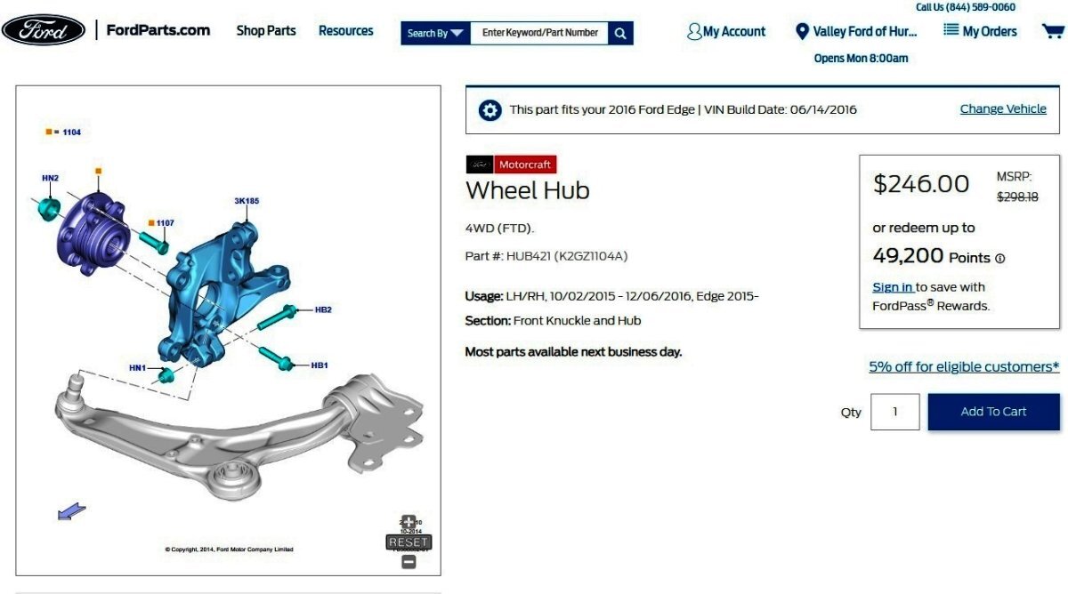

Haz Posted November 17, 2024 Report Share Posted November 17, 2024 (edited) Regardless of this Wheel Hub's AWD descriptor, using the VIN of a 2016 FWD Edge on Ford's parts-selling website resolves it as fitting FWD also... Link to this FordParts webpage Perhaps the following high-resolution (1500 x 1500) FordParts-linked images can reconcile your question with the Mechanic's comment... Good luck! Edited November 17, 2024 by Haz 2 Quote Link to comment Share on other sites More sharing options...
