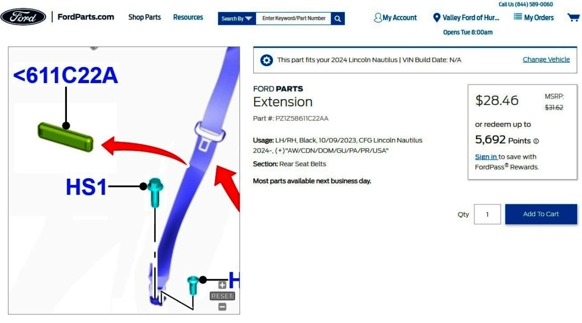

Parts
Service Part Number Claim Quantity Package Order Quantity Number in Package Description
PZ1Z-58611C22-AA 2 2 1 Seatbelt Clip

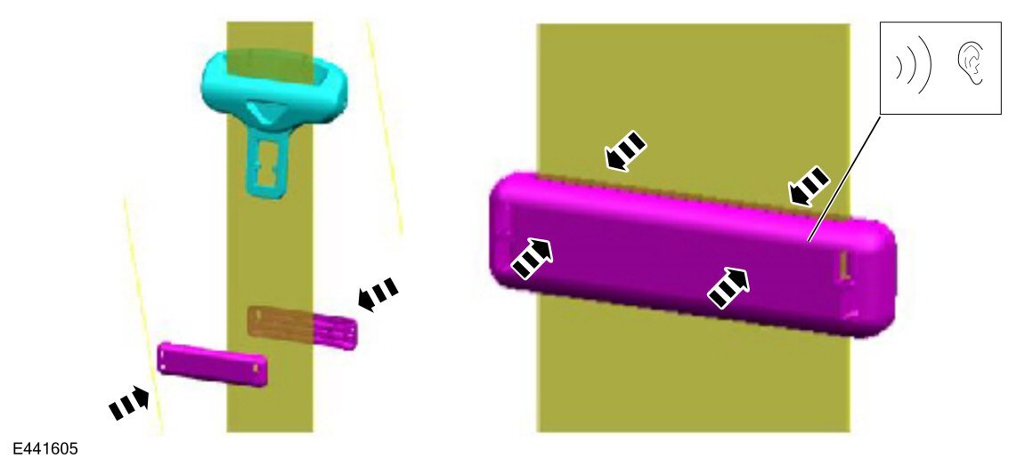

1. Snap together and lock both seat belt clip halves over seat belt. (Figure 1)
Figure 1

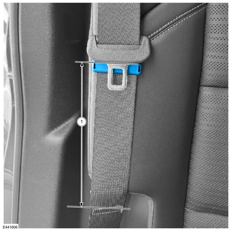

2. Slide clip and belt tongue upwards together along belt webbing until it contacts the belt tongue, and then upwards approximately 6 in. (150 mm).
3. Confirm the seat belt tongue is now 6 in. (150 mm) higher than the previously stowed position. Adjust seat belt tongue position again if necessary to achieve this distance. (Figure 2)
Figure 2
4. Verify the seat belt tongue is now free from contacting either rear interior door panel and/or C-pillar molding.
