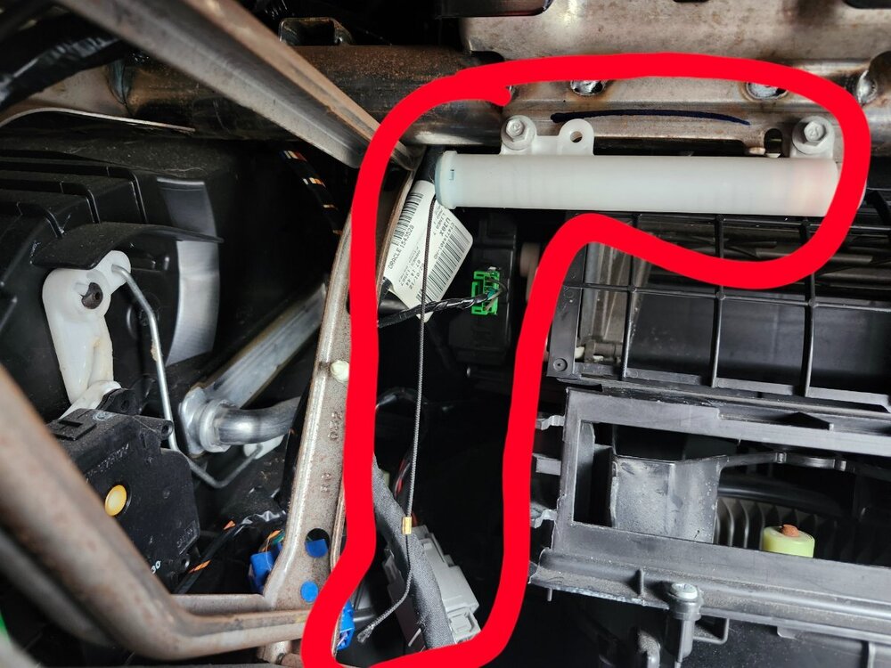

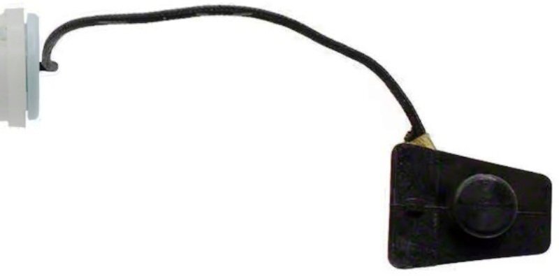

senciner Posted November 10, 2024 Report Share Posted November 10, 2024 Trying to figure out what this wire may have been connected to. Wash checking blower motor since it was getting loud. But noticed that loose wire or cord and not sure if it was supposed to be connected to anything Quote Link to comment Share on other sites More sharing options...

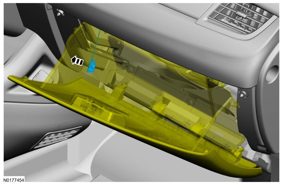

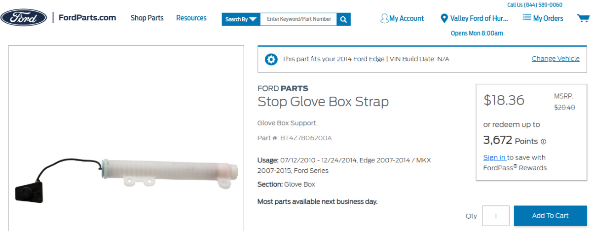

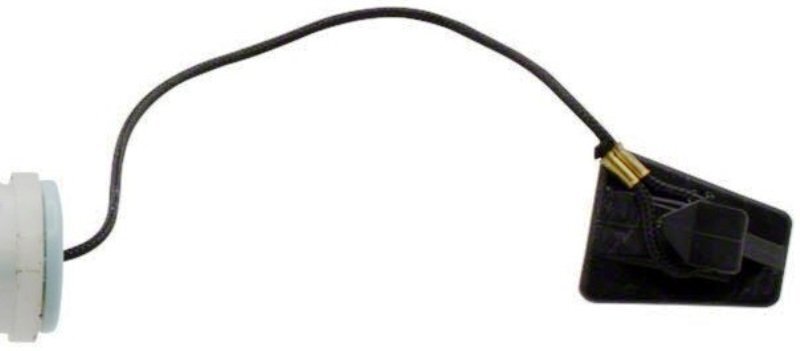

Haz Posted November 10, 2024 Report Share Posted November 10, 2024 (edited) Welcome to the Forum @senciner! Link to this FordParts webpage The above-shown black plastic fitting -- which should be on the crimped metal cylinder shown in your photo on the frayed-end woven cord -- attaches to the glove compartment door to dampen its downward movement... Good luck! Edited November 10, 2024 by Haz 2 Quote Link to comment Share on other sites More sharing options...
senciner Posted November 10, 2024 Author Report Share Posted November 10, 2024 Ah, thank you just realized it. Having a hard time reattaching it to it. Quote Link to comment Share on other sites More sharing options...

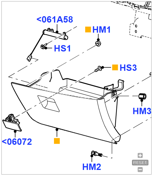

Haz Posted November 10, 2024 Report Share Posted November 10, 2024 Additional reference imagery... Good luck! 1 Quote Link to comment Share on other sites More sharing options...
