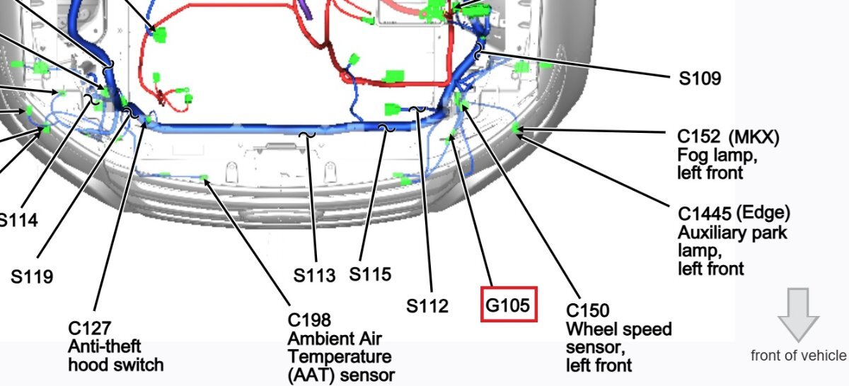

Superhawk Posted October 30, 2024 Report Share Posted October 30, 2024 I'm new to this forum and have a question about the drivers side headlight harness burning up and then the headlight does not work. I've replaced the harness twice now and burns up in days. I think I have a bad ground and would like to know where the ground terminates to do load tests there. I'd like to know where I can find G105 10-3 ground termination. Any help would be appreciated. Allen Quote Link to comment Share on other sites More sharing options...

Haz Posted October 30, 2024 Report Share Posted October 30, 2024 (edited) Welcome to the Forum @Superhawk! Additional informational attached below as PDF documents... Good luck! Ground G105 Location - Left Front Between S112 & C150 In Illustration - 2012 Edge.pdf Ground G105 - Wiring Diagram - 2012 Edge.pdf Edited October 30, 2024 by Haz 1 Quote Link to comment Share on other sites More sharing options...

Superhawk Posted October 31, 2024 Author Report Share Posted October 31, 2024 Thanks a million for these diagrams Haz. I hope I can make heads of this tomorrow, to figure out why the 2 wire 9012 lamp harness connection is burning up. I now know the BK-GN is the ground and BN-BL is power. Extremely helpful. Quote Link to comment Share on other sites More sharing options...
Superhawk Posted November 23, 2024 Author Report Share Posted November 23, 2024 As a follow up. I replaced the harness to the headlight once again. I found the ground side (BK-GN) of the harness was melting the connector. I removed the 10mm nut of the grounding stud and sanded the paint off around it and reinstalled the ground wires. Headlight is still working after 4 weeks. Thanks to Haz and his diagrams for helping me solve this issue on the wife's Edge. 1 Quote Link to comment Share on other sites More sharing options...
