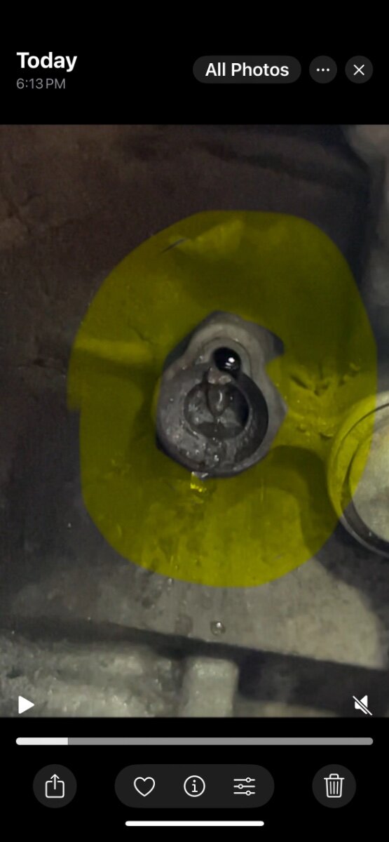

I am doing some engine work on this vehicle. It does have a blown head gasket. I do t really know what caused it.  However it will not hold water. I add water to find out where the water leads to. Found the leak behind the alternator. I pulled the alternator and I couldn’t physically see it cause there is not enough room to get my head down there. I was able to take a picture of it. And I will attach it. I believe it is a freeze plug or something similar but I can’t find any information about it. I see it on other engine blocks but it looks the same on all of them. Anyway if anyone can help I would be very grateful.
What is the name of the part?
What does it do?
is there a part number?
thanks in advance
gilldogg.

That is one of the passages from the internal seal for the water pump. If the bearing/seal on the pump leaks it will first go through that passage to exit the block/front cover. Make sure you check your oil for water, and get it fixed before the other seal fails and coolant/water goes into the crank case, which will wipe out the entire engine quickly.
What indications are you seeing that it is a head gasket? Combustion/pressure test of the cooling system? A cylinder with coolant in it? Just losing coolant?
While it is a lot of work to replace the water pump, it is easier than the head gasket(s).
Edited by dabangsta
dabangsta thanks for the info. Yes it was assumed the head gasket blew because of the peanut butter oil. lol,
I suspect now since your info and other items I have found , the head gasket may be ok.  I will do a compression test and if all is good I will look at doing the timing and water pump replacement.  What’s your thoughts?
