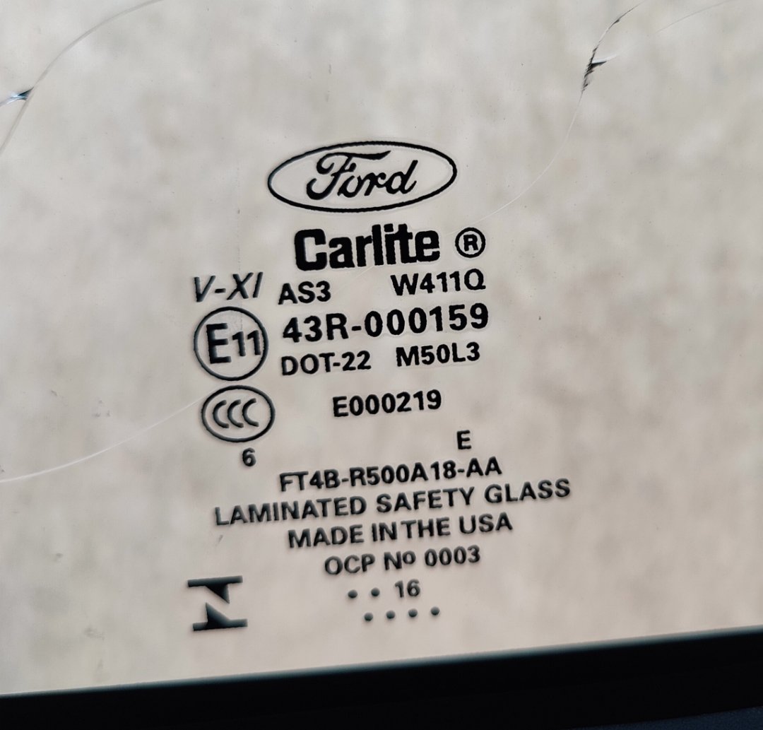

omar302 Posted October 20, 2023 Report Share Posted October 20, 2023 Sorry to hear that. Is the replacement glass tempered glass or laminated? 1 Quote Link to comment Share on other sites More sharing options...
normkol Posted November 2, 2023 Report Share Posted November 2, 2023 I don't know, I looked for markings on the glass but didn't see any. Quote Link to comment Share on other sites More sharing options...
omar302 Posted November 11, 2023 Report Share Posted November 11, 2023 On 11/2/2023 at 4:04 PM, normkol said: I don't know, I looked for markings on the glass but didn't see any. On the glass, center of the rear edge from the inside it can be seen. It is supposed to readable from the outside, so on the inside the text will be mirrored (flipped). Attached is what mine states (2016 original), "laminated safety glass". Newer models stared using "Tempered glass". 1 Quote Link to comment Share on other sites More sharing options...
normkol Posted November 17, 2023 Report Share Posted November 17, 2023 Your are right, sorry for taking the picture from inside the car, I have trouble getting to the top. Is is tempered, not laminated. 2 Quote Link to comment Share on other sites More sharing options...
