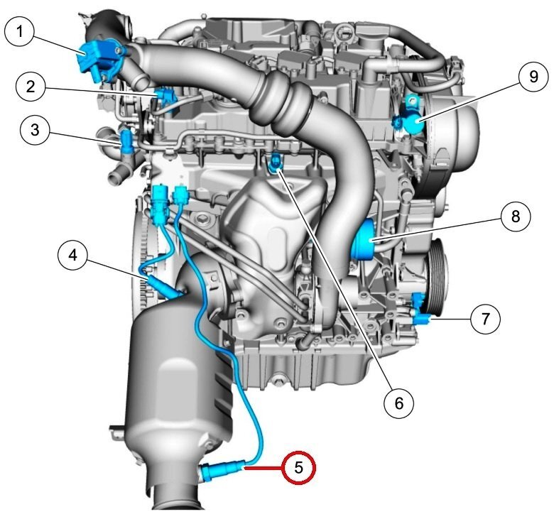

Haz Posted October 16, 2024 Report Share Posted October 16, 2024 @kevin kogut: As before, attached below as PDF documents are relevant sections from the 2019 Escape Workshop Manual... Please be aware that some numbered action-step descriptions may appear at the bottom of the page before the illustration to which it applies. 1.5L EcoBoost Engine Item Description 1 Turbocharger bypass valve solenoid 2 CMP sensor RH exhaust 3 ECT sensor 4 HO2S 5 Catalyst monitor sensor 6 CHT 2 (CHT2) sensor 7 CKP sensor 8 Wastegate actuator 9 VCT oil control solenoid exhaust Good luck! Catalyst Monitor (Oxygen) Sensor - 1.5L EcoBoost - Removal and Installation - 2019 Escape Workshop Manual.pdf Air Cleaner Outlet Pipe - 1.5L EcoBoost - Removal and Installation - 2019 Escape Workshop Manual.pdf Battery Tray - 1.5L EcoBoost - Removal and Installation - 2019 Escape Workshop Manual.pdf Exhaust Gas Oxygen Sensor Socket - Rotunda Part Number 303-476.pdf 1 Quote Link to comment Share on other sites More sharing options...
