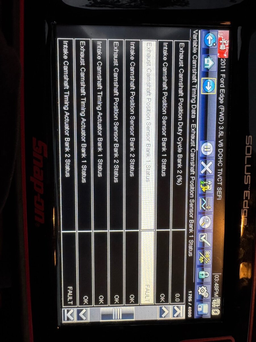

mlundyy Posted Sunday at 09:32 PM Report Share Posted Sunday at 09:32 PM So a couple months ago our car started to shutter very bad going up hills as if it didnt have enough power, check engine light was blinking. took it home and tried digging into it. scan tool showed multiple misfires on 1,2, and 3 cylinders and showing a P0365 "camshaft position sensor B circuit (bank 1). tried to replace it and now you have to hold your foot at 2000 rpms to keep it from stalling. dug into the wiring and im getting my 12v to both connectors, ohm tested both camshaft sensors (both show 1.2 killa ohms. im stuck and not sure what to do. Quote Link to comment Share on other sites More sharing options...
