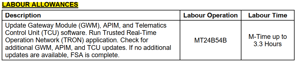

Bunky Posted Thursday at 09:12 PM Report Share Posted Thursday at 09:12 PM (edited) Haz, can you elaborate on what the TRON does? Edited Friday at 10:24 AM by Bunky 1 Quote Link to comment Share on other sites More sharing options...
Haz Posted 20 hours ago Author Report Share Posted 20 hours ago This is the first reference to Trusted Real-Time Operating Network (TRON) that I've seen. I'm aware that an update to the Ford Diagnosis and Repair System (FDRS) was recently released. so TRON may be a new app running within FDRS used to perform certain tasks. The name suggests that it facilitates communication, so hopefully, FDRS diagnostics and module updates have been improved. Good luck! 1 Quote Link to comment Share on other sites More sharing options...

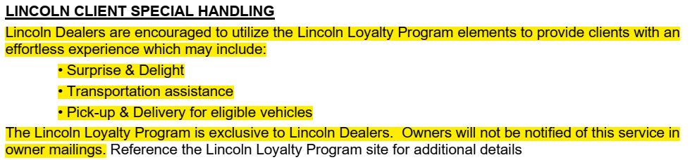

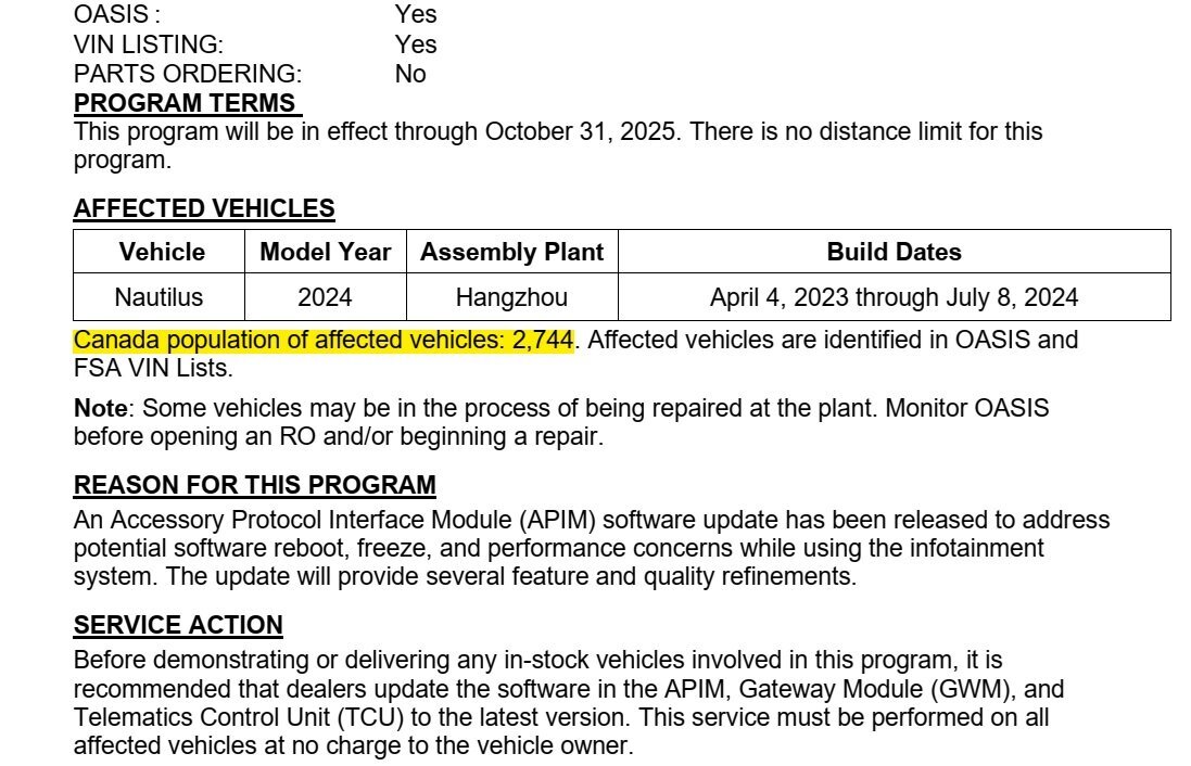

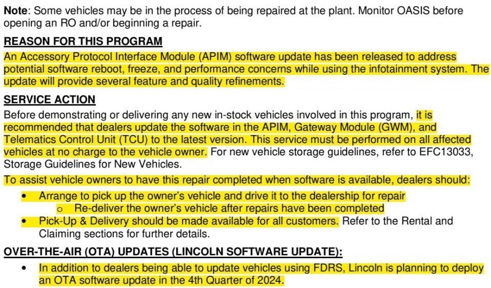

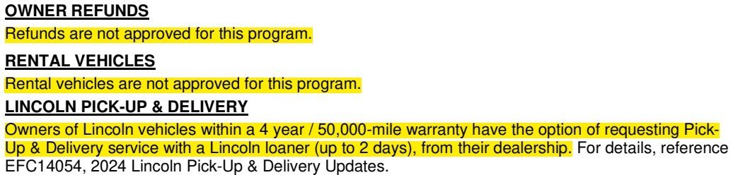

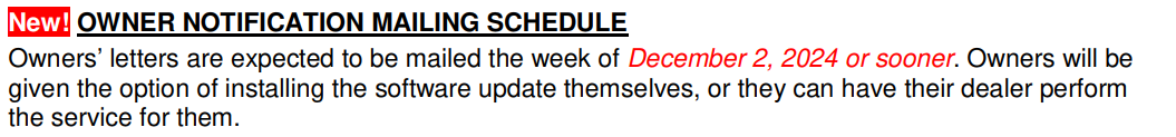

Haz Posted 19 hours ago Author Report Share Posted 19 hours ago Ford of Canada's Customer Satisfaction Program 24B54 Announcement and Dealer Bulletin details... 2 Quote Link to comment Share on other sites More sharing options...
