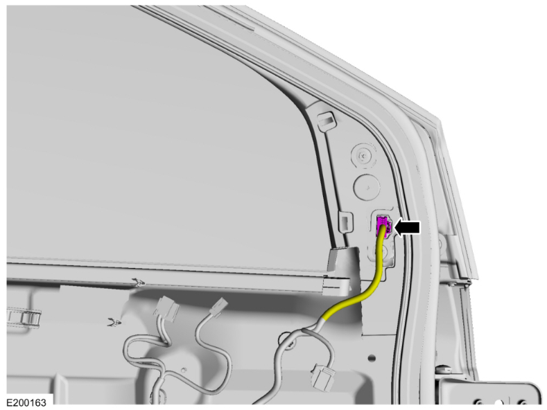

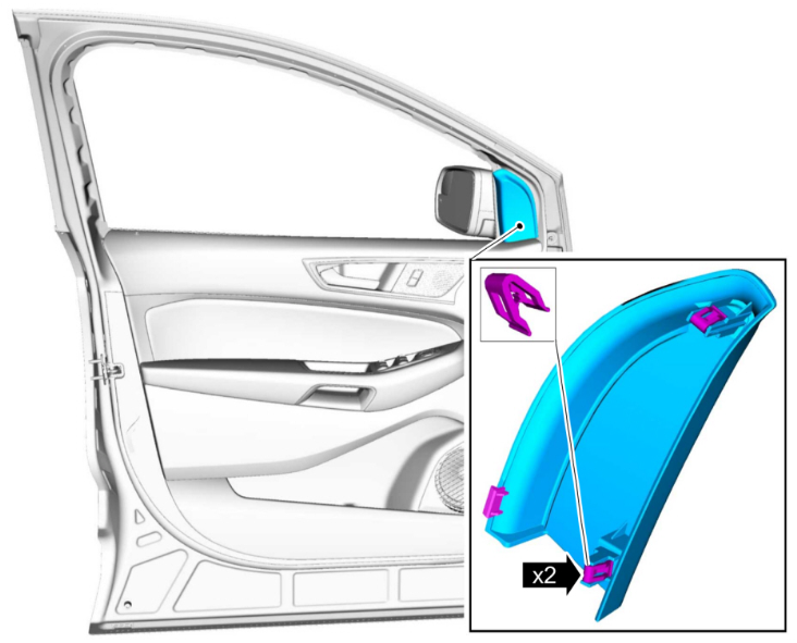

Haz Posted September 29, 2024 Report Share Posted September 29, 2024 If the Heated Rear Window tests as enabled/operable, then to test if Exterior Mirror Heat is enabled/operable... A2 CHECK THE LEFT HAND (LH) AND RIGHT HAND (RH) EXTERIOR MIRROR HEAT VOLTAGE Ignition OFF. Disconnect: Exterior Mirror Electrical Connectors C516 (LH) and C601 (RH). NOTE: LH side shown, RH side similar. Release the clips and remove the sail panel. Disconnect the exterior mirror electrical connector. Start the engine. Activate the rear window defrost switch. Measure: Positive Lead Measurement / Action Negative Lead C516 (LH) Pin 2 and C601 (RH) Pin 2 Ground Is the voltage greater than 11 volts? Relevant 2020 Edge exterior mirror information is attached as below as PDF documents... Good luck! Heated Mirrors - Wiring Diagram - 2020 Edge.pdf Exterior Mirror, LH - Connector C516 Location - 2020 Edge.pdf Exterior Mirror, LH - Connector C516 Pinout - 2020 Edge.pdf Exterior Mirror, RH - Connector C601 Location - 2020 Edge.pdf Exterior Mirror, RH - Connector C601 Pinout - 2020 Edge.pdf Exterior Mirror - Removal and Installation - 2020 Edge Workshop Manual.pdf 1 Quote Link to comment Share on other sites More sharing options...
