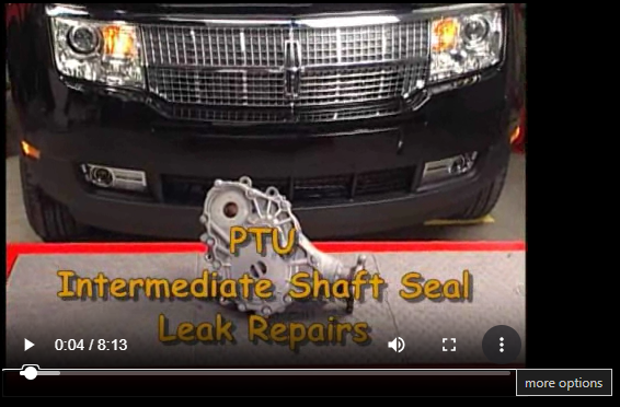

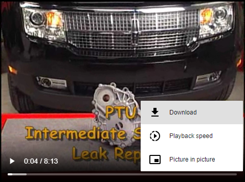

Haz Posted September 26, 2024 Report Share Posted September 26, 2024 Welcome to the Forum @rans! You are referring to the Intermediate Shaft Seal and its Dust Shield in your Edge's Power Transfer Unit (PTU). Workshop Manual descriptions and procedures relevant to these components are attached below as PDF documents... Clicking on the following links will lead to the described resource: Ford Service Video - Describes removal and installation procedure for Intermediate Shaft Seal and Dust Shield Special Tool - Halfshaft Remover Special Tool - PTU Intermediate Shaft Seal Installer Special Tool - PTU Intermediate Shaft Dust Shield Installer Please be aware that the online Ford Service Video player provides a lower right-hand corner menu button to download the video file, allowing direct viewing of the video procedure on a smartphone or tablet while performing the procedure... Good luck! Intermediate Shaft — All Wheel Drive (AWD) - Removal and Installation - 2007 Edge Workshop Manual.pdf Intermediate Shaft — All Wheel Drive (AWD) - Removal and Installation - ENANCED IMAGE - 2007 Edge Workshop Manual.pdf Intermediate Shaft Seal and Deflector - Power Transfer Unit (PTU) - In Vehicle Repair - 2007 Edge Workshop Manual.pdf Halfshaft — RH - Removal and Installation - 2007 Edge Workshop Manual.pdf Four Wheel Drive (4WD) Systems - Description and Operation - 2007 Edge Workshop Manual.pdf Front Drive Halfshafts - Description and Operation - 2007 Edge Workshop Manual.pdf Driveline System - Description and Operation - 2007 Edge Workshop Manual.pdf 2 Quote Link to comment Share on other sites More sharing options...
