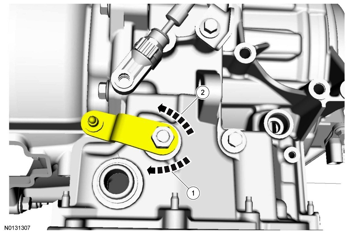

Are you certain the cable-end locking clip is fully engaged after you mount the shifter cable onto the ball stud of the manual shifter lever, as depicted below?...

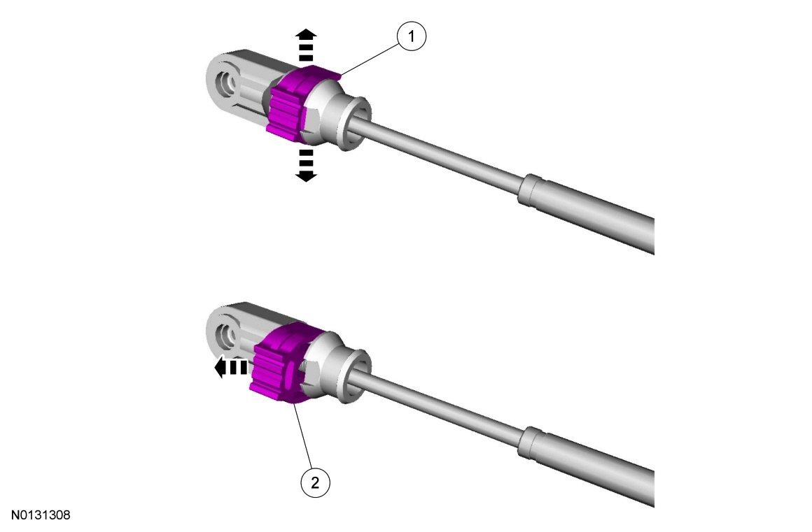

  1. Carefully pry outward the adjuster lock tabs.
  1. While holding the adjuster lock tabs outward, slide the lock to unlock the selector lever cable...

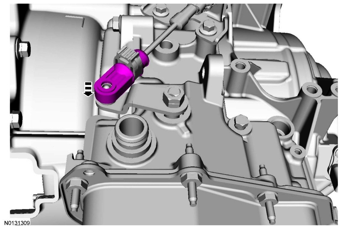

NOTICE: To prevent selector lever cable damage, do not apply force to the selector lever cable between the manual control lever and the selector lever cable bracket.
NOTE: Make sure that the selector lever cable end is correctly installed onto the manual control lever ball stud by pulling back on the selector lever cable end...
InstallingShiftCableEndonManualShiftLever-6F35Transmission-Illustration-2013EdgeWorkshopManual.thumb.jpg.398bdce2e17e2ede5534e61cbee10770.jpg

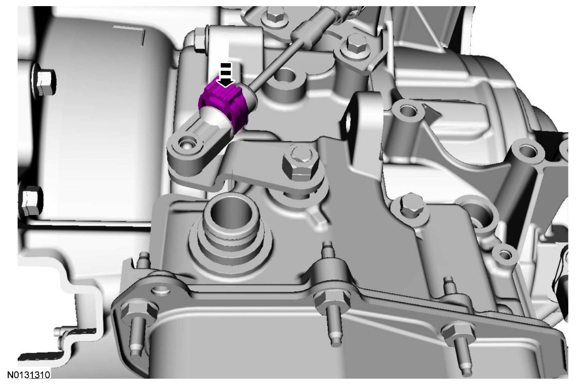

NOTE: After locking the adjuster, pull back on the adjuster to make sure it is securely installed...
SettingLockingClipOnShiftCableIntoLockedPosition-6F35Transmission-Illustration-2013EdgeWorkshopManual.thumb.jpg.a6f5c0087a28e7c32ae5c95577da13ad.jpg
