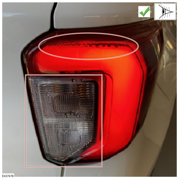

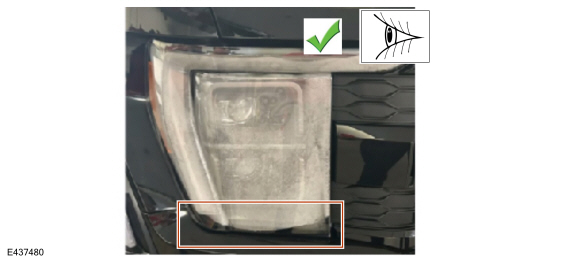

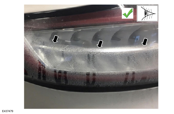

Haz Posted September 10, 2024 Report Share Posted September 10, 2024 @Wubster100: Your Edge might qualify for a warranty replacement. From General Service Bulletin 24-7068 - Various Vehicles - Exterior Lighting Concern Analysis... Examples Of Water Leaks (Figures 6-8) - Warrantable Figure 6 - example of water leak (large droplets) - warrantable Figure 7 - example of water leak (streaking) - warrantable Figure 8 - example of water leak (pooling at bottom) - warrantable Good luck! 4 Quote Link to comment Share on other sites More sharing options...

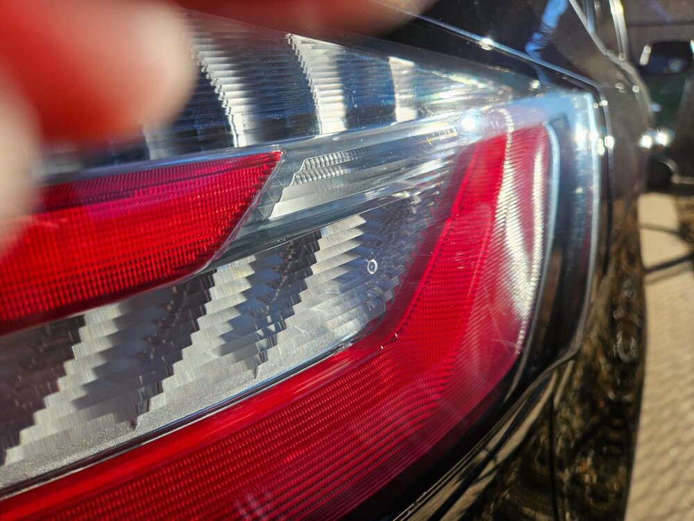

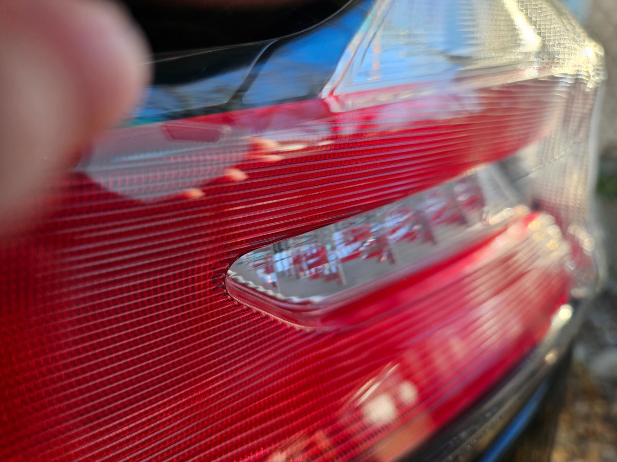

Will2U Posted February 3 Report Share Posted February 3 18 hours ago, Edgingage said: Hi Will2U, could you please mind to post a couple of pictures showing the location where the factory holes were drilled? TIA I hope these help. The holes are smack dab in the middle of each lens. There is one hole in each lamp unit. I've included a contour shot since I don't know if Ford modified it when they added the holes. They aren't noticeable unless you look for them. Just large enough for air flow. 1 1 1 Quote Link to comment Share on other sites More sharing options...

kruzr1 Posted February 4 Report Share Posted February 4 I believe those marks are from the manufacturing process. They are not holes, does not go all the way thru, at least not on my vehicle. 3 Quote Link to comment Share on other sites More sharing options...
1004ron Posted February 4 Report Share Posted February 4 Agree, if those were holes, you'd have an issue going through a car wash - drain holes are typically at a low point and protected against water jets. 2 Quote Link to comment Share on other sites More sharing options...

Wubster100 Posted February 16 Author Report Share Posted February 16 I looked at mine, and they don't seem like holes. 1 Quote Link to comment Share on other sites More sharing options...
Will2U Posted February 17 Report Share Posted February 17 22 hours ago, 1004ron said: @Will2U Have you confirmed that those are in fact holes ? 🙄 Well, I'll be damned. They are dimples. Have I just be lucky to not get condensation? 1 2 Quote Link to comment Share on other sites More sharing options...
