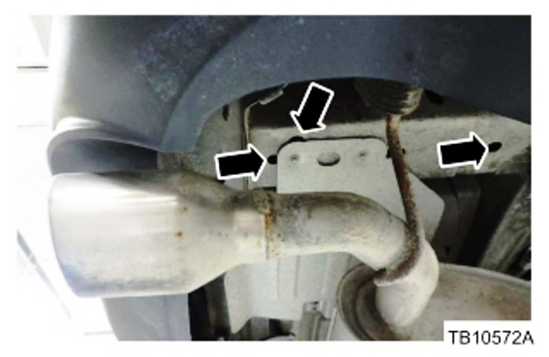

From your earlier research, you may be recalling the following Technical Service Bulletin (TSB), which is Ford's recommended Service action when the described symptoms are present, in this case, when the Climate Control system is set to Recirculation Mode...
TSB 14-0201
EXHAUST SULFUR ODOR AFTER HARD ACCELERATION - CLIMATE CONTROL IN RECIRCULATION MODE ONLY
Publication Date: October 28, 2014
FORD: 2011-2014 Edge
LINCOLN: 2011-2015 MKX
ISSUE:
Some 2011-2014 Edge and 2011-2015 MKX vehicles may exhibit an exhaust odor in the vehicle while the climate control system is in recirculation mode only. This may be more noticeable after hard acceleration, driving in hilly conditions and/or towing a trailer. Customers may indicate the odor smells like sulfur.
ACTION:
Follow the Service Procedure steps to correct the condition.

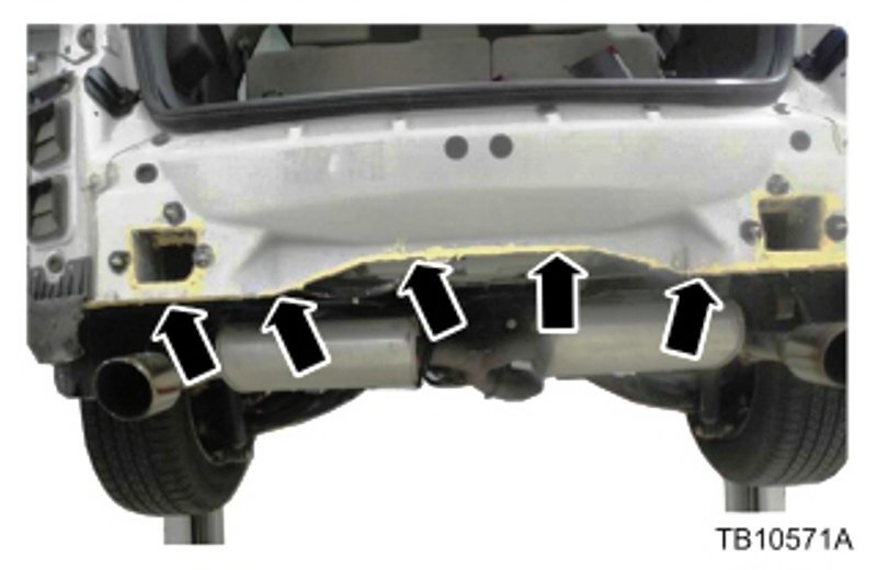

SERVICE PROCEDURE

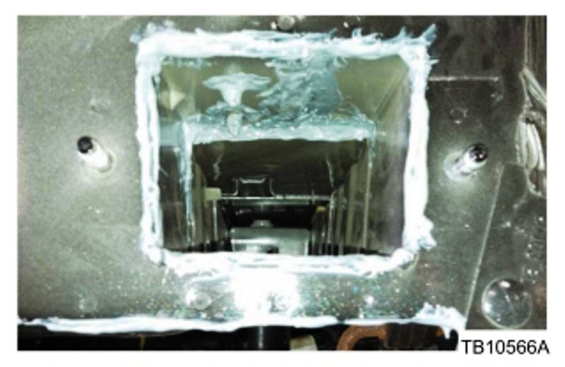

  1. Remove the rear bumper. Refer to Workshop Manual (WSM), Section 501-19.
  1. Replace the four (4) air extractors.
  1. Lower and support the rear section of the exhaust system.

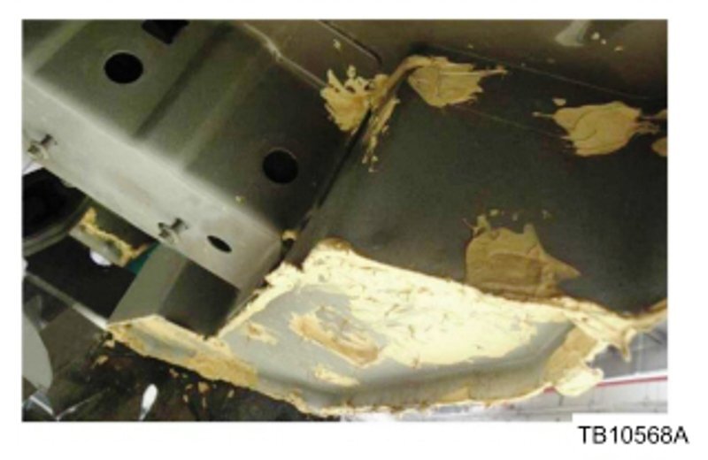

  1. Clean the areas on the underside of vehicle where seam sealer and expandable foam will be applied. (Figures 1-6)
  1. Cover the exhaust system.
  1. Apply a generous amount of Motorcraft® Seam Sealer to the rear horizontal sheet metal lap joints on the left and right sides of the vehicle and the rear sheet metal overlap flange across the rear of the vehicle. (Figures 1-6)
    Figure 1 - 14-0201
    Figure 2 - 14-0201
    Figure 3 - 14-0201
    Figure 4 - 14-0201
    Figure 5 - 14-0201
    Figure 6 - 14-0201
    Figure 7 - 14-0201

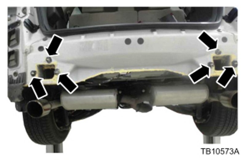

  1. Fill crush cans with Lord Fusor 130 or 3M 08458 expandable foam. Follow the instructions on the can for application. (Figure 7)
  1. Install foam from the Rotunda Squeak and Rattle Repair Kit (164-R4901) around the bumper beam attachment studs. (Figure 😎
    Figure 8 - 14-0201
    1. Some vehicle configurations may have unused bumper attachment studs on each side of the vehicle. Apply Motorcraft Seam Sealer around unused studs. (Figure 😎
  1. Reinstall the rear exhaust system.
  1. Reinstall the rear bumper cover. Refer to WSM, Section 501-19.
  1. Reprogram the heating ventilation air conditioning (HVAC) module to the latest calibration using IDS release 92.04 or higher. Make sure you are connected to the internet when entering module programming to obtain the latest updates. Calibration files may also be obtained at www.motorcraftservice.com.

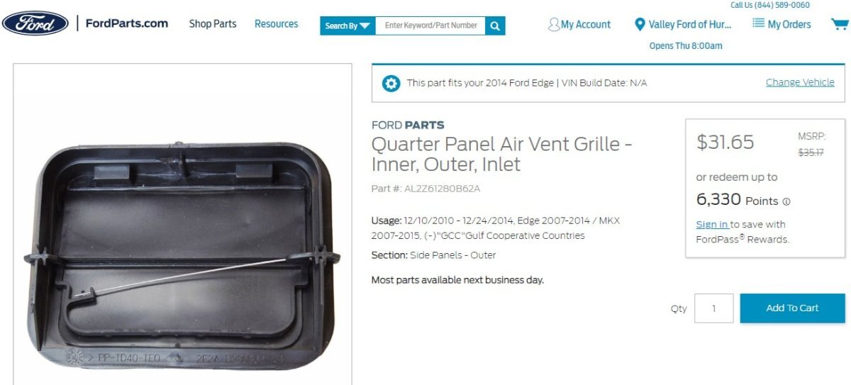

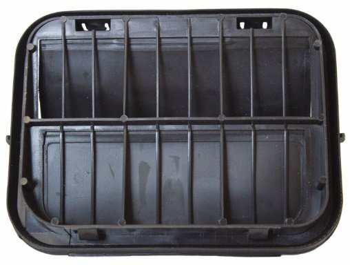

QuarterPanelAirVentGrille-AL2Z61280B62A-FordParts_com.thumb.jpg.868b1d2b1b93f40c42d208f85f876d73.jpg
QuarterPanelAirVentGrille-AL2Z61280B62A-Inner-SideView-FordParts_com.jpg.7ea10a6e00556d63e34fba7a3a0bc25e.jpg

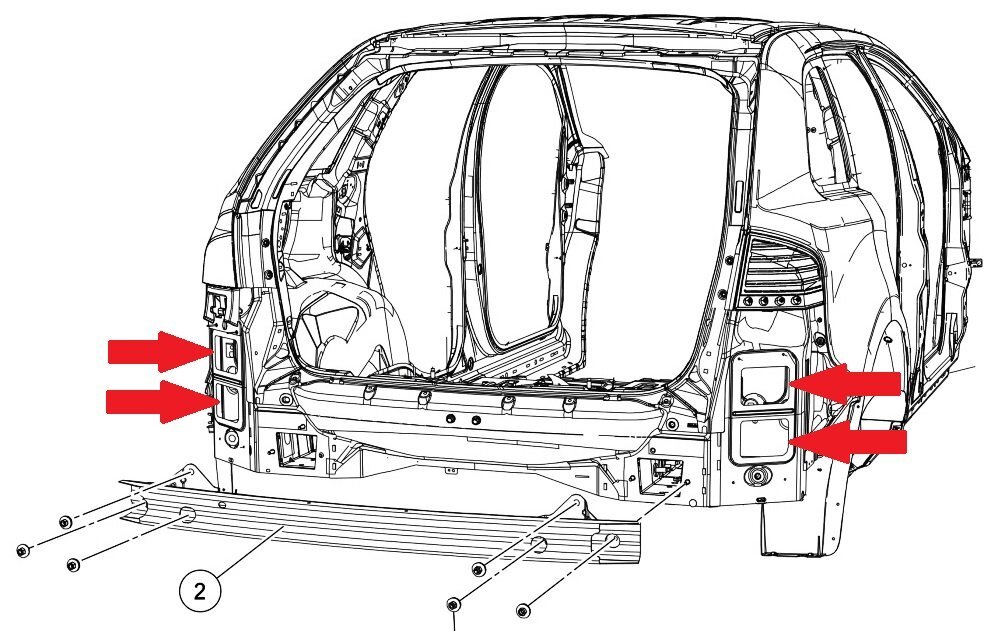

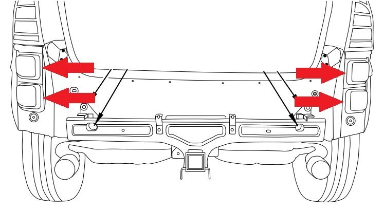

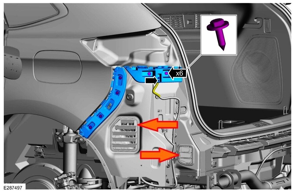

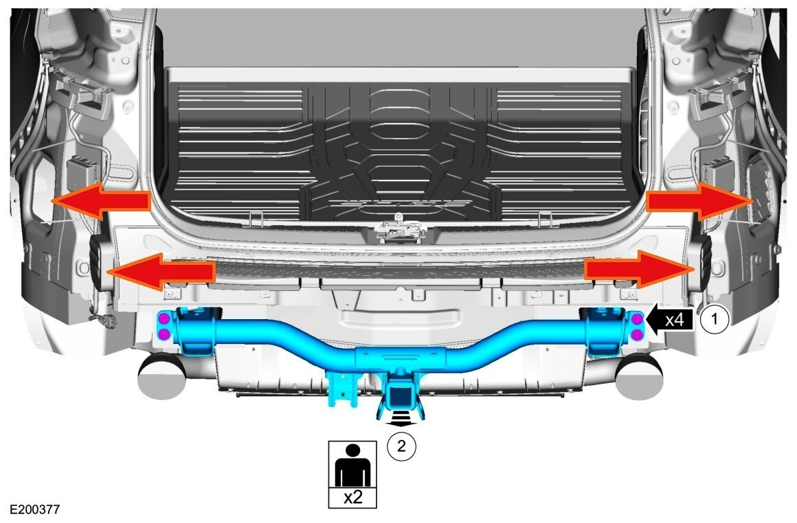

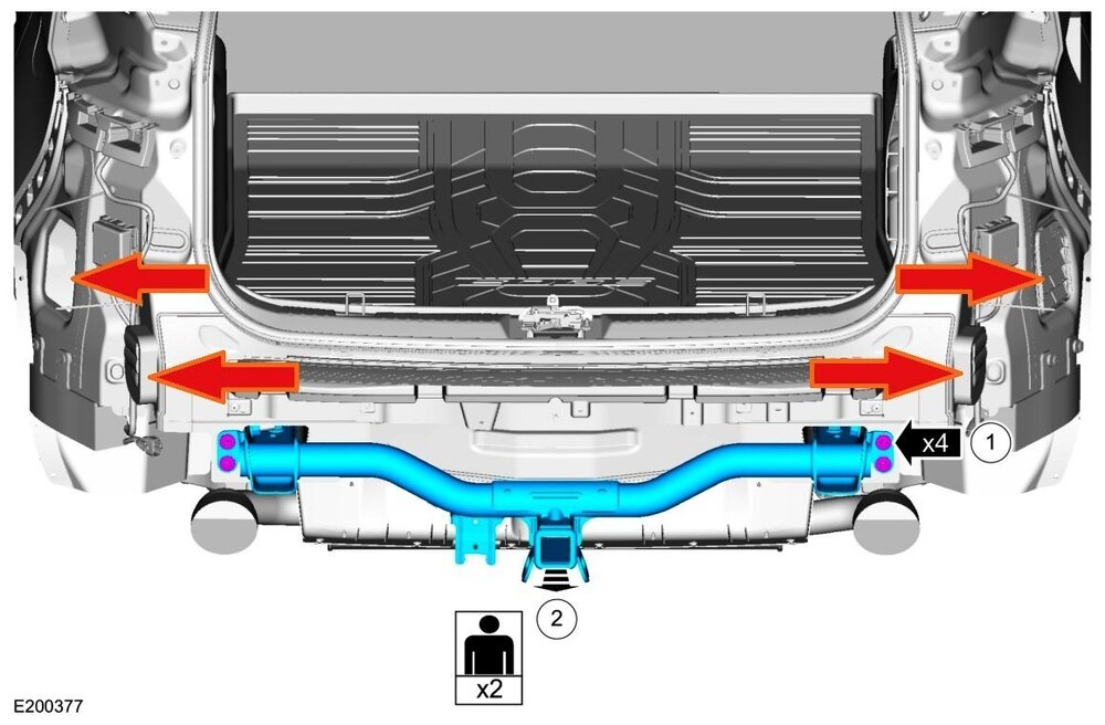

The followed red-arrowed illustrations depict the installed Air Vent Grilles and the Rear Quarter body openings into which they snap-fit...
IllustrationofEdgewithrearbumpercoverremovedredarrowspointtoAirVentGrilles.jpg.ced768de8c4d174926af6e7f9b0382de.jpg
RearBumperCoverremovedwithexplodedviewofBumperred-arrowedAirVentGrillebodyopenings.jpg.b67d14337c367f91a339927fee93f203.jpg
If you are not inclined to personally undertake this repair, your dealer should be able to provide a firm cost-estimate, based upon the TSB's Parts list and 1.8 hours of Labor charge.

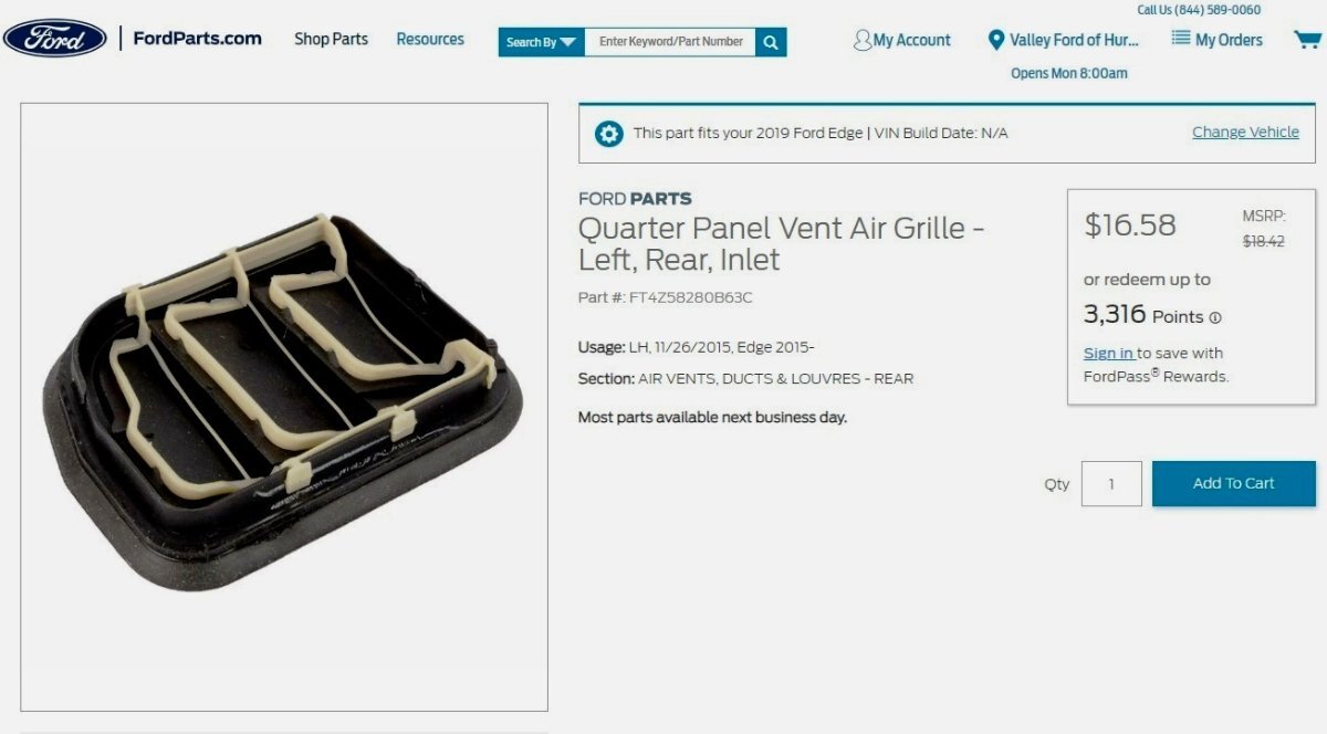

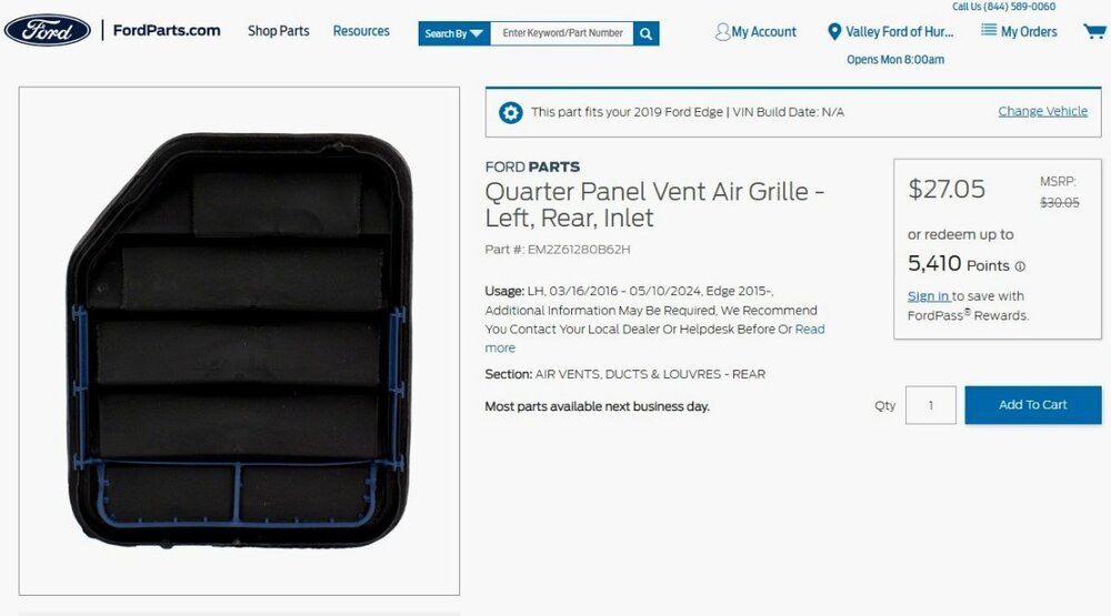

There is no comparable TSB for 2019 Edge, though your Edge has similar Quarter Panel Air Vent Grilles...
RearQuarterAirVentGrilles(4)-HighlightedbyArrows-2019EdgeWorkshopManual.thumb.jpg.70d85cd4e02b68a7d1b8563b35bee430.jpg
RearQuarterAirVentGrilles--LeftSide(2)-HighlightedbyArrows-2019EdgeWorkshopManual.thumb.jpg.1f478c42251f4009f570287f86c087d4.jpg
Link to this FordParts webpageLink to Right Hand version of this grille;
QuarterPanelVentAirGrilleLeftSide-EM2Z61280B62H-FordParts_com.thumb.jpg.718d3884bc5f1a62647f99fc9685207d.jpg
QuarterPanelVentAirGrilleLeftSide-FT4Z58280B63C-FordParts_com.thumb.jpg.40106fd7b9c2ebe30b3f22eae8164832.jpg
The TSB mentions how Ford Warranty/Extended Service Plan (ESP) coverage is determined...
  On 8/29/2024 at 12:27 AM, Haz said:
Warranty/ESP coverage limits are determined by the identified causal part and verified using the OASIS part coverage tool.
Expand
When you take your Edge to the dealership, make sure you have the Service Advisor ride with you so that he/she first-hand experiences the exhaust odor and acceleration characteristics that produce the symptom, and perhaps take a copy of TSB 14-0201 with you. While the TSB is not directly applicable to your 2019 Edge, it does specify replacement of the Vent Air Grilles as a partial solution of the symptom.
Additionally, the Service Advisor should be able to promptly determine if those replacement parts would be covered under your ESP contract.
I expect the Service technician might remove the rear quarter interior trim, and then duplicate the vehicle acceleration with an assistant adjacent to the vent(s), to see if the odor can be localized to the vent(s).
And as previously mentioned , changing fuel brands may affect the degree of rotten-egg odor -- for better or for worse.
Good luck!
