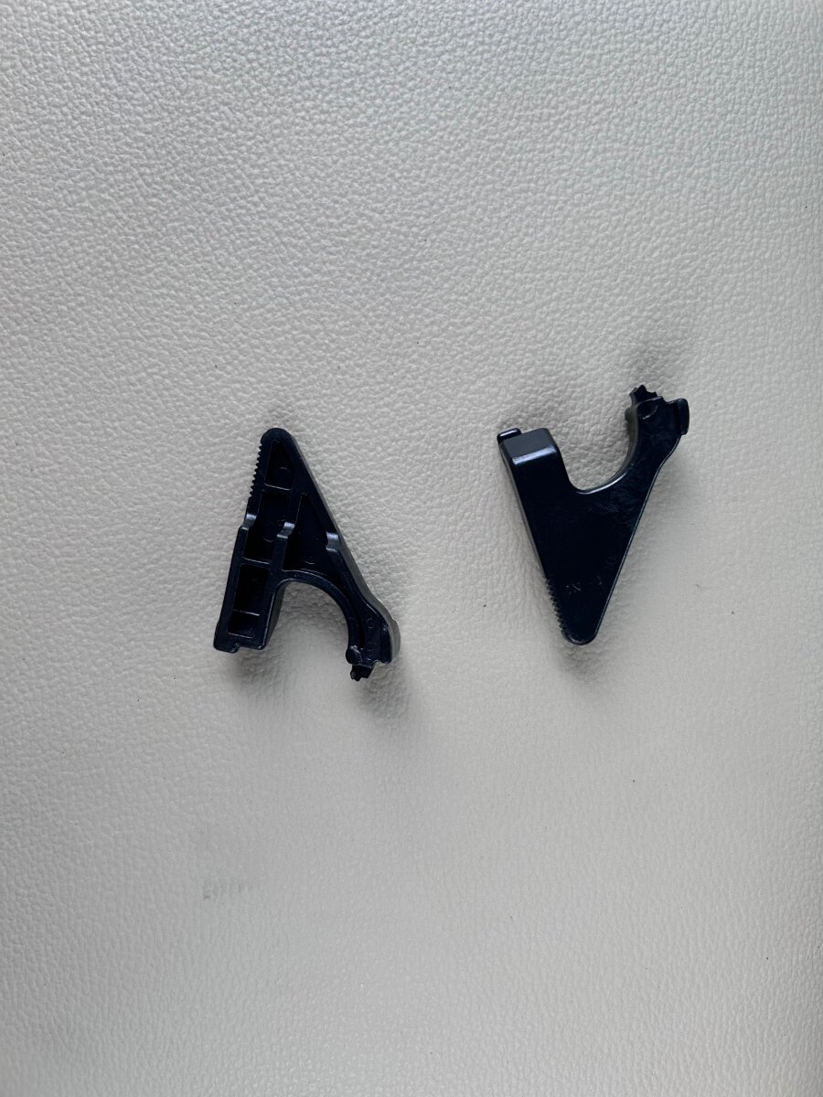

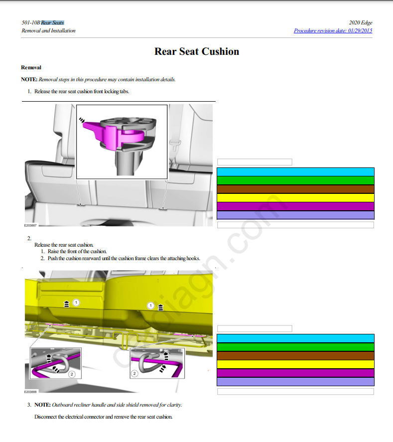

One of my passengers lost their airpod inside of the rear seat cushion where the seat belt latch is. We were able to remove the locking tab and lift the rear seat cushion up. Now, the rear seats are loose and I can't figure out how to lock them in place again.
