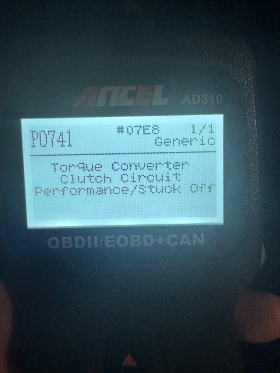

dabangsta Posted August 14, 2024 Report Share Posted August 14, 2024 2 hours ago, mrjhansc said: Most recently I used an ANCEL AD310 OBDII/EOBD+CAN scanner. I ran through it several cycles, no codes in the queue and nothing pulls up under new codes. Not even a check engine light or the dreaded wrench light. I think it only does OBD-II codes, and not PCM or other modules. I used one like it, Torque on my cell phone, but not until I used Forscan on a laptop did I get the maturing/pending codes or eventually the ones that set the powertrain fault. Mine went from slightly jerky (like the TSB...under 35 mph, I was setting up an appointment to get it programmed, if it met the criteria, on my own dime) to a whole slew of various solenoid and friction codes, some are E which is used for 5-8th, some are the frctions used for other gears, and that is how it was behaving, freewheeling above 4th gear unless I slowed down. The p0771 from OBD-II was the only one I ever saw on just a code reader (it was 110 degrees outside and I was dying so I just took camera shots of the screen): 1 1 Quote Link to comment Share on other sites More sharing options...

mrjhansc Posted August 26, 2024 Author Report Share Posted August 26, 2024 Finally got a code to pop up… looks like the torque converter clutch selonoid. from what I’m discovering, there’s been a lot of issues with this in 2019-2021 models. Anyone else have the staggering and jerking issue resolved with this replacement? Quote Link to comment Share on other sites More sharing options...
