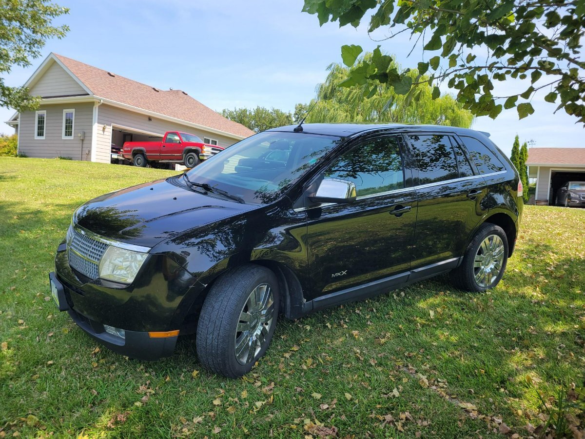

ebodell67 Posted August 13, 2024 Report Share Posted August 13, 2024 Wanted to document my low buck build on the Lincoln MKX I recently picked up. I little backstory on how I came to acquire my latest project. One of my co-workers recently bought a new Ford Maverick and just wanted the MKX gone. I half joking asked him what he wanted for it. He said $200 and it's yours. So now I am the owner of a rather well used MKX. The car has 260K miles on it and are mostly highway miles as a work commuter. He has done a lot of maintenance over the ~8 years he owned the car. New CVs, PTU, struts, etc. He also did the oil every 3K miles. So it runs and shifts just fine and the motor is clean with good compression. Of course it has some issues; AC has a leak, oil light is on, front seats no longer heat, a very loud banging from the suspension. The first thing I did was detail the entire car. I know this is backwards but I am more motivated to work on a clean vehicle. I attached a shot of the car as I brought it home and then some shots after I cleaned it up. I extracted a fair bit of dirt from the carpets but overall it cleaned up very well. There is a missing CD unit on the passengers headrest (not sure what to do here, I may 3D print a little storage box or build a wood box of some sort. I have now started the mechanical work. I changed the oil and replaced the oil pressure switch (replacement was included in the sale). The switch was a bit tight and took about an hour but after I got it in the light went out and stayed out (it would go out after the car ran for a bit so I assumed it was a bad switch). Next I took a look underneath to find the banging issue. I have the three-piece driveshaft with two carrier bearings. Both bearings are shelled out with one of them completely gone and acting as a driveshaft hoop (think NHRA rules). Driveshafts are a bit pricey but I can get the carrier bearings alone for about $50. I did a little digging and I am pretty sure I can separate the driveshaft and rebuild it. I have rebuilt several "unserviceable" components in the past (it helps to have access to a full machine shop). I hope to pull the shaft tonight and get the parts on order for the weekend. After that I will check the wheel bearings (the PO thought at least one of them was bad), then tackle the AC. Overall it seems like a decent car and everything works in it aside from the front heated seats and AC (I will T/S the seats at some point if I keep the car). I am not sure if I am going to keep or flip it when I am done. I am keeping the cost low regardless. This is something I bit newer than I usually work with so the lessons it will teach me are worth the admission price. I am more of a GM guy and I think the sun rises and sets on SBCs and BBCs, but my daily driver is a '92 Grand Marquis that has been stone cold loyal. I don't know much about the MKX/Edge platform but that may change as I get further into this one. So far my costs are: Purchase price: $200 T&L and title: $98 Cleaning supplies (I can use these elsewhere): $24.24 Oil and filter (Supertech 5W-20 and a Napa Gold filter): $37.91 Quart of 75W-140 (for the PTU): $16.56 So at this point I am all in for $377. Will see where we go from here. 1 1 Quote Link to comment Share on other sites More sharing options...
1004ron Posted August 13, 2024 Report Share Posted August 13, 2024 The appearance is really good, and the interior looks un-used. You sure scored a bargain of a lifetime. 1 Quote Link to comment Share on other sites More sharing options...

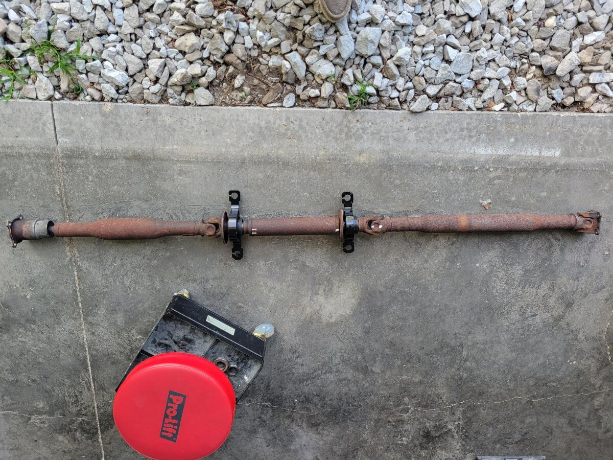

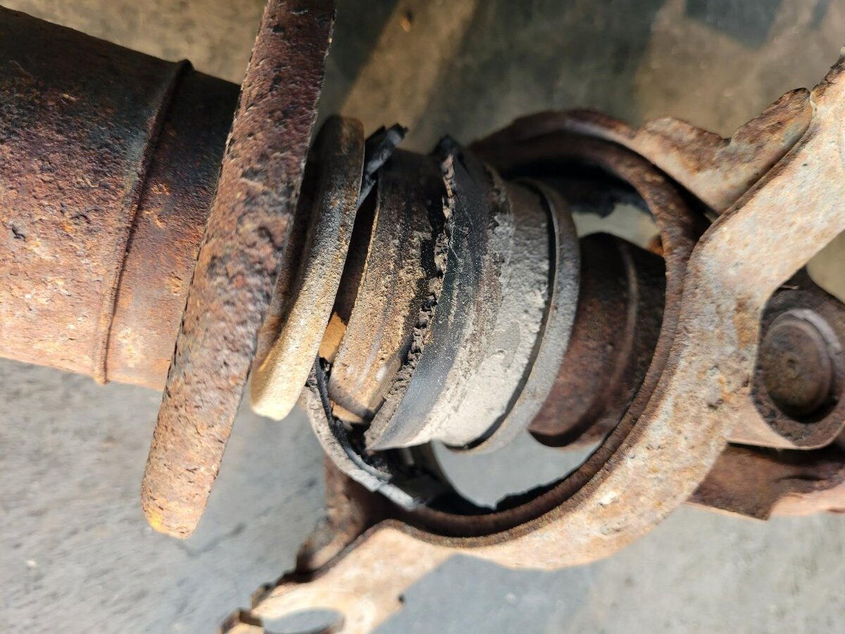

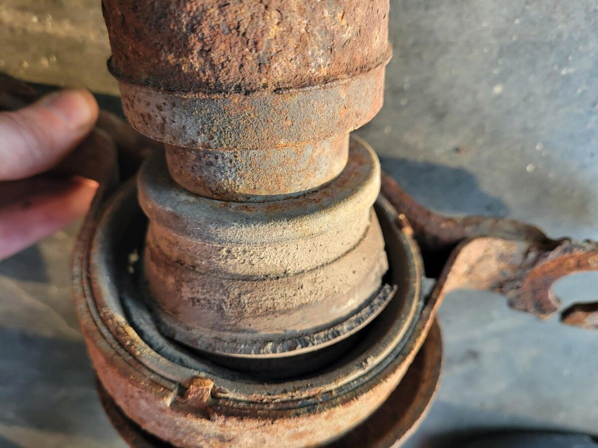

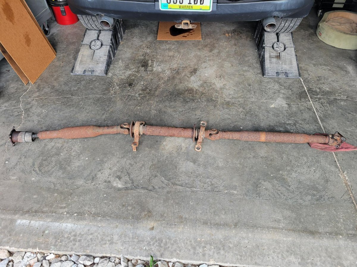

ebodell67 Posted August 14, 2024 Author Report Share Posted August 14, 2024 (edited) Got the driveshaft pulled out last night. All the fasteners came apart fine (I sprayed them with Free All on Saturday). Might not be the only drivetrain problem but the carrier bearings are shelled out for sure. I will see tonight how to pull the shaft apart. Edited August 14, 2024 by ebodell67 spelling 1 Quote Link to comment Share on other sites More sharing options...

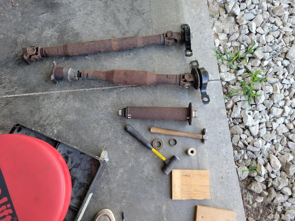

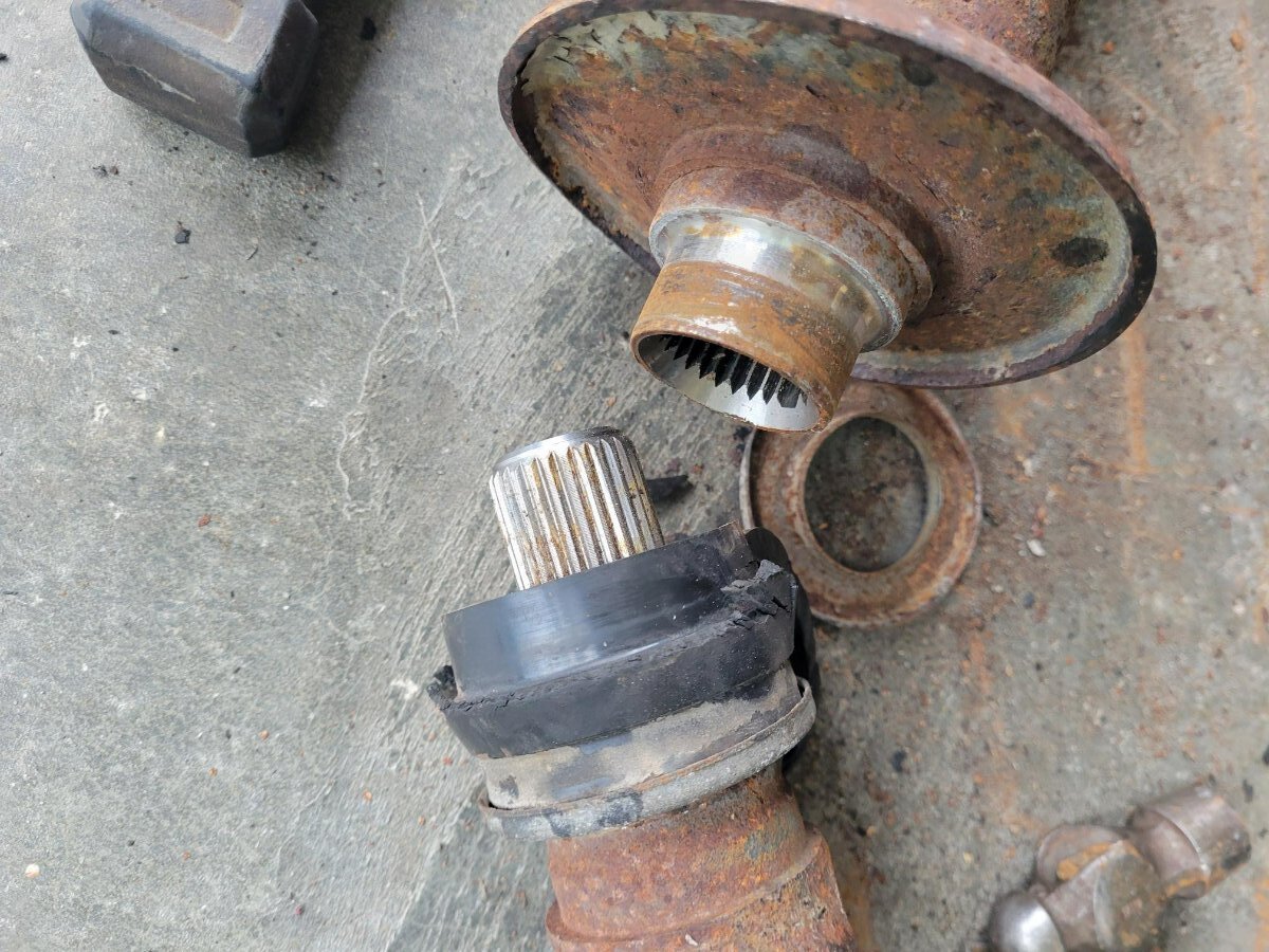

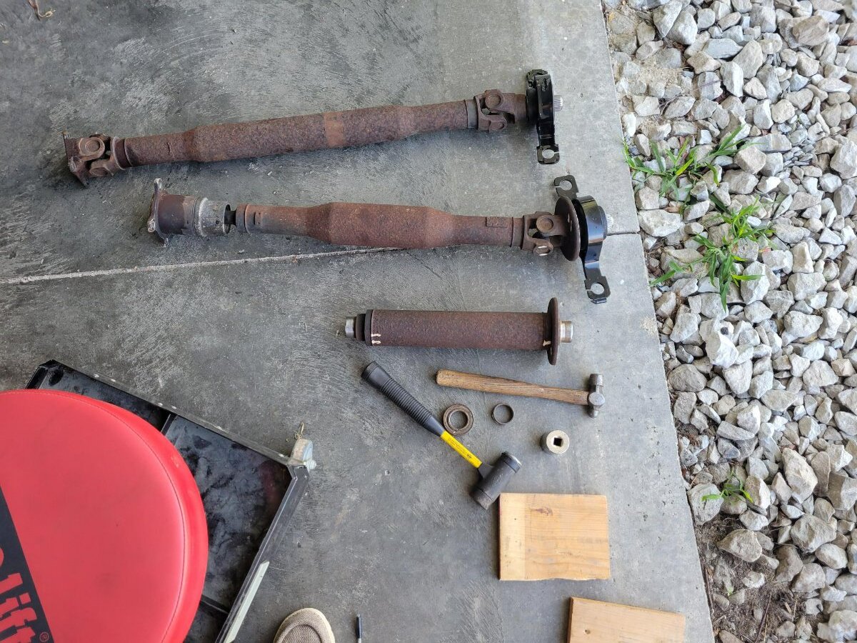

ebodell67 Posted August 15, 2024 Author Report Share Posted August 15, 2024 Last night I got part of the shaft separated. There is a splined connection on the center shaft that I was able to get apart. Took some heat and a deadblow but it finally broke free. Should be something similar on the opposite end but I ran out of time last night so I sprayed it with Free All and will try again tonight. At least I am making progress. Hopefully I will have it back together this weekend. I have two other automotive projects I am working on in parallel and have some chores at the farm to do so we will see. Quote Link to comment Share on other sites More sharing options...
1004ron Posted August 15, 2024 Report Share Posted August 15, 2024 (edited) I just replaced the front driveshaft on my wife's BMW X5. BMW X5 and X6 Forum (F15/F16) - View Single Post - Front driveshaft? (bimmerpost.com) Be sure to use a good molybdenum spline lube/grease when you re-install the driveshafts. Amazon.com: Liqui Moly Long-Life Grease + MoS2 | 100 g | Lithium Fat | SKU: 2003 : Automotive Edited August 15, 2024 by 1004ron 1 Quote Link to comment Share on other sites More sharing options...

ebodell67 Posted August 19, 2024 Author Report Share Posted August 19, 2024 Got the other splined joint apart this week and pressed the new carrier bearings on and the shaft back together. Second joint fought me a lot more than the first one did but it finally came apart. I used a big socket and one of the old bearings to press the new carriers on. Installation was pretty straightforward as well. Took the car out for a test drive and it drives good with no vibration. There is still a rattle coming from somewhere but the loud banging is gone. Next up is the AC. I also forgot that the third brake light is not working. Took that apart (had to drill out one of the screws) and found the connection is pretty much shot. Replacements are $50 so I am just going to directly wire it in to keep the costs low (kinda the theme of this build anyway). The new carrier bearings were $50.28 delivered to my door. So that makes a grand total of ~$427 into this one to date. The AC may cost me a few $ depending upon what I find. I hope it's not the evaporator core as I do not want to tear the dash out (but I will if I have to). AC parts seem reasonable so at least that is a positive. I will get a vacuum pump on the system and put some nitrogen and dye in it to find the leak. So far the repairs have not been to crazy and it has not fought me as much as I thought. It is actually pretty clean underneath as it has not been on much gravel in it's life. About ready get it insured so I can do more than just yard drive it. 2 Quote Link to comment Share on other sites More sharing options...

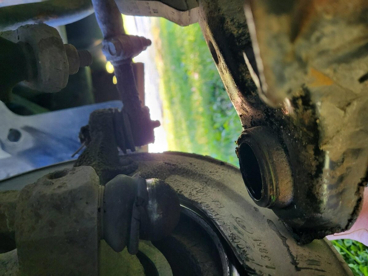

ebodell67 Posted October 28, 2024 Author Report Share Posted October 28, 2024 Got the torque mount changed out. Vibration seems to be gone and the car seems quieter now. I did tighten a couple items under it as well to eliminate some of the clunks that it has. I also noticed that about every bushing in the rear end needs changed out. Not sure I am going to tackle that at this point as I don't really want to drop the entire rear end out of it at this point. I may change a few of the "easier" ones though if the parts are reasonable. Torque mount was a bit more than I thought it would be. I should have supported the trans when I first pulled it. Lesson learned. 1 Quote Link to comment Share on other sites More sharing options...
