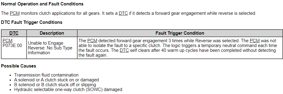

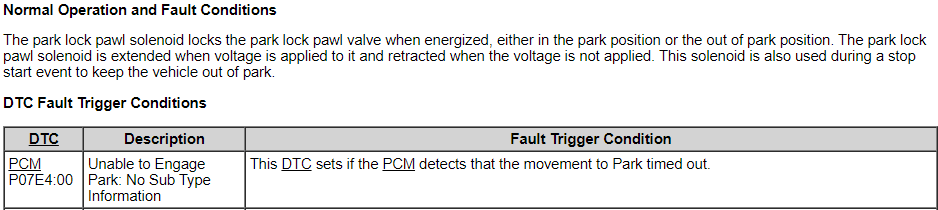

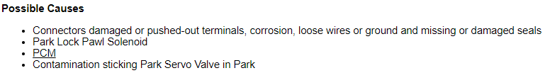

From the 2019 Edge Workshop Manual...
DTC P0771, E clutch Does Not Apply symptom,
REFER to: E Clutch (307-01A Automatic Transmission - 8-Speed Automatic Transmission – 8F35/8F40, Diagnosis and Testing)
If either DTC P0771 or P0772 are set resolve them first. Otherwise, for DTC P2704,
REFER to: E Clutch (307-01A Automatic Transmission - 8-Speed Automatic Transmission – 8F35/8F40, Diagnosis and Testing).
The above-mentioned diagnostic procedures are attached below as PDF documents.
If your efforts progress to you needing electrical circuit & connector detail, I can provide that information.
If you elect to clear the DTCs and the Transmission Adaptive Tables, the Adaptive Learning Drive Cycle procedure is attached below...
Good luck!
E Clutch - Diagnosis and Testing - 8F35-8F40 - 2019 Edge Workshop Manual.pdf E Clutch Description - Exploded View - 8F35-8F40 - 2019 Edge Workshop Manual.pdf Transmission Description - Disassembled Views - 8F35-8F40 - 2019 Edge Workshop Manual.pdf Diagnostic Pinpoint Test I - DTC P07E4 + Others - 8F35-8F40 - 2019 Edge Workshop Manual.pdf Diagnostic Pinpoint Test S - DTC P073E - 8F35-8F40 - 2019 Edge Workshop Manual.pdf Adaptive Learning Drive Cycle - 8F35-8F40 - General Procedures - 2019 Edge Workshop Manual.pdf
