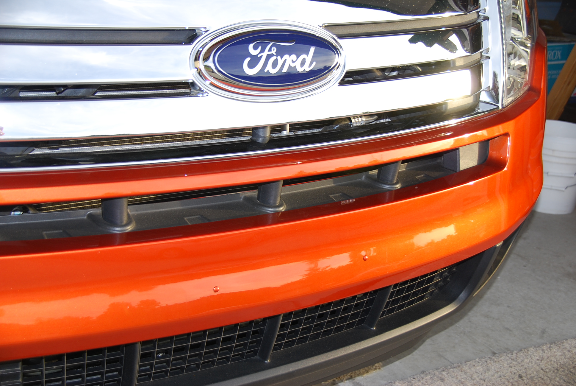

Edge184 Posted March 13, 2009 Author Report Share Posted March 13, 2009 (edited) License plate frame is off and the plugs fit perfectly. Not bad for three bucks. Edited March 13, 2009 by Edge184 Quote Link to comment Share on other sites More sharing options...
dadrett Posted March 20, 2009 Report Share Posted March 20, 2009 (edited) This may seem redundant but here’s more. Drill out rivet “head” with ½” drill. The bit cuts away aluminum without enlarging hole in bumper & inside part of rivet falls into bumper. You’re left with ¼” holes that can be plugged or, if U’ve got the budget to do it right, by filling & painting. I used a ¼” black nylon plug [servalite #1180-B] with a 5/16” head. I’m guessing this plug is smaller that those mentioned above. I could not find this plug on the Internet, but if U Goggle "nylon hole plug" one site will be HarmonCorp. They call it a dome plug. I used black with a sort of pebbly surface (matte-finish.) Use as is or paint with U'r body color touch-up. Because some plastics don’t take paint well it’s probably best to rough up surface with sandpaper to give the paint some purchase. Even though sanded, U should also clean surface with acetone or lacquer thinner due to oily film left after molding. 3/22/09: Just stumbled onto these today at Lowe’s - their #139449 (Hillman #881275) for 1/4" black dome plugs. Edited March 1, 2010 by dadrett Quote Link to comment Share on other sites More sharing options...

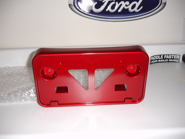

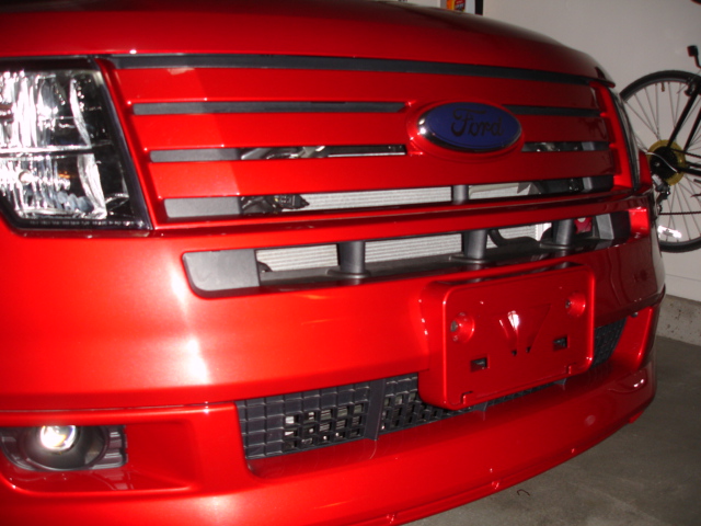

dwtc Posted December 2, 2009 Report Share Posted December 2, 2009 The license plate frame was already on the Edge when I got it :angry: , I took it off and was going to use plugs for the holes, I don't know what they did when the drilled the holes in the cover but the cover was a mess under there, I figured I would have to leave the license frame on the bumper so I had it painted to match Quote Link to comment Share on other sites More sharing options...
