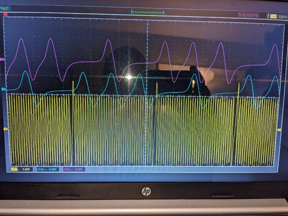

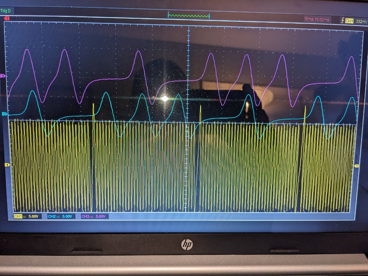

Dinocappy Posted July 19, 2024 Report Share Posted July 19, 2024 Own 2010 ford edge Limited, have bunch of cam sensor errors. Replaced both sensors still same errors. Down bellow is both cam sensor signals and crank shaft signal. 1 Quote Link to comment Share on other sites More sharing options...

Dinocappy Posted July 30, 2024 Author Report Share Posted July 30, 2024 Replaced timing chain and issue is gonne, so what you seein the picture is both camshafts over advanced and not timed with crank. After chain replacment all is good. All other parts remained on car. Quote Link to comment Share on other sites More sharing options...
