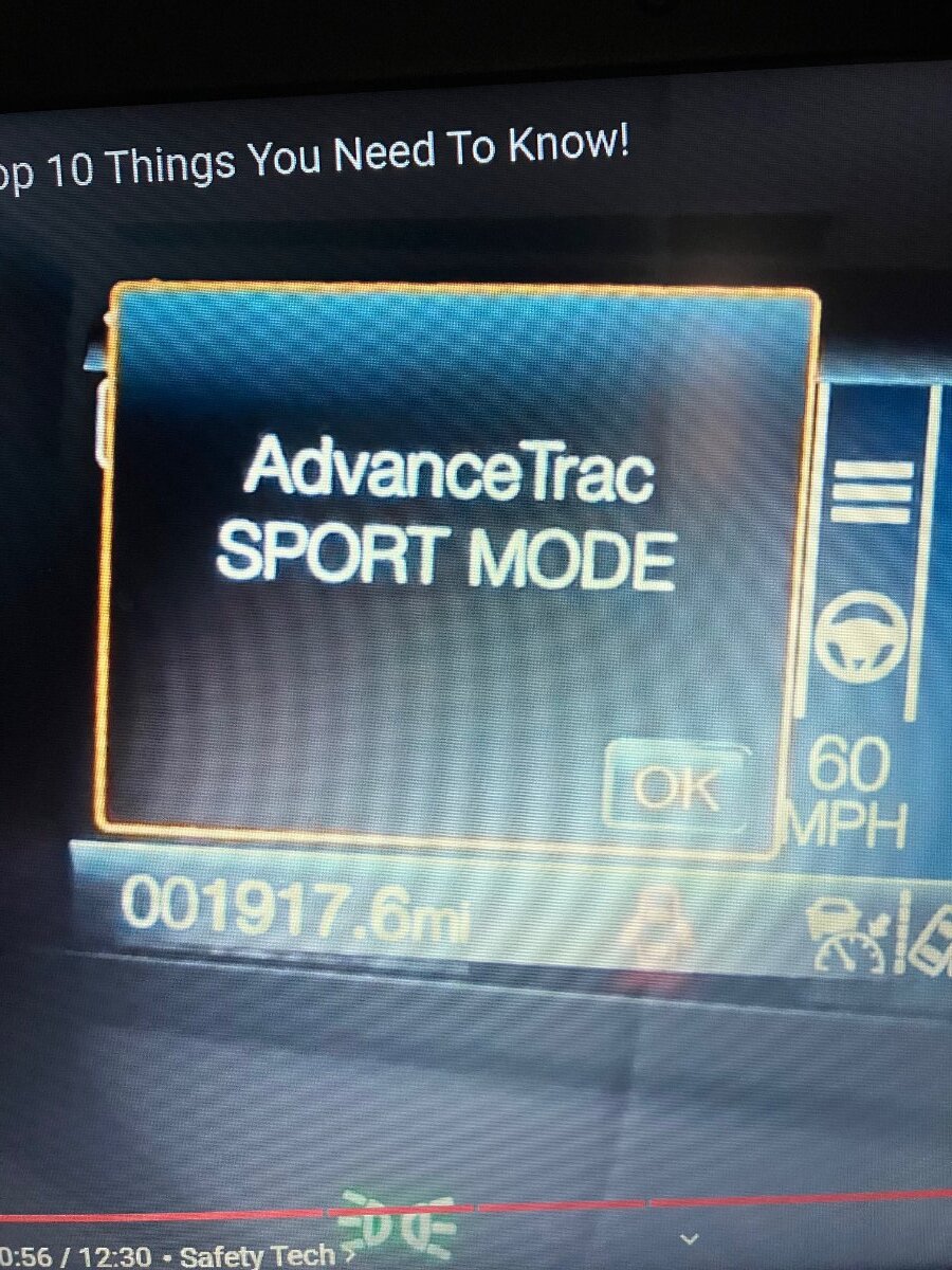

STBEAST Posted July 17, 2024 Report Share Posted July 17, 2024 (edited) I saw a video showing how when you 'double tap' the ESC button on a 2019-2024 Edge ST (and possibly even the other models), it puts the Advancetrac into Sport Mode. A totally separate feature than pushing the sport mode (S button) on the rotary shift dial. There is not much information on this feature (none in the owner's manual), but it seems to have a notable effect on engaging the AWD, making it much more active. I monitored the AWD screen while trying out this 'hidden' mode and could see a difference throughout the driving range. It seems this mode would be very beneficial during inclement weather and off pavement. I have played with it quite a bit and I believe many Edge St owners don't even know it Exists. It may have been mentioned in previous topics, but sometimes searching for a topic on this forum can be a challenge. Hope some of you get to read this valuable info. and wonder if this feature applies to the 2.0 Edge 2019+. Happy Easter egg! Edited July 17, 2024 by STBEAST 2 Quote Link to comment Share on other sites More sharing options...

STBEAST Posted July 18, 2024 Author Report Share Posted July 18, 2024 Thanks for that information. But I do notice the AWD system (via the AWD screen) being much more active when in this mode. It becomes less front wheel drive biased when in sport mode and activates the AWD at a much lower threshold. Any explanation of this would be helpful. 1 Quote Link to comment Share on other sites More sharing options...
Haz Posted July 18, 2024 Report Share Posted July 18, 2024 (edited) It's in the software -- "all-wheel-drive calibration for balanced front and rear torque distribution" -- as shared in your January 2024 discussion on this same topic... Good luck! Edited July 19, 2024 by Haz 2 Quote Link to comment Share on other sites More sharing options...
