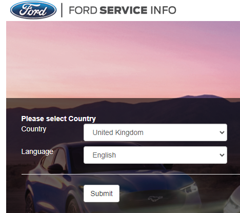

Haz Posted July 11, 2024 Report Share Posted July 11, 2024 The U.K. Ford Owner Support website provides Service and Oil Change Intervals by submitting the vehicle VIN and current odometer reading. From the above-linked web page... When should I get my car serviced? Service intervals vary by vehicle model and engine type, but are specified in the Service Portfolio supplied with your vehicle and can also be found in our maintenance schedule portal. For further enquiries please contact your local Ford Dealer who is best placed to confirm the exact schedule for your vehicle and also advise of any recall or service actions that may be outstanding on your vehicle. For more information, check our Service & Repair pages. If you've already found that information lacking, hopefully, your dealer Service Department can provide you a Scheduled Maintenance interval guide. Ford offers subscriptions ($26.34 for 72-hours, $341.20 for 30-days, $2,834.95 for 1-year) for online access to the following information... It's worth noting that indicating the United Kingdom as your country on the initial landing page eliminates the subscription offer... As an alternative, attached below and in an immediately following post as PDF documents are U.K. procedures for the fluid maintenance you look forward to performing on your 2018 AWD 2.0L EcoBlue 6-Speed PowerShift Edge... Oil Pan - Removal and Installation - 2.0L EcoBlue Diesel - 2015-2022 Edge Workshop Manual - U.K Edition.pdf Engine - System Operation and Component Description - 2.0L EcoBlue Diesel - 2015-2022 Edge Workshop Manual - U.K Edition.pdf Power Transfer Unit - Overview - 2.0L EcoBlue Diesel - 2015-2022 Edge Workshop Manual - U.K Edition.pdf Engine Cooling System - Specifications - 2.0L EcoBlue Diesel - 2015-2022 Edge Workshop Manual - U.K Edition.pdf Power Transfer Unit - Fluid Specifications - 2.0L EcoBlue Diesel - 2015-2022 Edge Workshop Manual - U.K Edition.pdf Rear Differential - Fluid Specifications - 2.0L EcoBlue Diesel - 2015-2022 Edge Workshop Manual - U.K Edition.pdf 2 Quote Link to comment Share on other sites More sharing options...
