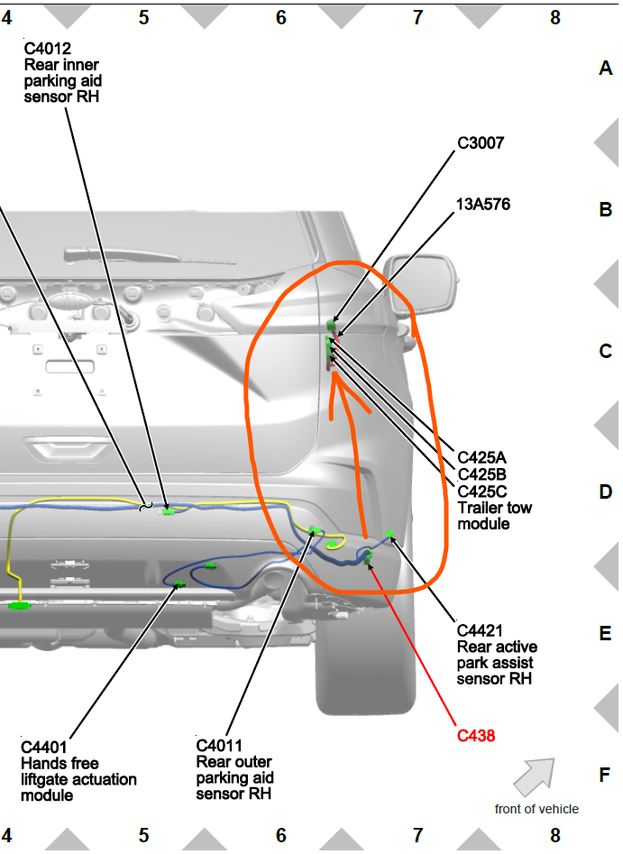

Haz Posted July 9, 2024 Report Share Posted July 9, 2024 Attached... Good luck! Parking Aid Wiring Diagram #1 - 2024 Edge.pdf Parking Aid Wiring Diagram #2 - 2024 Edge.pdf Parking Aid Wiring Diagram #3 - 2024 Edge.pdf Parking Aid Wiring Diagram #4 - 2024 Edge.pdf Parking Aid Wiring Diagram #5 - 2024 Edge.pdf Parking Aid Wiring Diagram #6 - 2024 Edge.pdf Parking Aid Wiring Diagram #7 - 2024 Edge.pdf Parking Aid Wiring Diagram #8 - 2024 Edge.pdf Rear Parking Aid Sensors - Wiring Harness Location - 2024 Edge.pdf Front Parking Aid Sensors - Wiring Harness Location - 2024 Edge.pdf Rear Parking Aid Camera - Wiring Harness Location - 2024 Edge.pdf Front Parking Aid Camera - Wiring Harness Location - 2024 Edge.pdf Rear Parking Aid Sensors - Inline Connector C438 - 2024 Edge.pdf Rear Parking Aid Sensors - Inline Connector C140 - 2024 Edge.pdf Active Park Assist Switch - Connector C3466 Location - 2024 Edge.pdf Active Park Assist Switch - Connector C3466 - 2024 Edge.pdf 2 1 Quote Link to comment Share on other sites More sharing options...

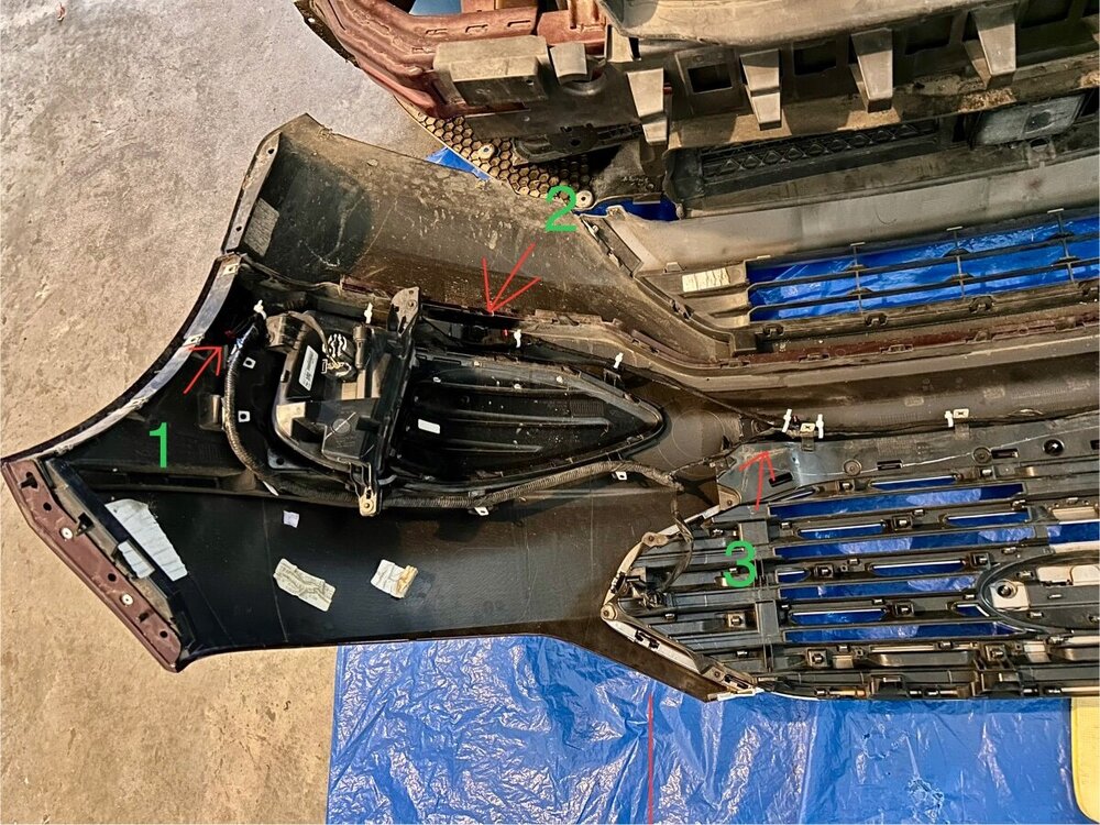

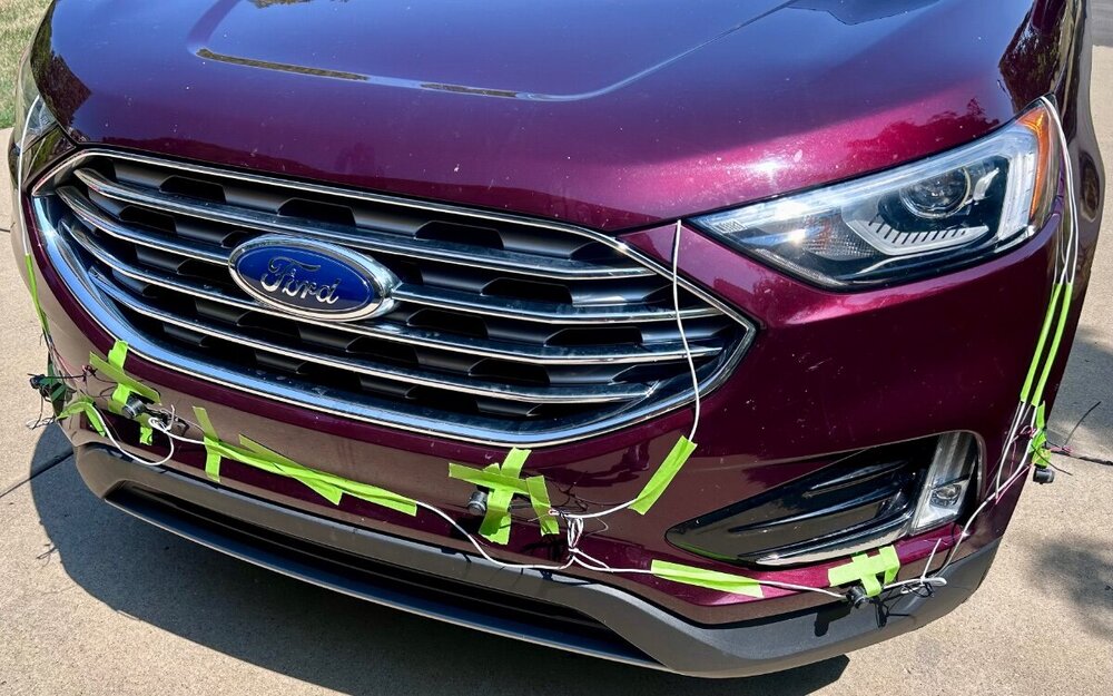

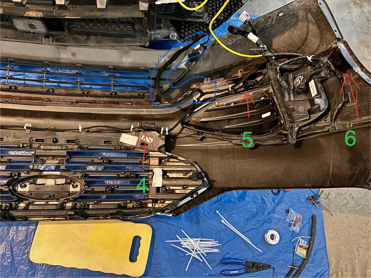

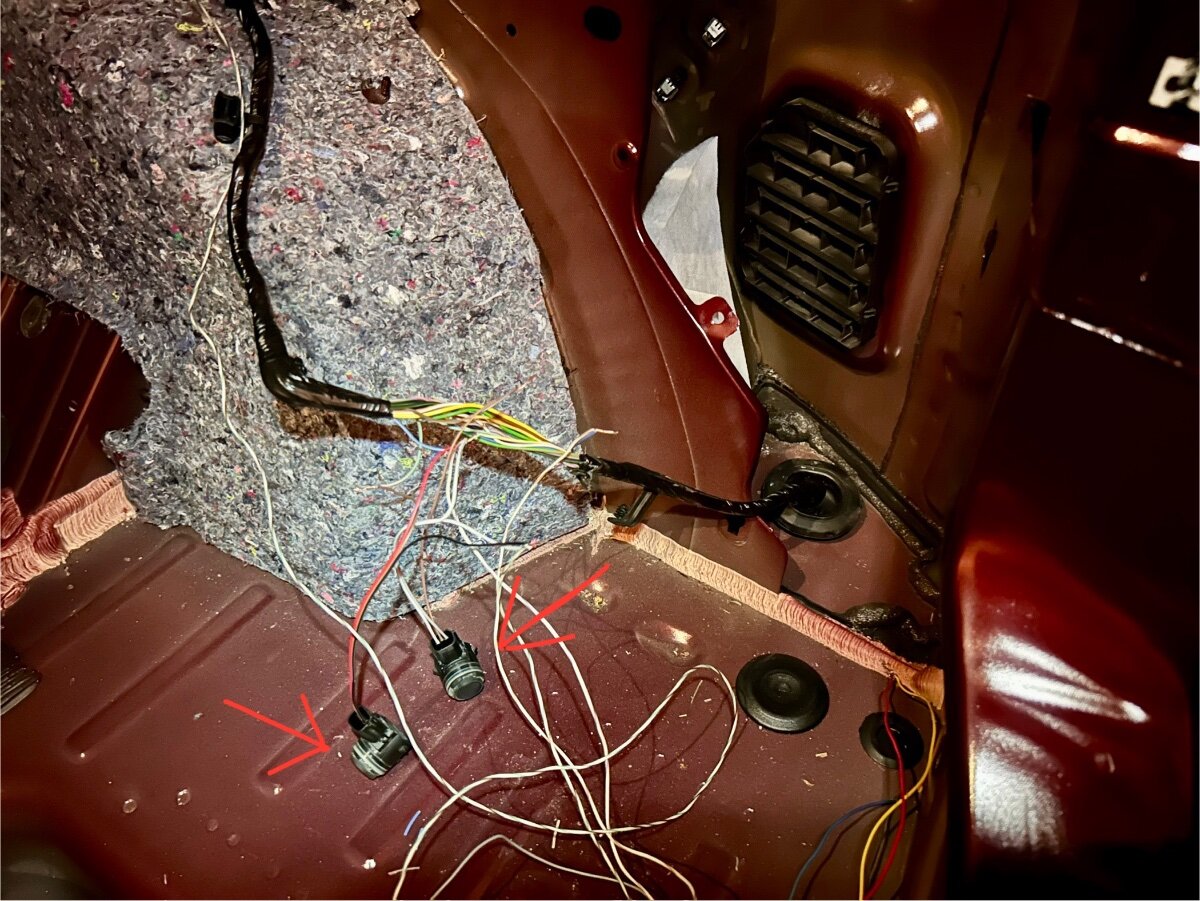

Wubster100 Posted July 24, 2024 Author Report Share Posted July 24, 2024 I checked out some of the connectors on the BCM, and I connected a wire toner. I was able to hear the beeping by the rear parking sensors and by the front bumper. It looks like I have all of the wires I need to add the other parking sensors. I also began creating a temporary wiring harness for the front sensors. 1 Quote Link to comment Share on other sites More sharing options...
Wubster100 Posted July 28, 2024 Author Report Share Posted July 28, 2024 An update, I have all 12 parking sensors connected. 4 Front and 4 rear parking sensors are operational. Still working on the side sensing system. I am not sure if I will try active park assist because I do not have the 2 rear wheel ABS sensors required. Quote Link to comment Share on other sites More sharing options...

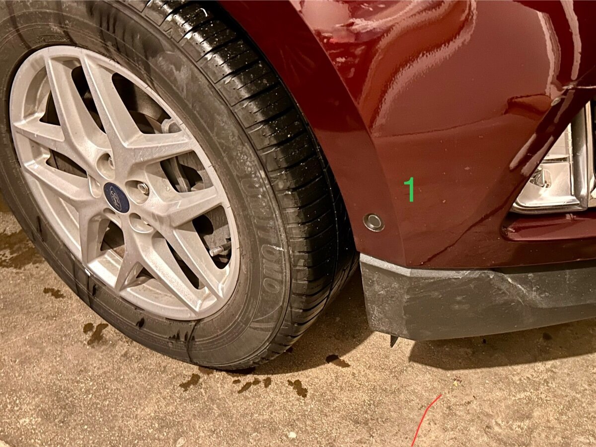

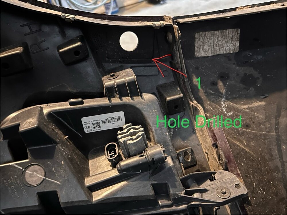

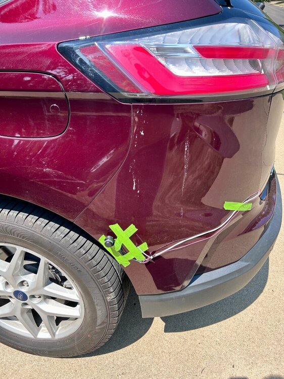

Wubster100 Posted July 28, 2024 Author Report Share Posted July 28, 2024 All 12 parking sensors are operational. Thank you @Haz for providing the requested documents. I have temporarily taped on the additional 8 sensors. I am able to hear the beeping and I get a visual aid on screen. I need to order the brackets that hold the parking sensors in place. It looks like the spots to drill holes already marked with X’s. I may also order the park aid on/off switch if the parking sensors cannot be turned off through software switches. I decided to not complete active park assist at this time because I don’t want to get 2 new rear ABS sensors. I am not sure if I would also need to get the 2 more expensive parking sensors in the front. Right now I am using 8 of the same non-OEM sensors and they are working well. Quote Link to comment Share on other sites More sharing options...
