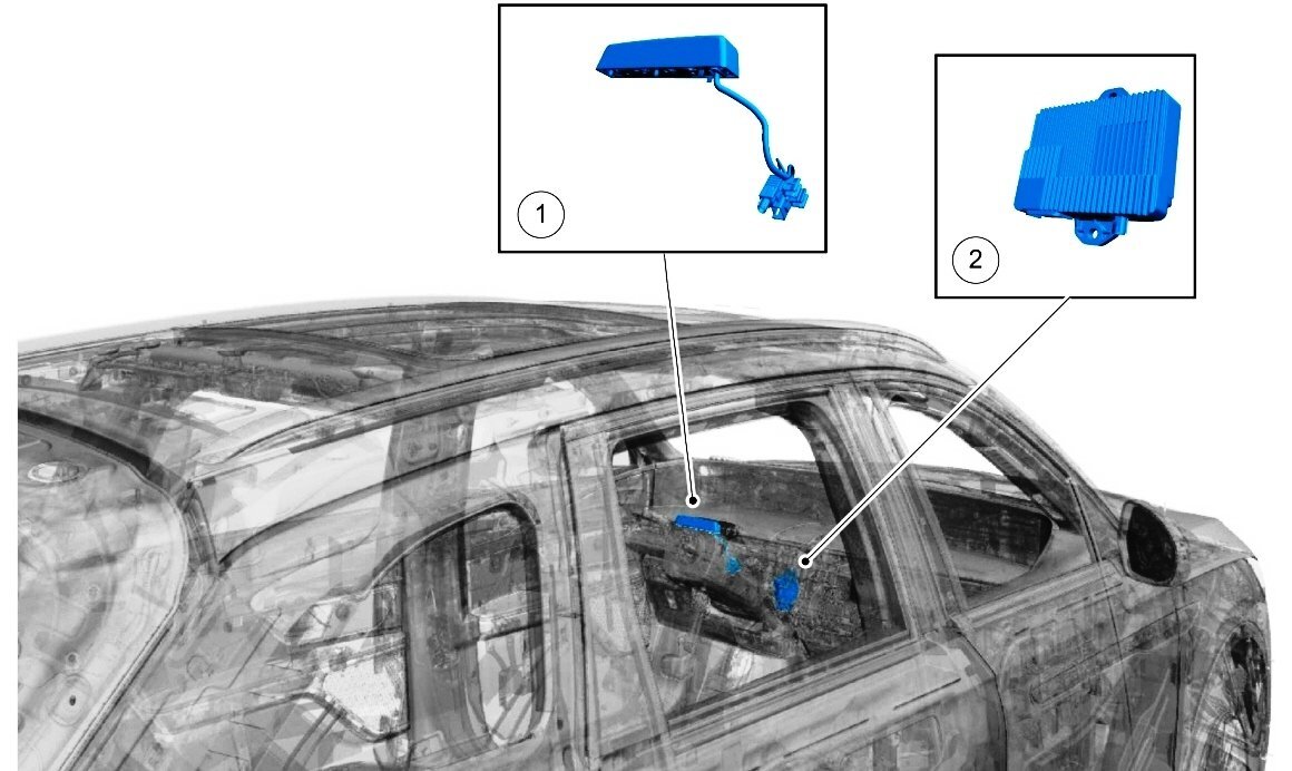

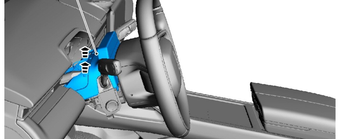

Supplement illustrations from 2024 Nautilus Workshop Manual...
Interior Camera System - Component Locations

DriverStatusMonitorCamera-LocationonSteeringColumnShroud-2024NautilusWorkshopManual.thumb.jpg.057bf4ed457f6c791a65e73dd0ad9818.jpg
